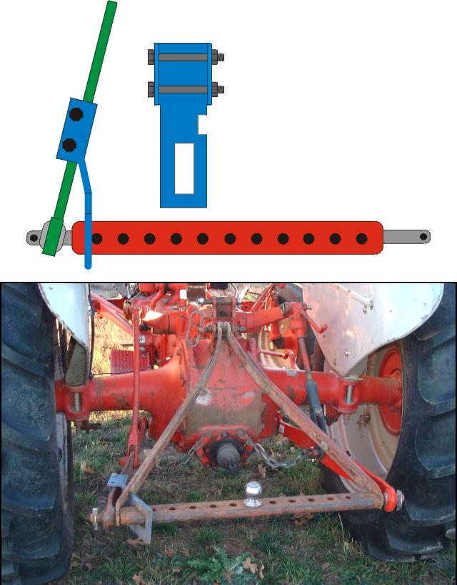

</font><font color="blue" class="small">( can I order the A frame from any dealer or do they have a web order service or ?
Steve )</font>
My local dealer had them in stock.. was 20$ some odd dollars for the 2 uprights, a spacer bushing, and 3 bolts/nuts/washers
I use mine as a trailer tender.. back up to tounge.. lift up.. move trailer.. set down.. etc.. never even get of the tractor..

Here is a drawbar lock and stays installed on my old Jubilee. This is the "safe" setup for being sure the 3PH is fixed in place. Don't forget and try to raise the 3PH with this setup. You'll either pop the relief valve or bend the stays.

If there's anyway you could get a part # for that A-frame parts kit I'd be most greatful...Thanks!

</font><font color="blue" class="small">( forget and try to raise the 3PH with this setup. You'll either pop the relief valve or bend the stays )</font>
Just8n's sells a small chain and medalion and clip that you loop over and clip to the lift quadrant. It prevents the hytrol handle from moving up the quadrant. The medalios has some safety message on it about breaking lift parts if you raise the handle... I understand that it may not be a cheap item.. /forums/images/graemlins/grin.gif

</font><font color="blue" class="small">( If there's anyway you could get a part # for that A-frame parts kit I'd be most greatful...Thanks! )</font>
I have lost my reciept to that item.. however it should be a stocked item at a CNH dealer. Just ask for a cat1 aframe kit that is bolted to the 3pt drawbar.. they will know what it is you want.
