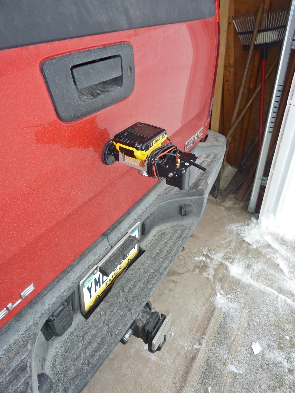

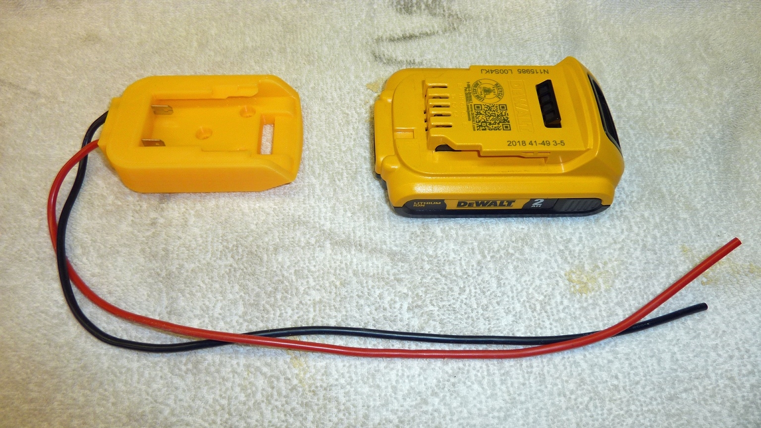

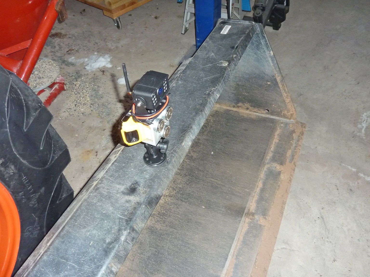

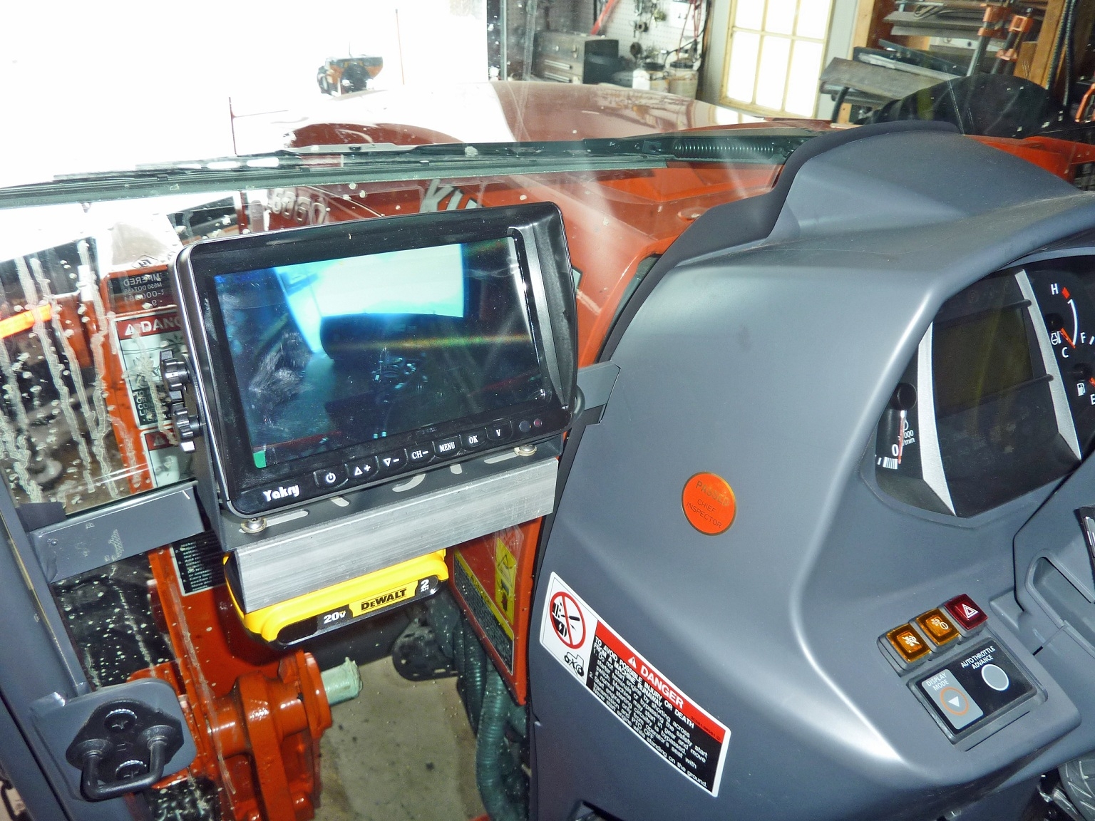

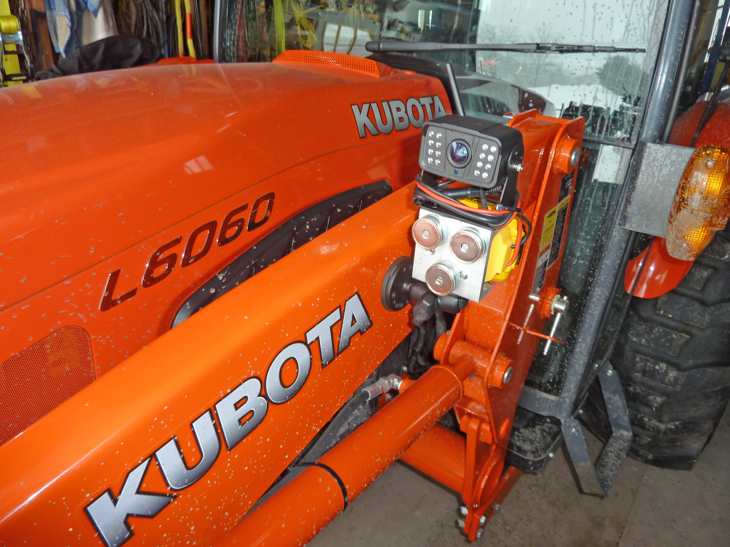

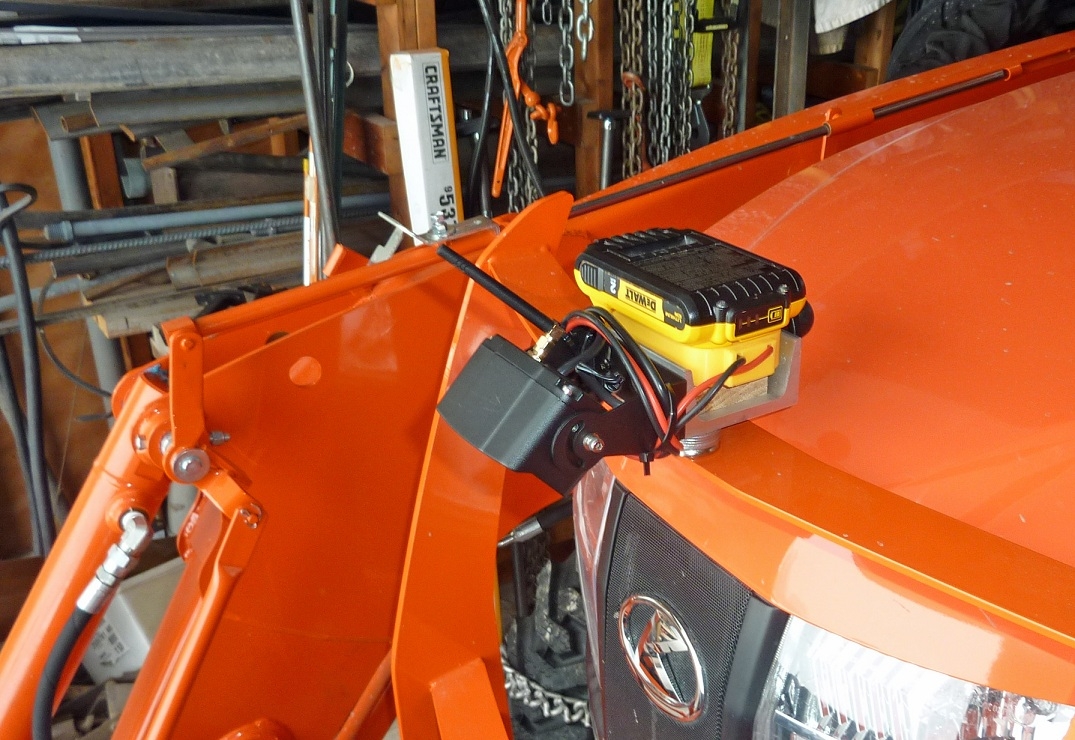

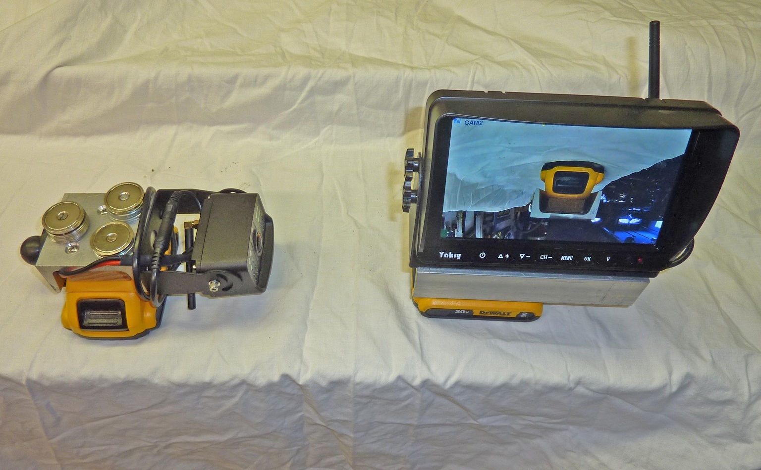

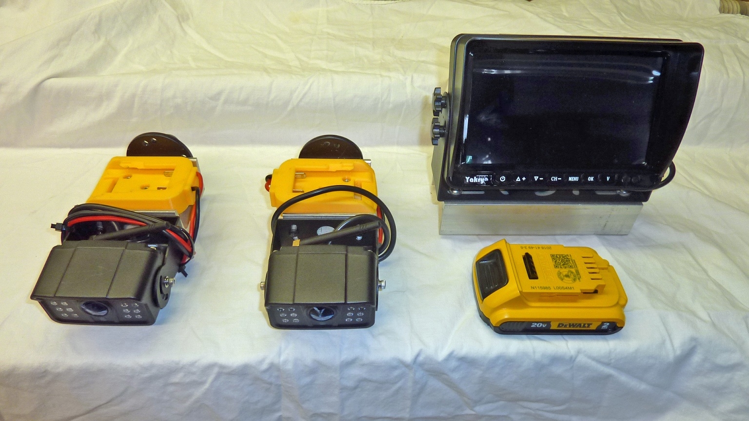

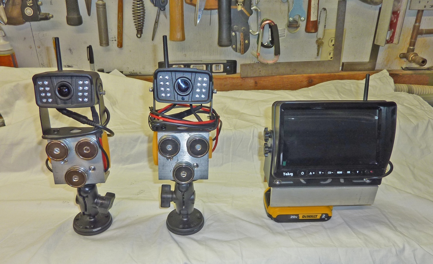

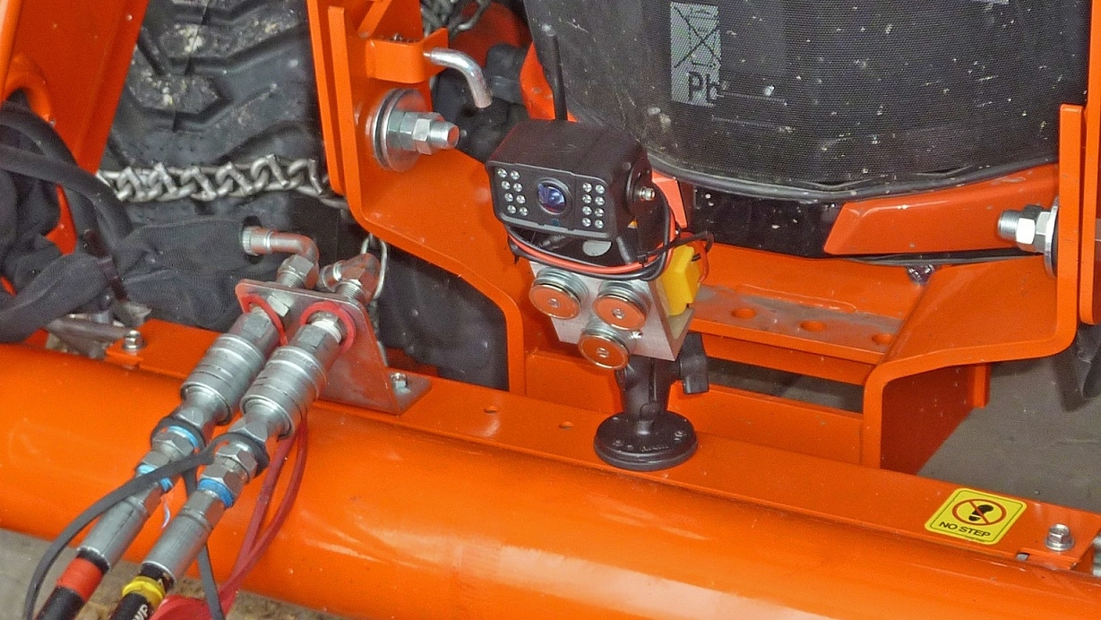

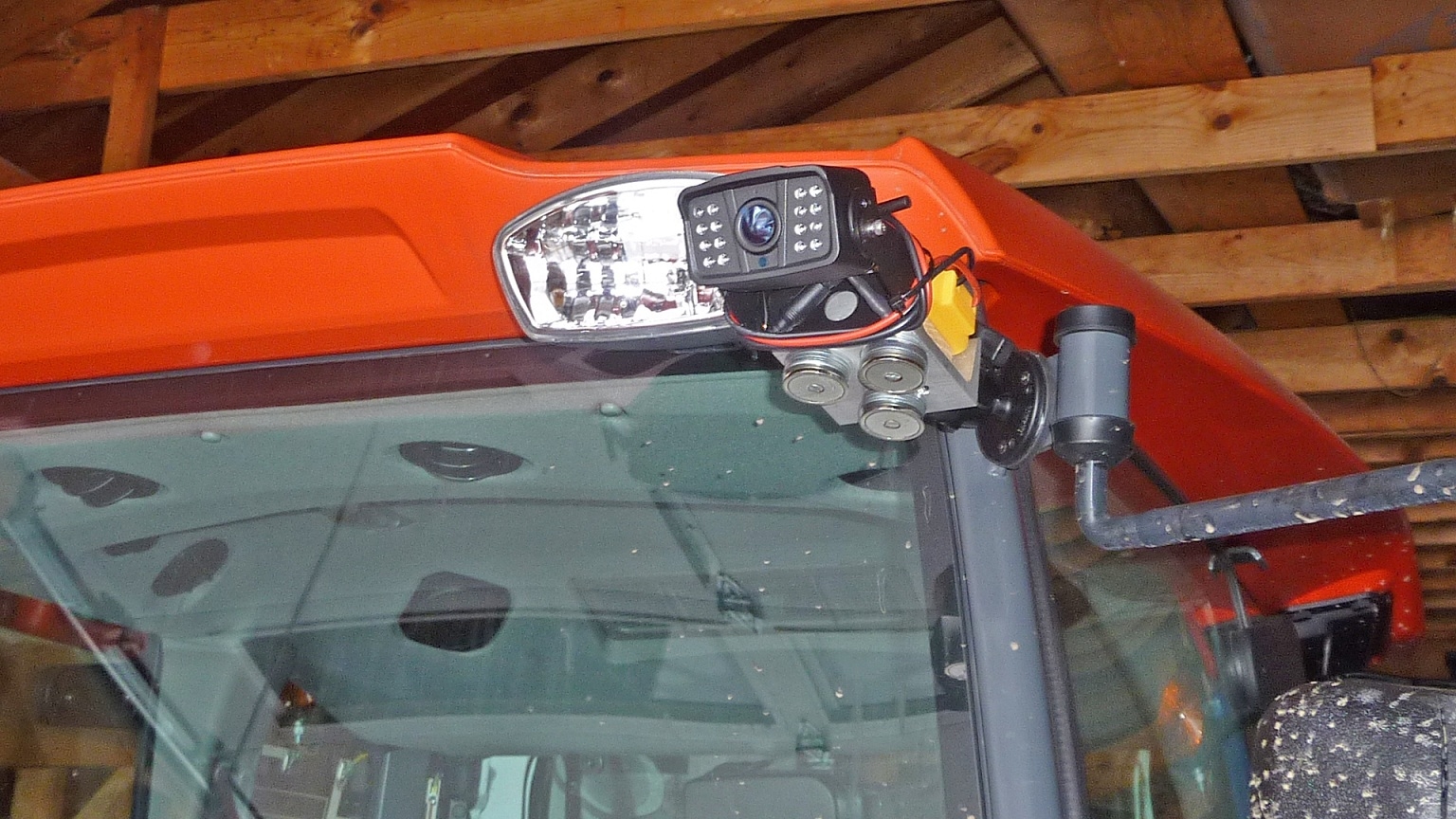

I've found that it's difficult to mount one or even two cameras on a tractor that will show what you need for all types of work. Powering the cameras is also tricky if you want to avoid running wires. Solar is an option but not for heavily shaded areas or at night. I solved these problems by making my own portable camera system.
I took my existing 2 camera wireless system and modified it to use cordless tool batteries. I added strong magnets so the cameras and monitor could be placed almost anywhere. It's sometimes better to put the camera on or near the work, rather than on the tractor.
View attachment 4182918 View attachment 4182919
View attachment 4182920 View attachment 4182921
View attachment 4182922 View attachment 4182923
View attachment 4182924 View attachment 4182925
View attachment 4182926 View attachment 4182927
This idea will work for most camera systems using an adapter for the brand of cordless tool batteries you use.

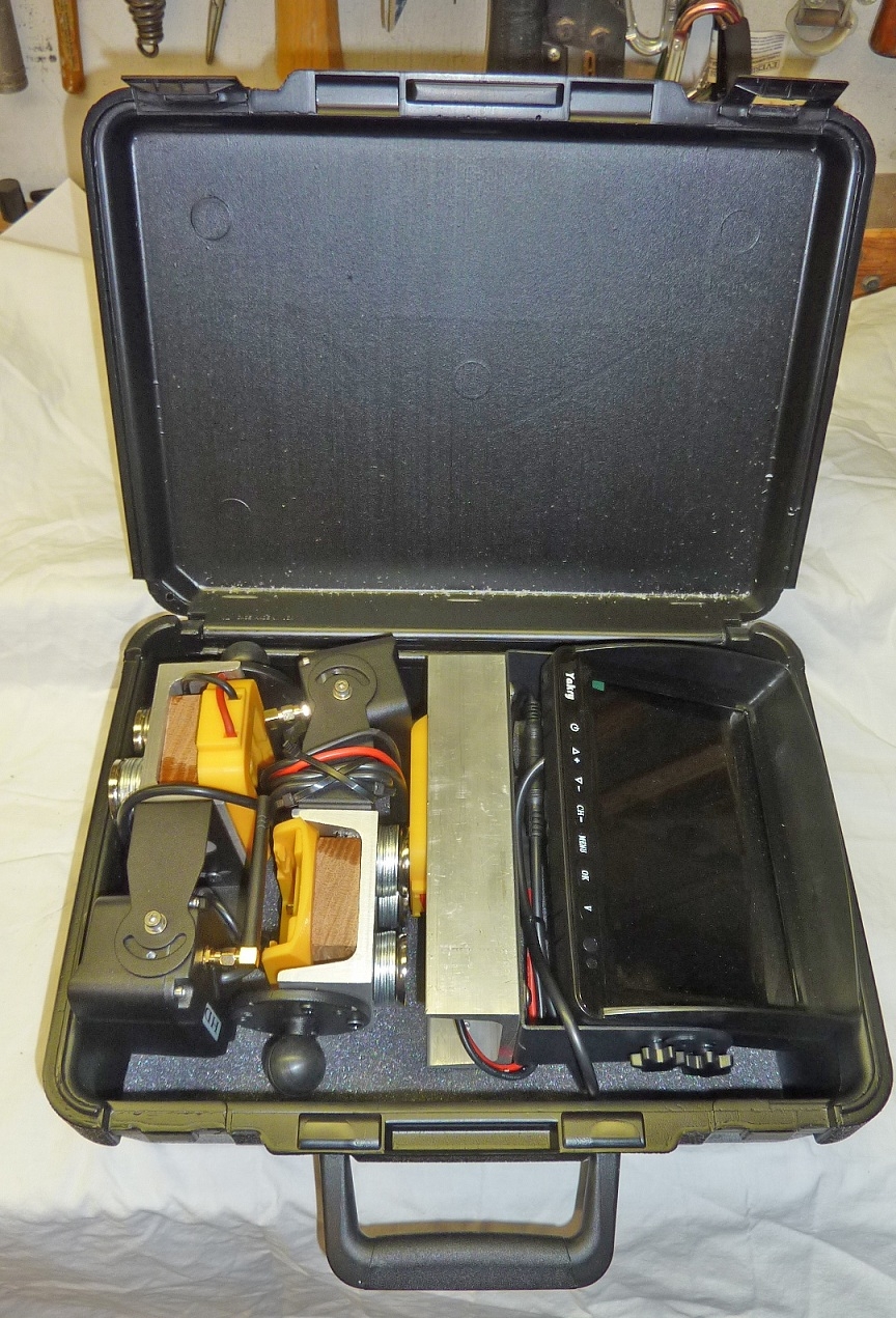

I don't always need the cameras, so the magnetic mounts are temporary. Most of the time, the system is in a case behind the tractor seat and deployed when necessary.

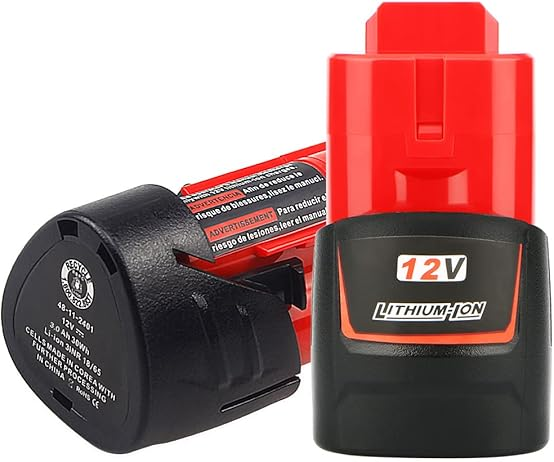

I use these handy tool battery adapters for powering a variety of projects. Be aware though that with some brands, the low voltage cutoff is in the tool, not in the battery. It is possible to over discharge using these adapters, which may damage the battery. Best to check the brand you use to be sure.
I particularly like the Milwaukee M12 batteries for their compact size.

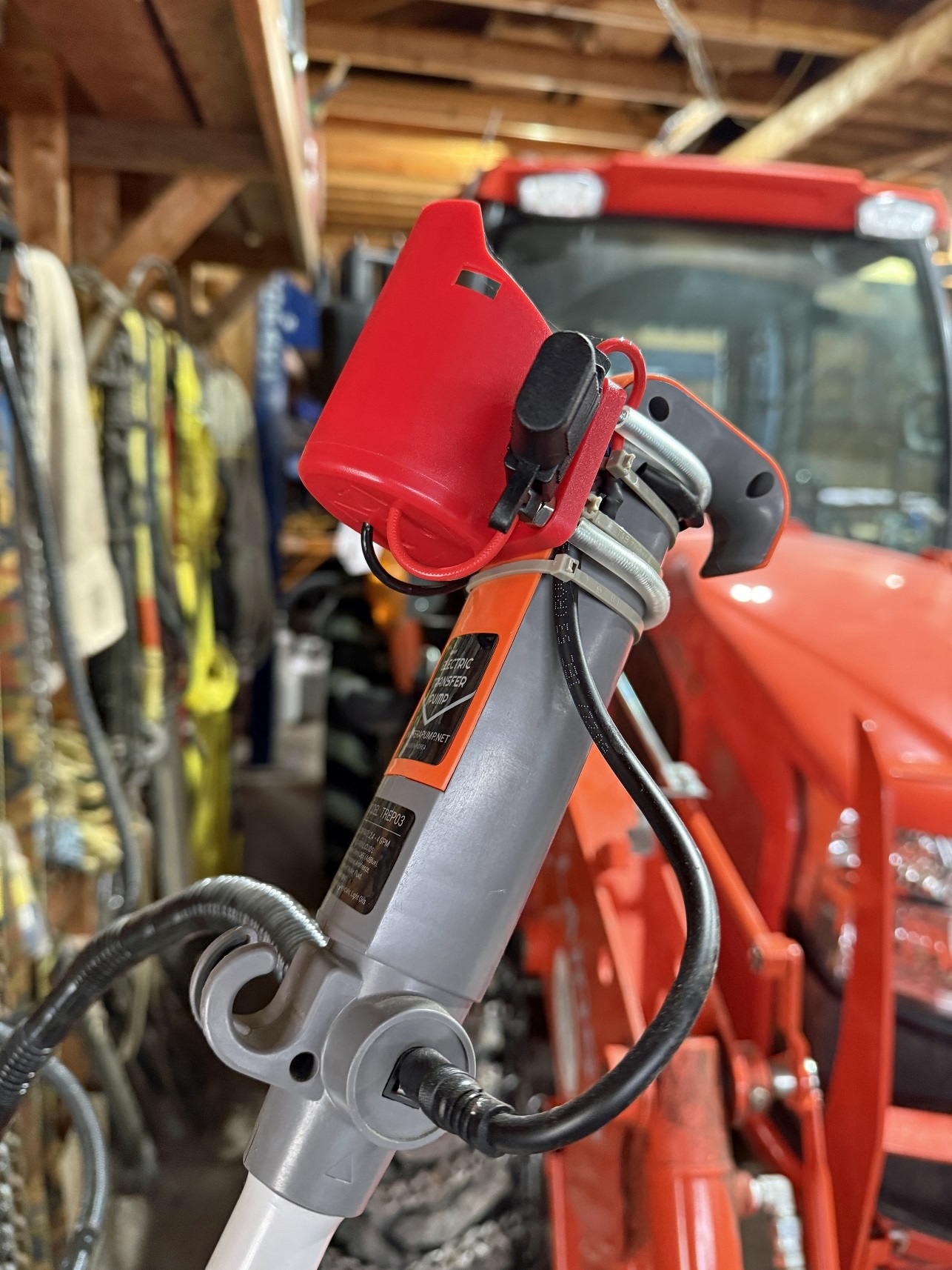

I use them for powering smaller tools, like this hand held fuel transfer pump:
Unfortunately, Milwaukee, along with DeWalt, are among the brands that don't have a low voltage cutoff in the battery.

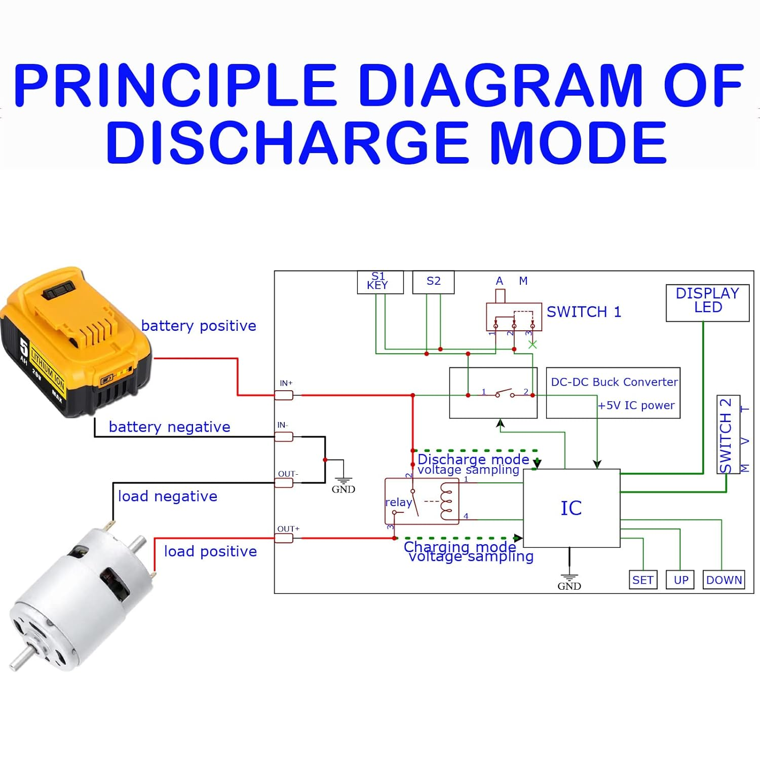

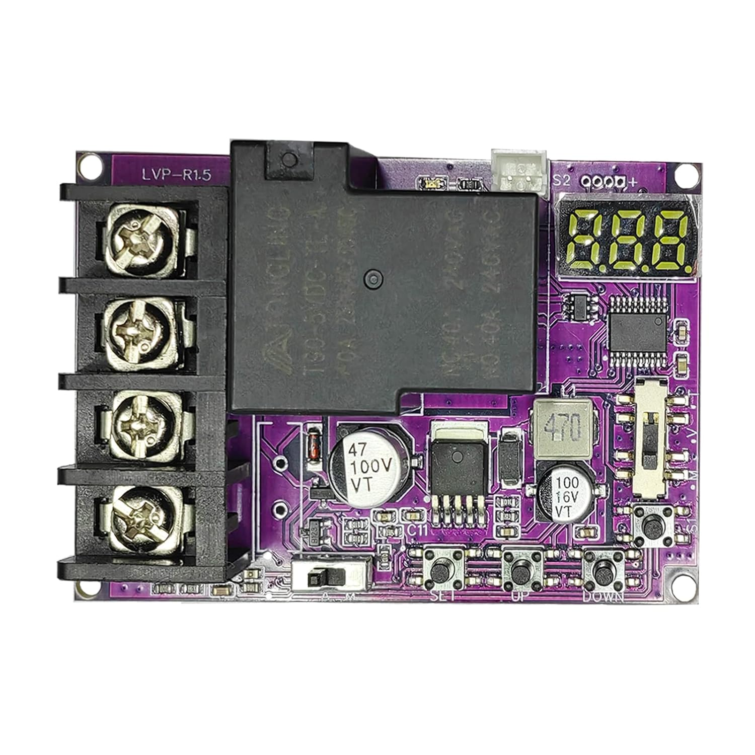

For a few of my cordless tool battery projects, especially those that run unattended, I use these low voltage cutoff circuit boards:
They're cheap, compact, easy to wire, and work with voltages from 5V to 60V.
