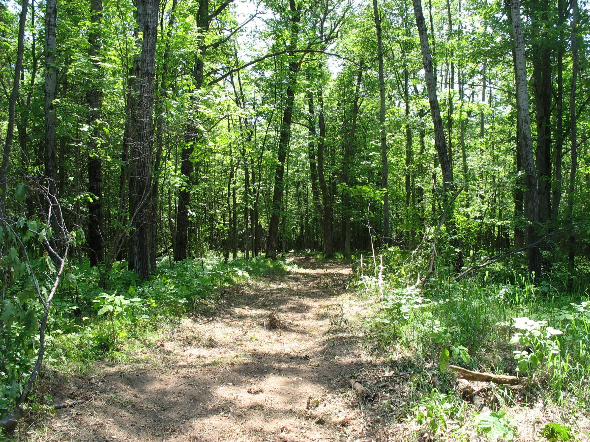

The driveway is what convinced me to buy my tractor - I wanted one, but just couldn't take the step.
I had a couple estimates done, which came in over $12,000.00. With the aid of my new tractor, chainsaw, and the local gravel guy I did it for less than $2,800.00. It took me longer than a pro would have, but I also got a tractor out of it.
When I started there wasn't even a foot path through the woods. Here is a picture from the other end of the driveway after I completed the first phase - a tractor wide path:
