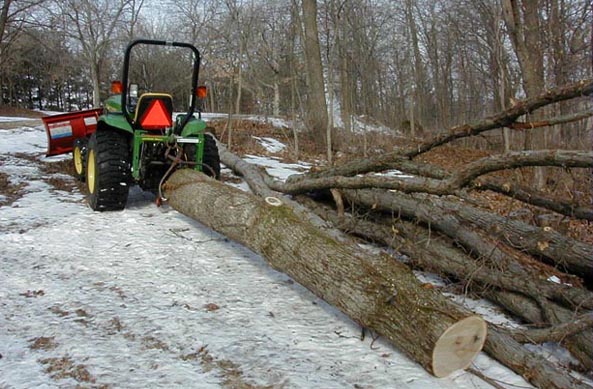

There are several threads that address your need to drag out trees and logs. Lots of suggestions and lots of safety concerns, as it should be.
The attached pic is how I move logs with an I-match, and logging tongs. Yesterday I hooked onto a similar white oak log as the one shown, which was 18" on the small end and 16' long. I felt it was pushing the limits of what I wanted to put my JD4300 with HST through, but still it handled it without a hint of making the front end light (had FEL on). The woods is a bit muddy now, and adds to the difficulty a bit.

I have moved a lot of trees with the JD 790 and quick hitch like the I-Match ... I have never had the front end even come close to lifting but, be careful and go easy and don't lift the log very much, just clear the ground a few inches and again go slow. You can hook the log without getting off the tractor, This works great and is a much easlier pull than a chain .... I think that I must have seen "BEENTHERE's" pictures and tried his approach.

I do quite a bit of logging with mine. Just cut your timber to a size that your tractor can handle easily, you won't have a problem. I wound up builing a winch that works great. If you do any yarding I would reccomend one.

Thanks everyone for the great suggestions. Sounds like it is a do able project.
