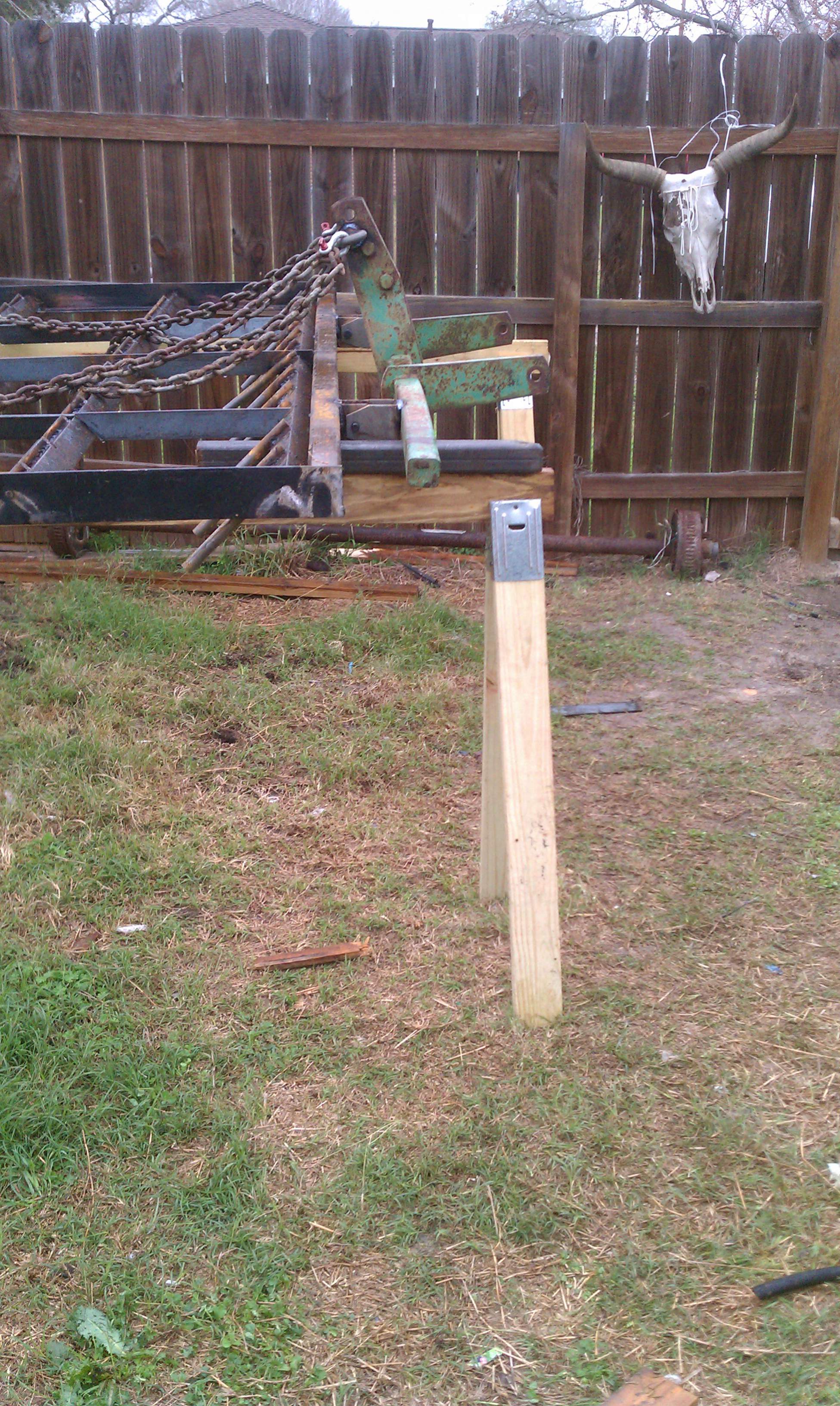

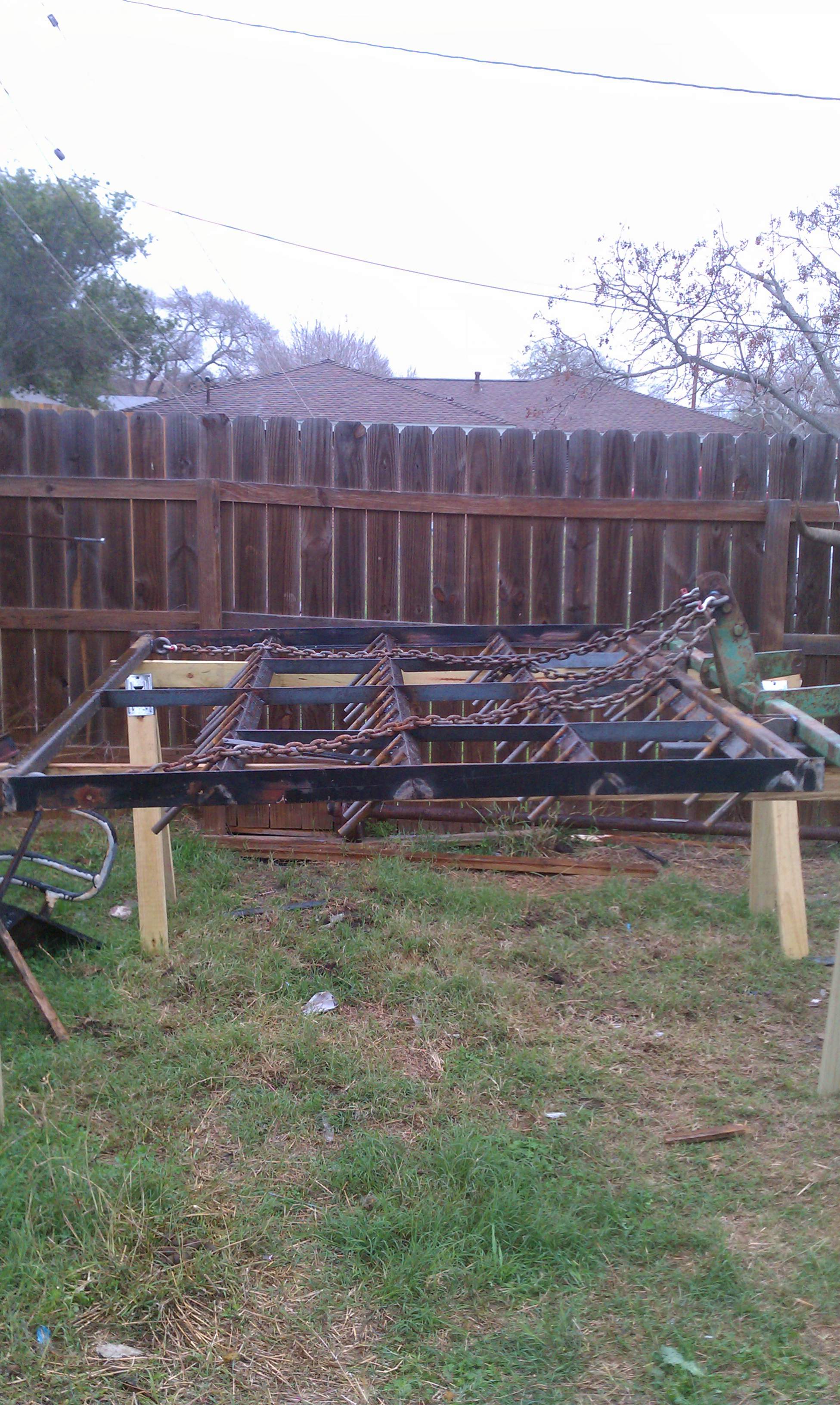

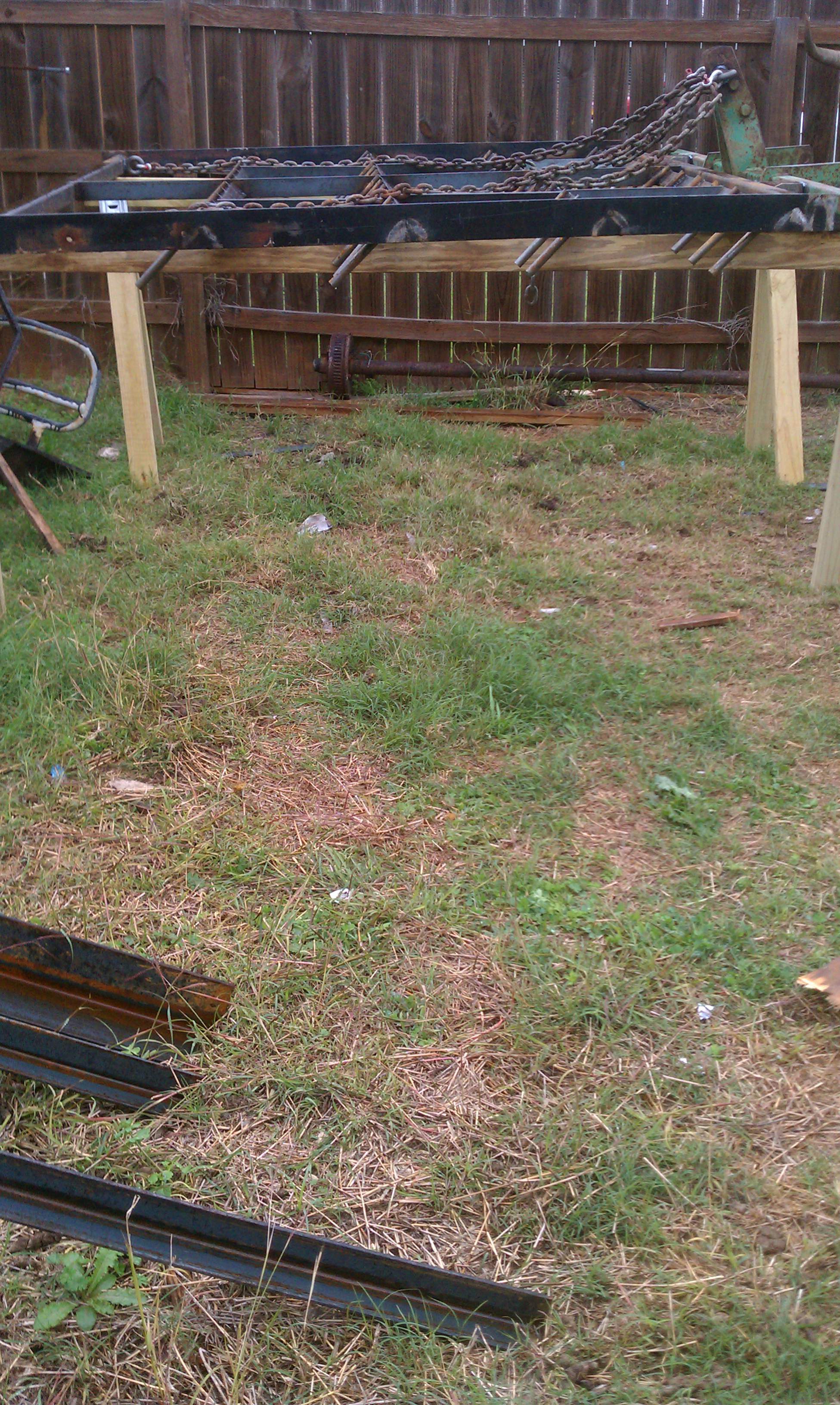

My concern is that the hitch arms will too low unless those existing flatbars are angled up some. Then install the top link mast plumb in this position.
I was looking at that too, wished i had the tractor here to test fit. I know my hitch arms will go almost to ground level when lowered all the way. I think I may have to modify the top link connection, my top link may extend that far, not sure. May have to build the 3 point connection completely, I had this old one laying around, came with some other 3 point equipment I had bought about a year ago.
I bet you're going to have to weld it rigid. Don't let me sound "down" because that really is a nice build.

I may have to, I am curious to see how it does when I get it hooked up. I wish the tractor was not 100 miles away right now, anxious to see what it does. I dont think you sound "down", I like tinkering with projects like this. Sometimes ideas work, sometimes they don't:D

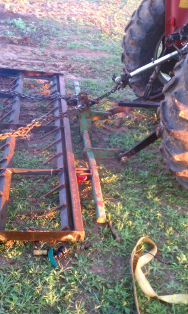

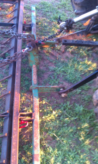

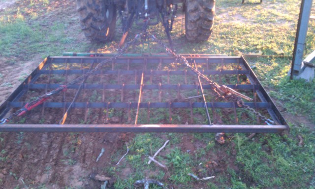

The drag works! No kick up, pulls good. I am going to have to modify the top link connection. Had to use a short piece of chain, as my top link is not long enough. Was able lift the drag and lower it. I am going to raise the point where the chain connects to the draw bar. Think i am going to use cable and turnbuckles instead of chain.

When i get back home Sunday will put a couple pics of how it is on the tractor. Bringing draw bar back home to modify and will have pics as i go on it. Now that I know it works I feel alot better.
/ Drag Harrow Project
#38
Hooked up on the tractor
