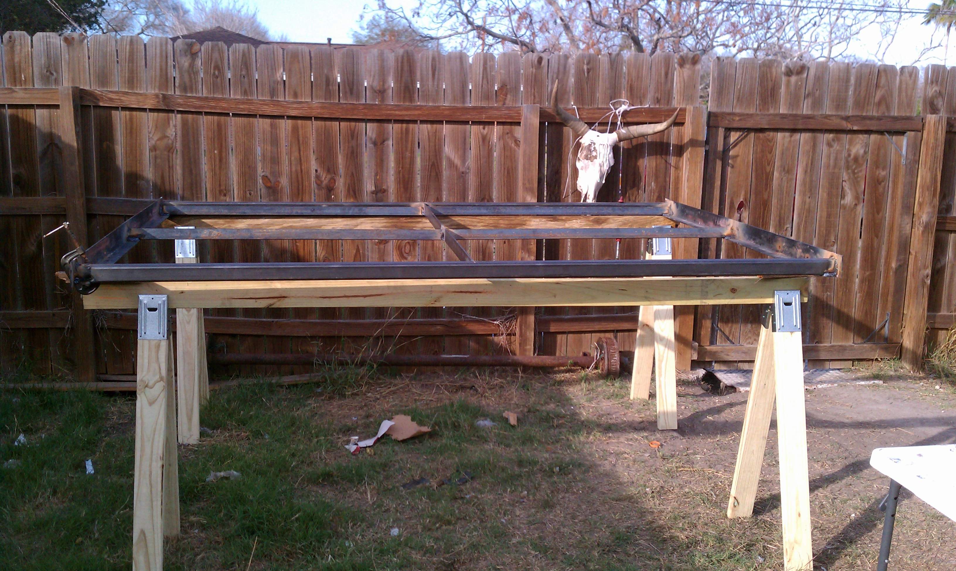

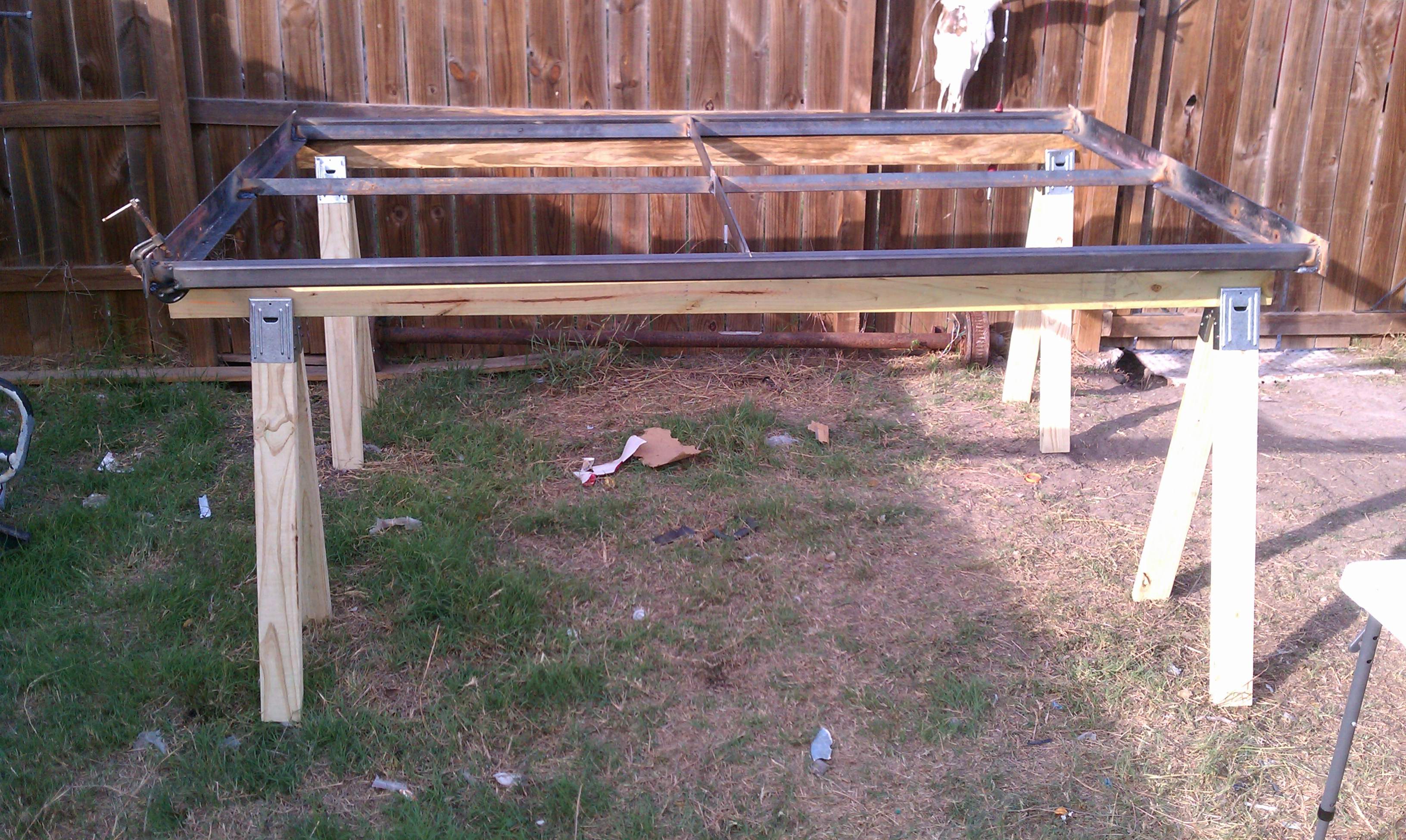

Did not get as far as I had hoped today, but here is what we accomplished between honey do's. Turning into a father son project as my 15 yr old son took paticular interest in this today. Helped grind, do some tack welds and even ran a bead.:thumbsup:

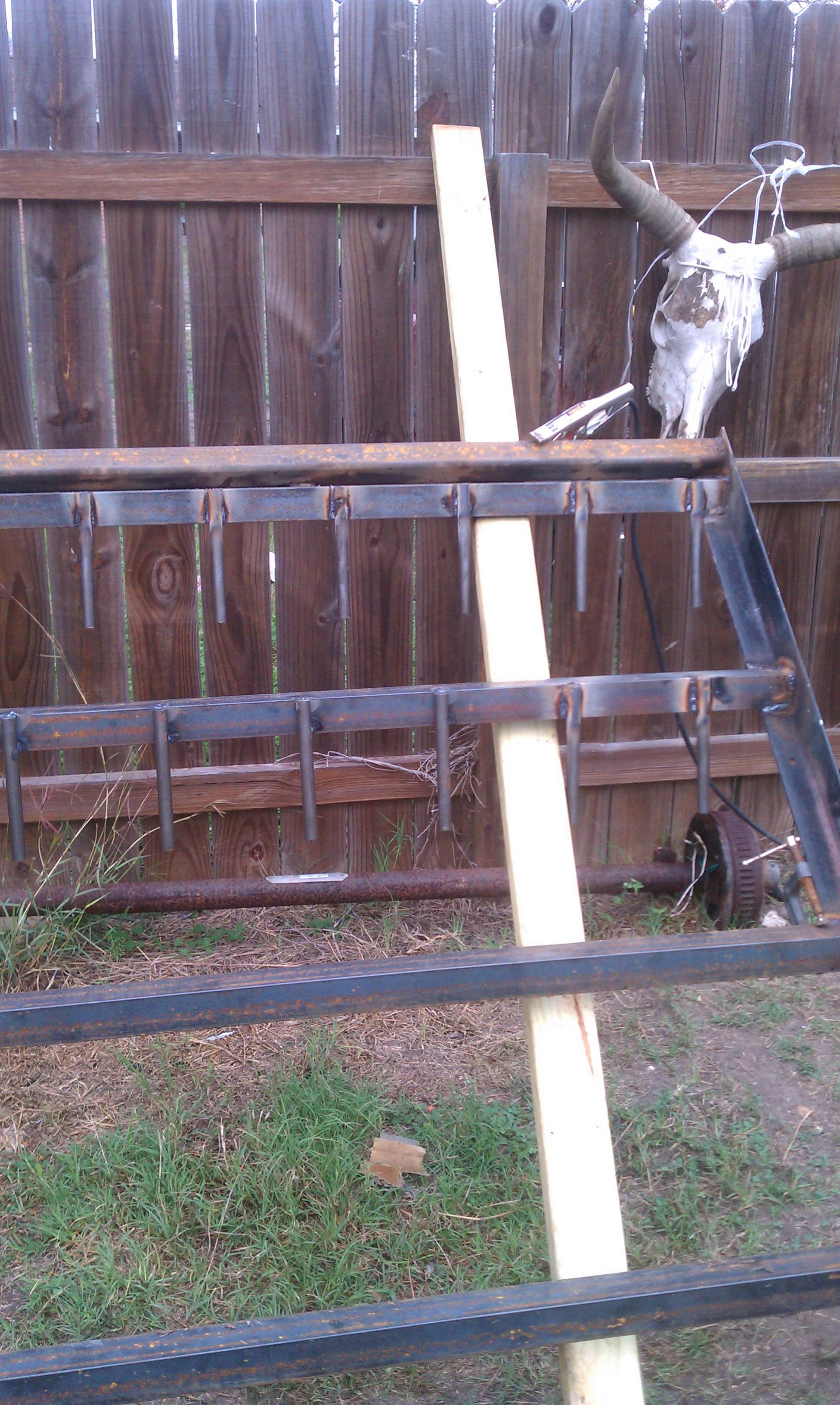

Had some time to play with it today.Got the 1st 2 rows tacked up and started to weld in.

I am using 3/4" cold roll round. So far thats all I have had to buy for this project, the rest is left overs from other projects I had in the garage. Got all the spikes welded on and working on the hinges I am going to use to hook 3 pt draw bar too the drag now.I plan on having this finished next weekend, should have some more pics then.

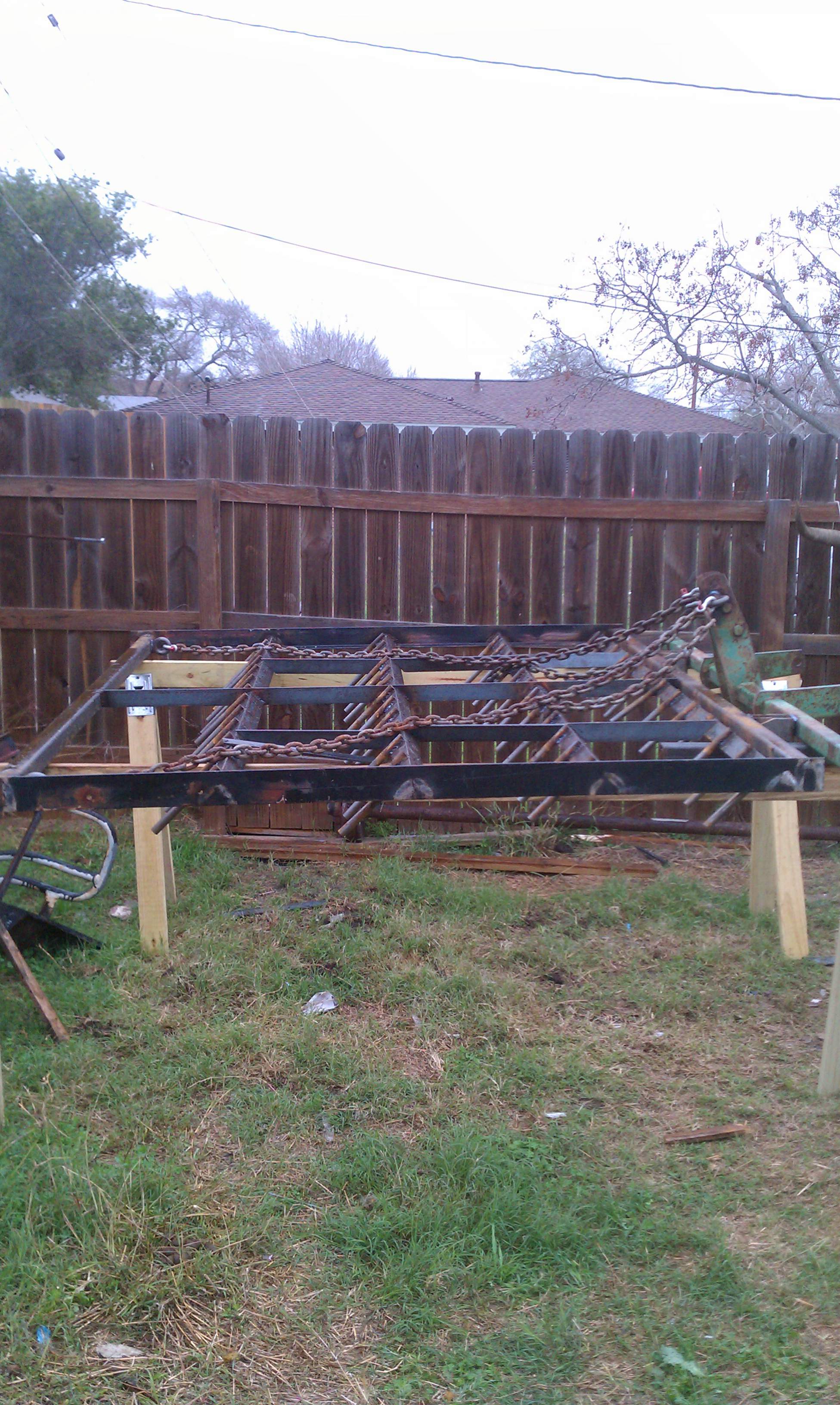

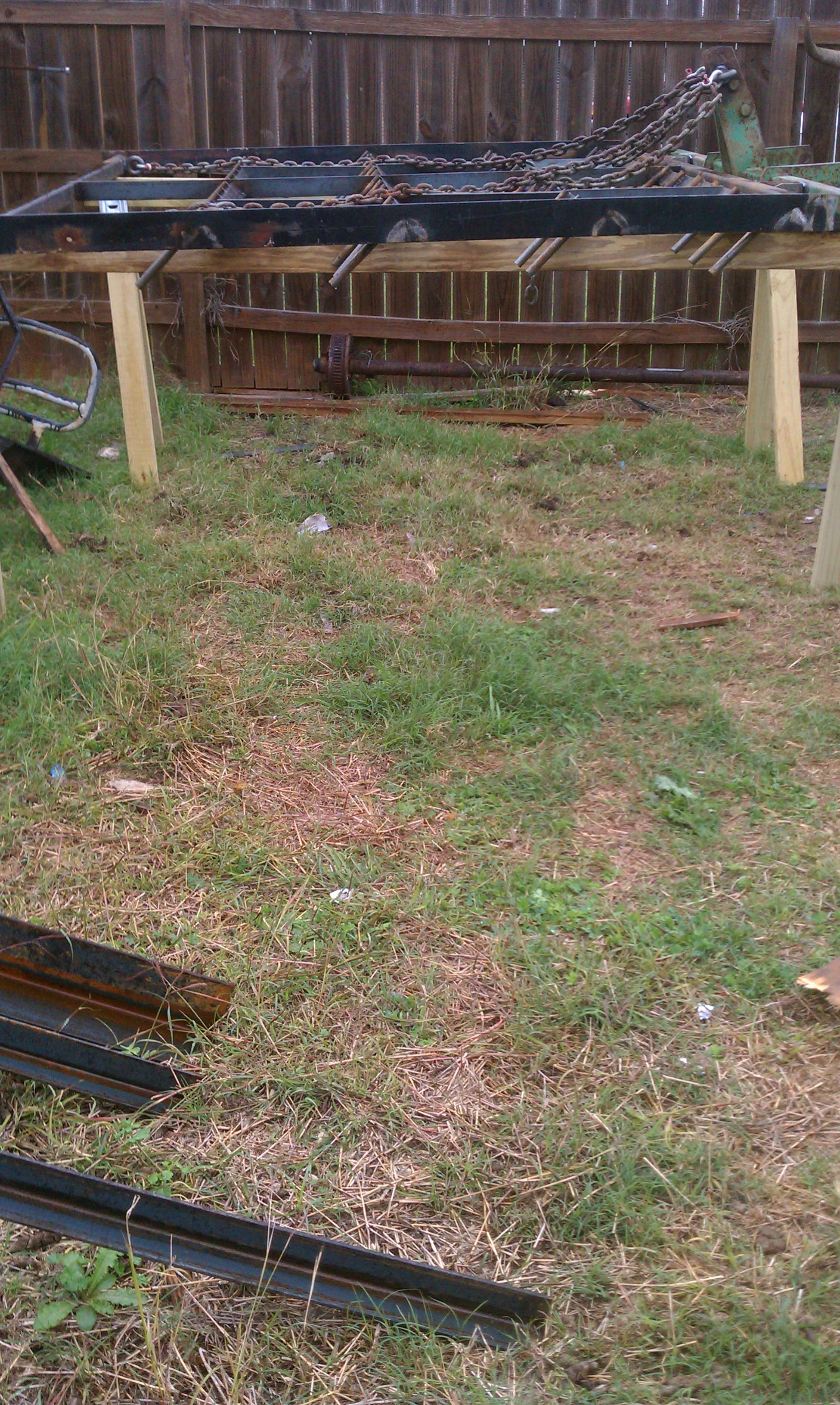

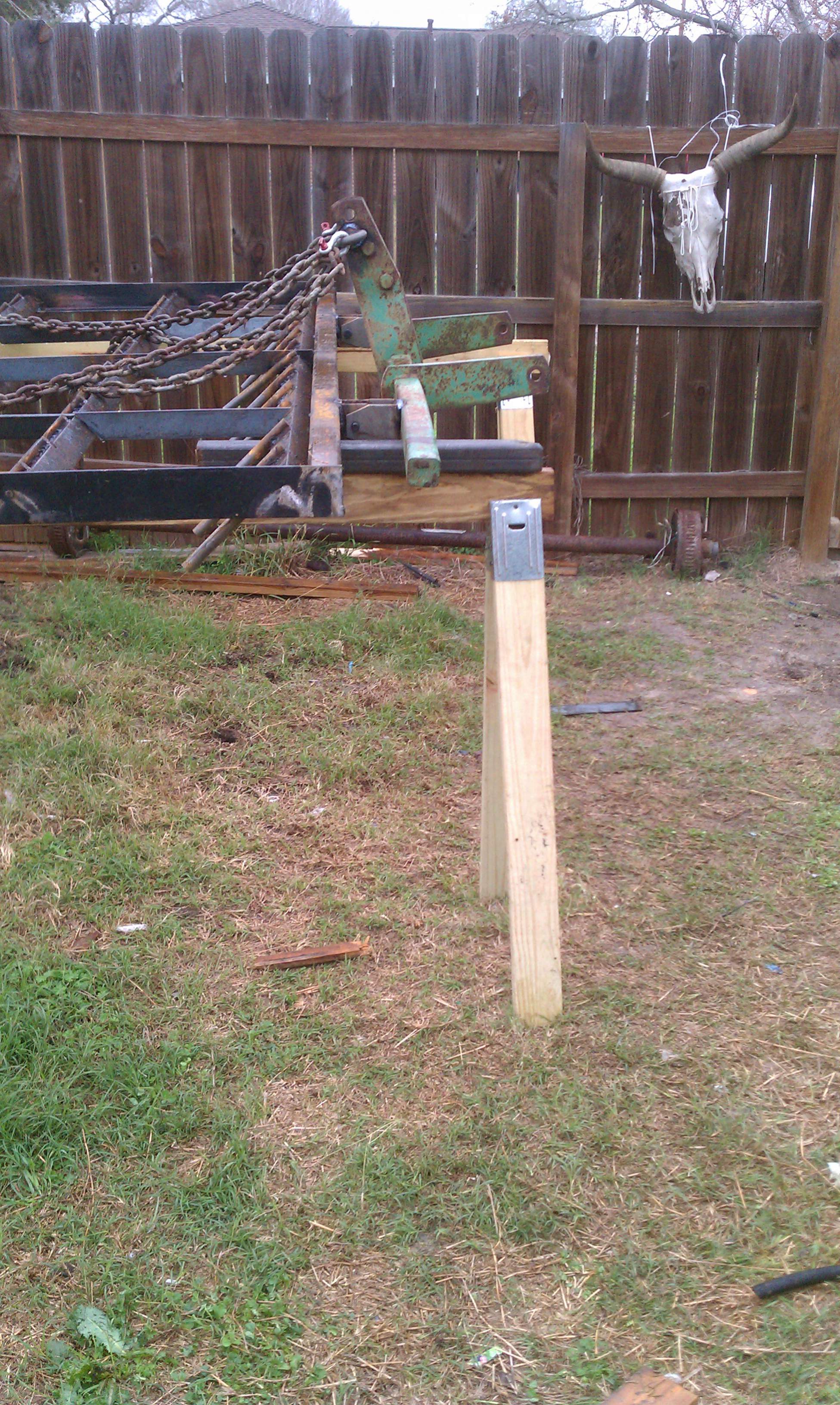

Not completely yet, almost done, still have a few braces to weld and clean/paint.Between some small rain showers and callouts @ work this is where I am at. Defiently will be done next weekend.Off work and headed to our property to finish and try this out.Hopefully the hinge will work out, if not I weld it up solid.

I built one somwhat similar to this but I had my rotating hinge point higher up. Mine dug in too much in front and kept kicking the back up so I had to add struts in to keep it rigid and prevent the hinge from working. I used the toplink to angle it after that.

I put the center point of the hinge below center of the 2" square tubing thats across the front, which is my pull point. I think that will provide enough"pulling up" on the front by the tractor to keep it from digging in and kicking back. May be not, will find out next weekend for sure.

Good luck--that may work. Great project and nice workmanship.
/ Drag Harrow Project #20
My concern is that the hitch arms will too low unless those existing flatbars are angled up some. Then install the top link mast plumb in this position.
