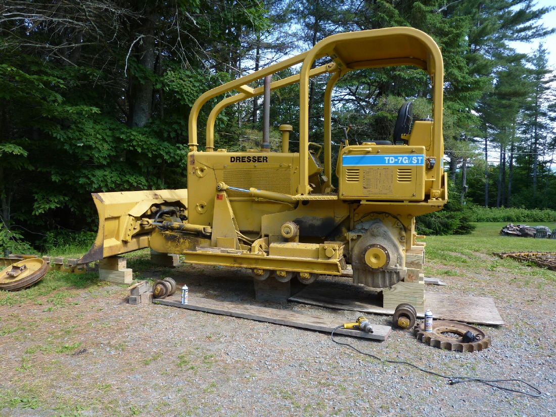

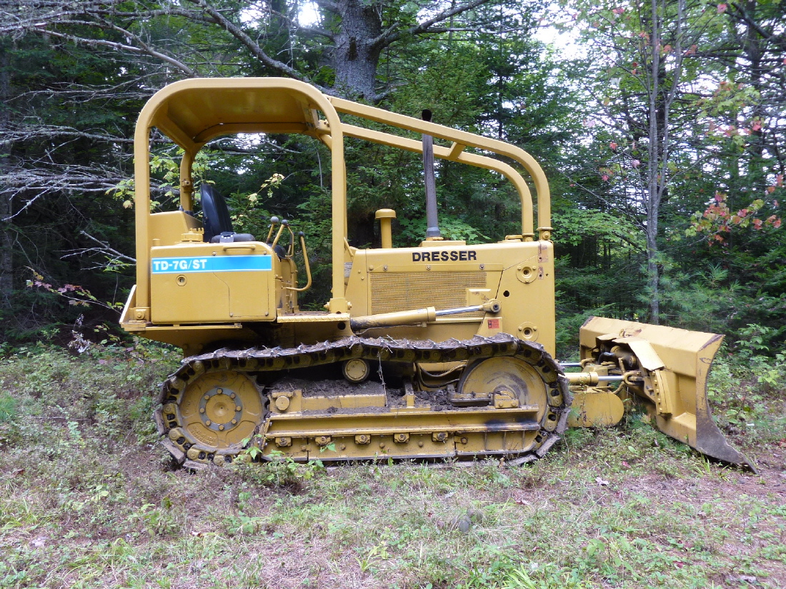

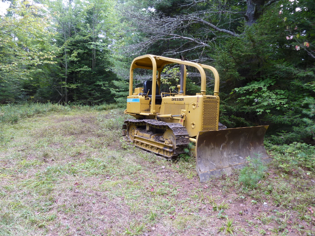

I bought a Dresser TD7G this spring and just finished redoing the under carriage about a month ago. I am glad my track wasn't any longer like the Hi-track, both from an expense view point and the extra work viewpoint. It is a small point though. Cats are good machines. I looked for months for a D3C or decient JD450C I could afford. I ended up with the Dresser and am very happy with it. Easy to work on also.
