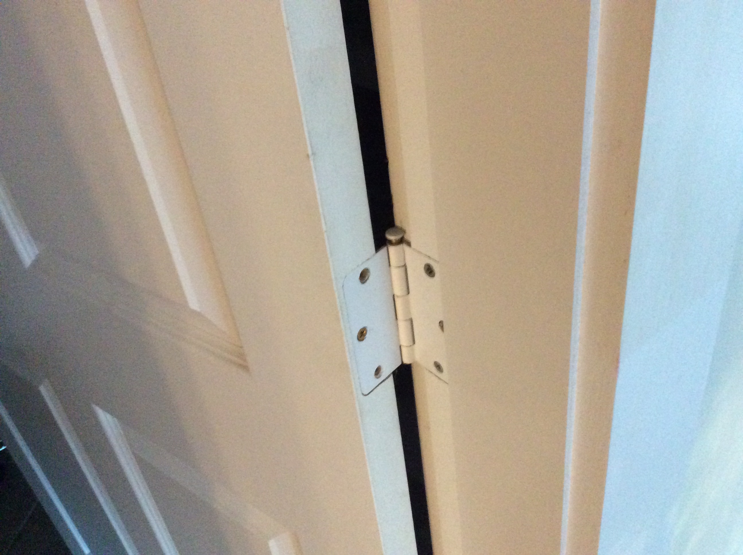

Of course, for new construction, my favorite method is to just paint the door in place on the hinges.
I have a bunch of old hinges that I swap onto the doors for painting. Spray it in place and swap the new hinges back on the next day.
