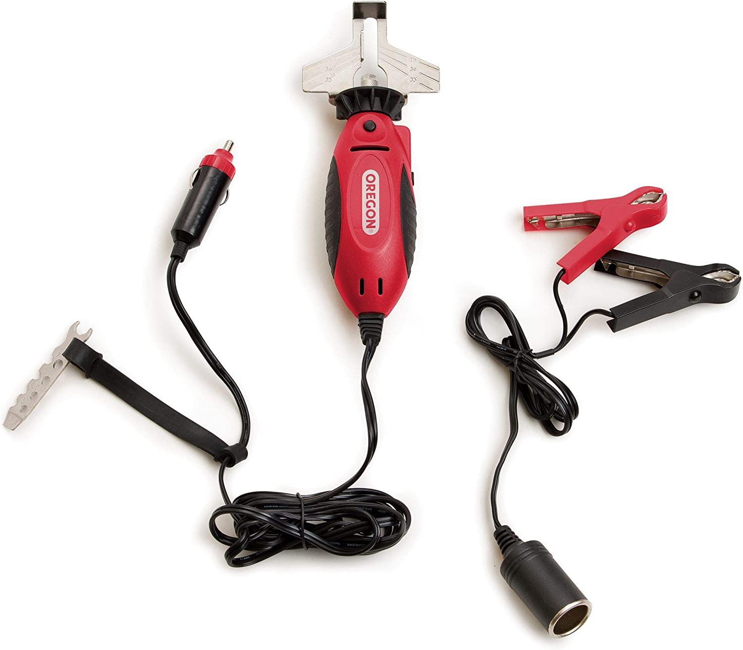

I use one of these from stihl. A bit pricey but takes the guesswork out. Sharpen a 20 inch chain in under 5 minutes. I take an extra chainsaw with me, easier than changing out the chain.

Sorry forgot the picture.

Everyone has their favourite and I do not want to get into a brand war. I have 4 saws, 2 Husqvarna’s with 20 inch bars, and 2 Stihl’s, both with 16 inch bars. I have used .058 and also .050 chain on the Huskies, both are great but I have the best luck with Stihl chain, it just lasts longer from my experience.
I have an Oregon electric hand held sharpener same/similar as shown in other picture's in these posts. I also have a complicated jig that uses a file but seems to take a long time to set up and move. The hand file, with a guide is my most common sharpening tool and pretty hard to beat plus it can be used it the bush without any problems.
As soon as the saw starts making sawdust instead of chips I know it’s time to sharpen as cutting just takes too long. The saw should not require any pressure to cut, if you have to force it too work then it’s too dull, the chips, sawdust are your guide as to what’s going on.
