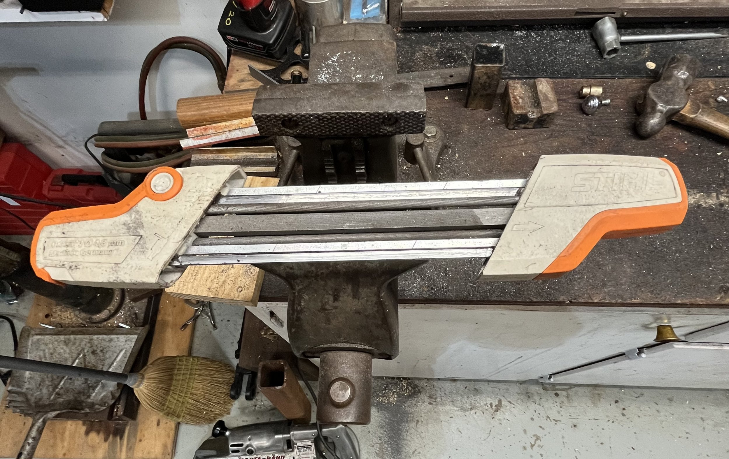

I use one of these from stihl. A bit pricey but takes the guesswork out. Sharpen a 20 inch chain in under 5 minutes. I take an extra chainsaw with me, easier than changing out the chain.
/ Do These Actually Work... #39
Sorry forgot the picture.
