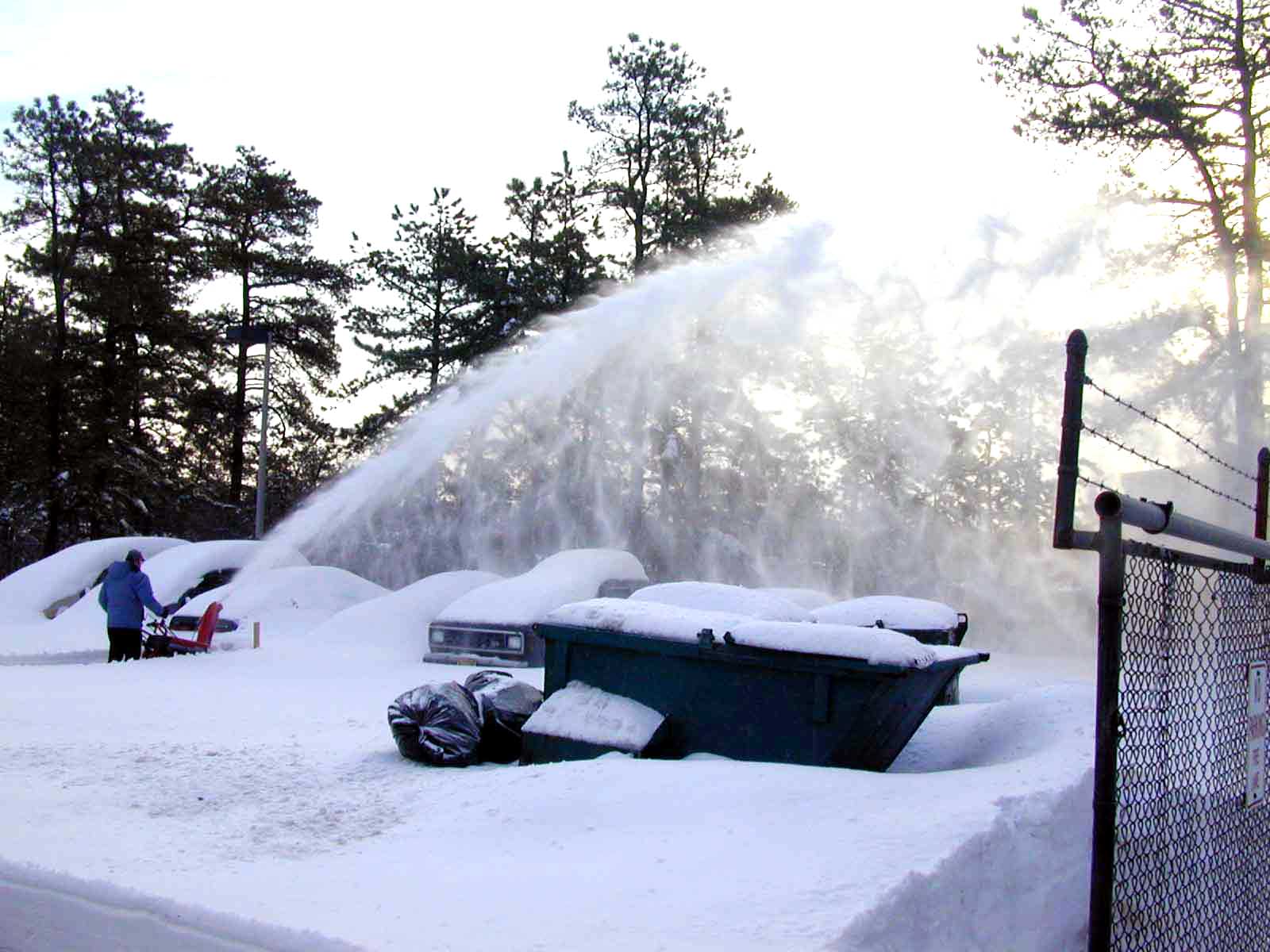

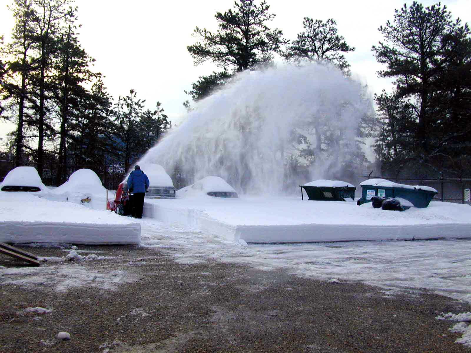

I know the discussion is about 3pt blowers, but I don't have one. I've posted these pictures from when I cleared out company parking lot before, but the point is HP is not the only factor. The impeller design, tip clearance and RPM all factor in. Gravely blowers are often known to throw snow well, and these images are of my 32" with the 12hp tractor. It will throw snow about 60-70', and the 32" blower is not known as the best thrower in the lineup.
