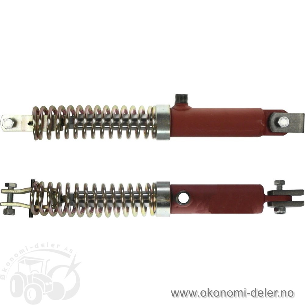

I'm wondering if you a bit skimpy on the brake pads. There just isn't enough area to do the job. Also if the pads were in a bigger circle I think they would be more effective. Just my thoughts.
/ DIY logging winch build #202
Truck air systems are under 175psi, while the Wallenstein hydraulic remote system uses 800psi on a 2" cylinder (to retract the rod to engage, so the weak side - but still).
That are hydraulic cylinders for trailer brakes running on the tractors hydraulic system, don't you use this type of brakes in the us?
#203
Yeah, I went back to the clutch disc. I'm hoping it works better now. There are commercial made units that only have 4 pads though. My thought on keeping them in close was to keep the drum end from flexing as much (I'm not 100% sure if it is or isn't) Thanks
