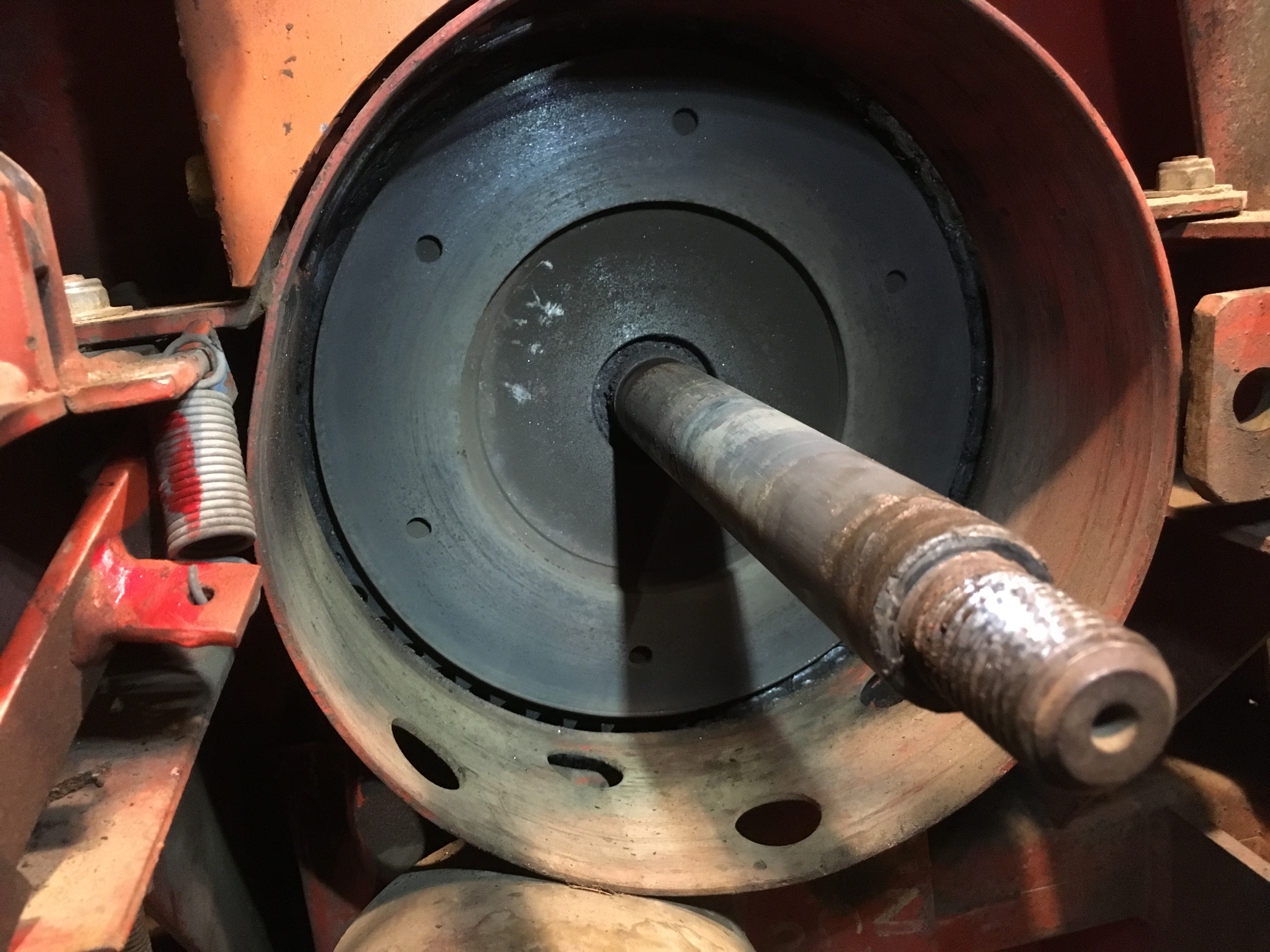

I'm wondering if you a bit skimpy on the brake pads. There just isn't enough area to do the job. Also if the pads were in a bigger circle I think they would be more effective. Just my thoughts.
/ DIY logging winch build #202
Truck air systems are under 175psi, while the Wallenstein hydraulic remote system uses 800psi on a 2" cylinder (to retract the rod to engage, so the weak side - but still).
That are hydraulic cylinders for trailer brakes running on the tractors hydraulic system, don't you use this type of brakes in the us?
#203
Yeah, I went back to the clutch disc. I'm hoping it works better now. There are commercial made units that only have 4 pads though. My thought on keeping them in close was to keep the drum end from flexing as much (I'm not 100% sure if it is or isn't) Thanks
With the tractor not running you should be able to feel any flex by holding you hand on the drum end and applying and releasing the clutch. The cable should be mostly spooled out and you should spread your hand out over as much an area of the drum as possible. It's interesting what you can feel but not see.
#206
It's difficult because one, I am alone and two it wants to rotate as you apply the force.
