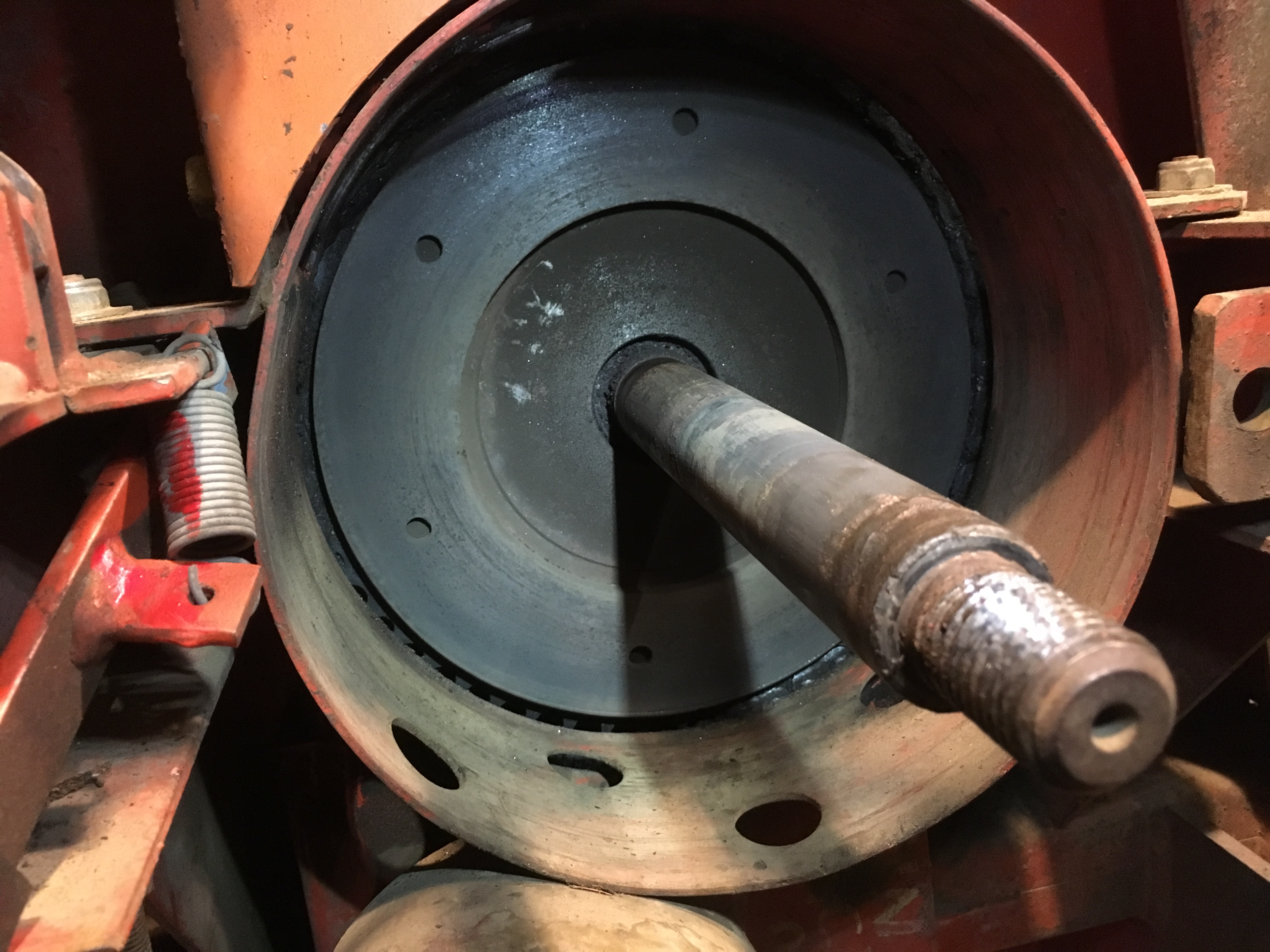

I'm wondering if you a bit skimpy on the brake pads. There just isn't enough area to do the job. Also if the pads were in a bigger circle I think they would be more effective. Just my thoughts.
Yeah, I went back to the clutch disc. I'm hoping it works better now. There are commercial made units that only have 4 pads though. My thought on keeping them in close was to keep the drum end from flexing as much (I'm not 100% sure if it is or isn't) Thanks
With the tractor not running you should be able to feel any flex by holding you hand on the drum end and applying and releasing the clutch. The cable should be mostly spooled out and you should spread your hand out over as much an area of the drum as possible. It's interesting what you can feel but not see.
It's difficult because one, I am alone and two it wants to rotate as you apply the force.

Well I have what I consider to be great news! The winch worked like a champ today! I didn't even give it an option I hitched two logs on it I would guess at 12-14" by about 20' long and it hauled them right in! I did have to make one minor adjustment on the bolts that adjust the tension on the ramps. I worked it pretty hard this morning and I am very pleased at this point. I call it a win :drink:
I would like to thank everyone for their support and advice, it means a lot to me. Here's to you all :drink:
