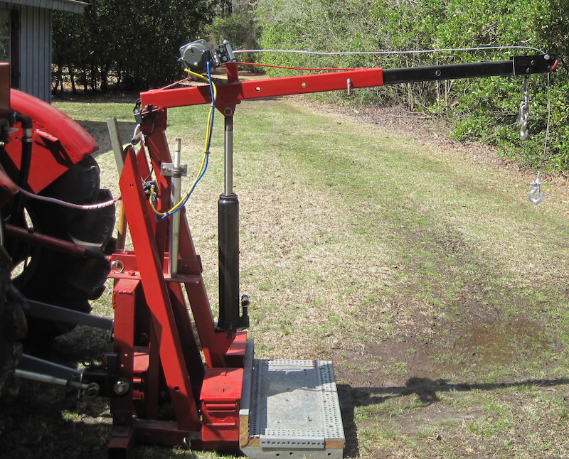

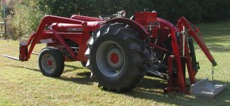

Think rear!... Here is an HF 2-Ton engine lift, a lot simpler projects with minor mods.
Nice I like that a lot, and it sits on the ground so the lifting force doesn't rely on the tractor frame.
