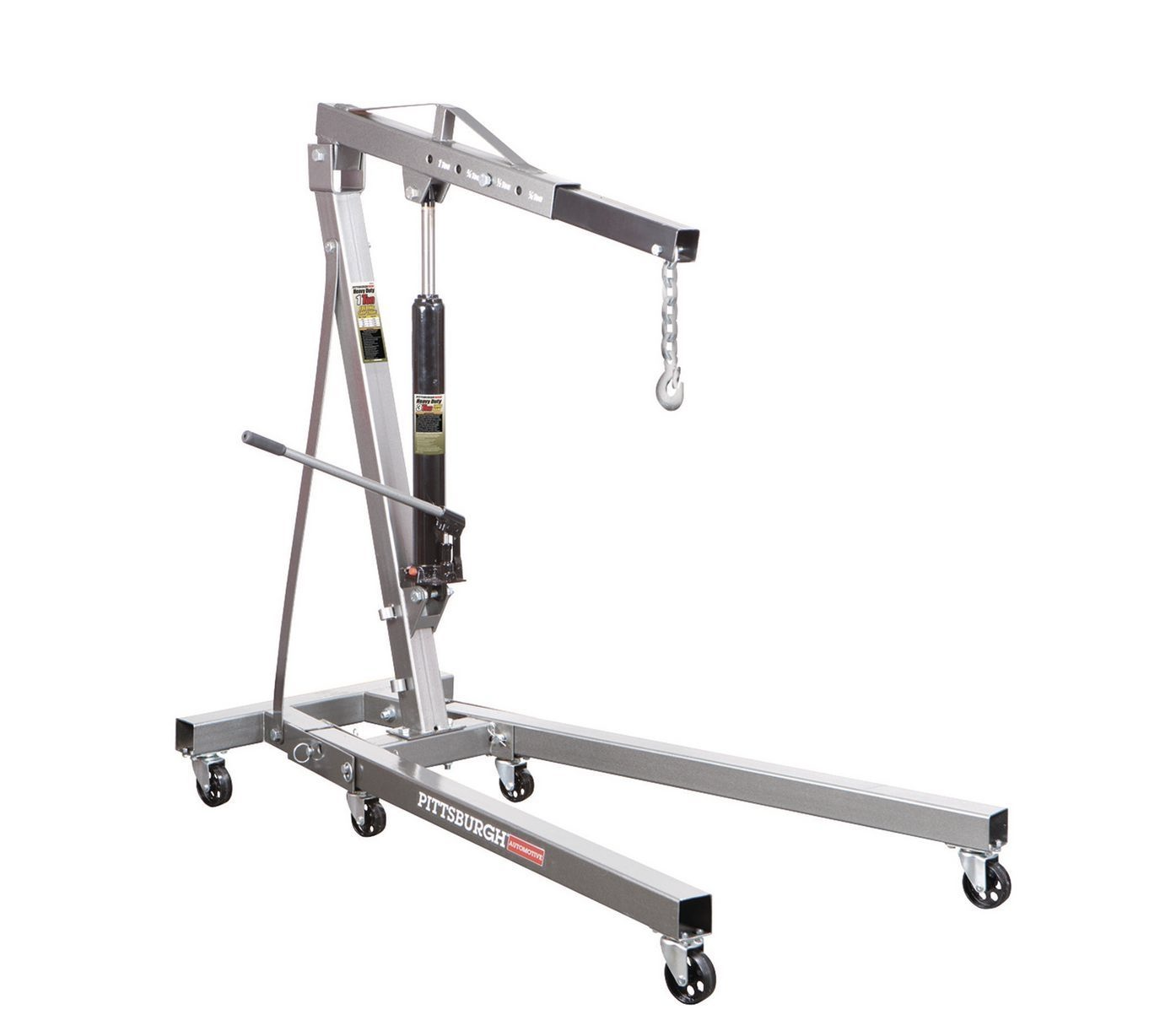

It's time for a small shop crane, or something to help me lift things. It's just old age, but I can no longer lift the normal things in the shop. Time for some help.
It needn't be all that strong. 500 lbs max would be fine, and 50 more common. But the shop is small and it needs to fold up and be out of the way.
I've looked at the Harbor Freight & might go that way. Comments? It's certainly inexpensive.

I purchased one of their pickup mount jib cranes and the cylinder leaks down from the weight of the boom. Like you I just use it to move stuff but am still disappointed that it won’t support a load for any period of time.
/ Small Shop Cranes #4
I got the hazard frought one. Used it to pull the cummins out of my old truck and tear down my SXS a dew times.
Cant complain. It does leak down but what ever

I've had a similar Harbor Freight crane like that for 25+ years. It folds up nicely when not in use and takes up about 4 square feet of floor space. I rarely use it, but when I do, it's really handy. (y) Last time I used it was about 2 years ago when I pulled an engine and transmission out of an '85 chevy pickup as a single unit before scrapping the truck chassis. Works as advertised.

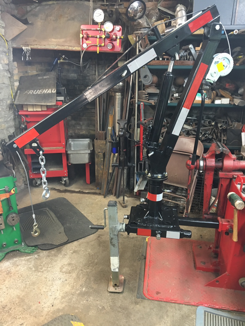

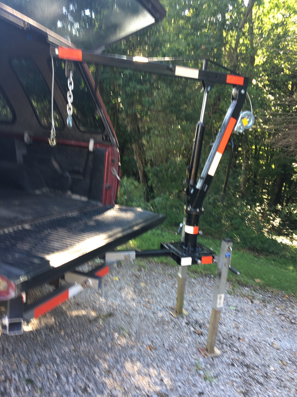

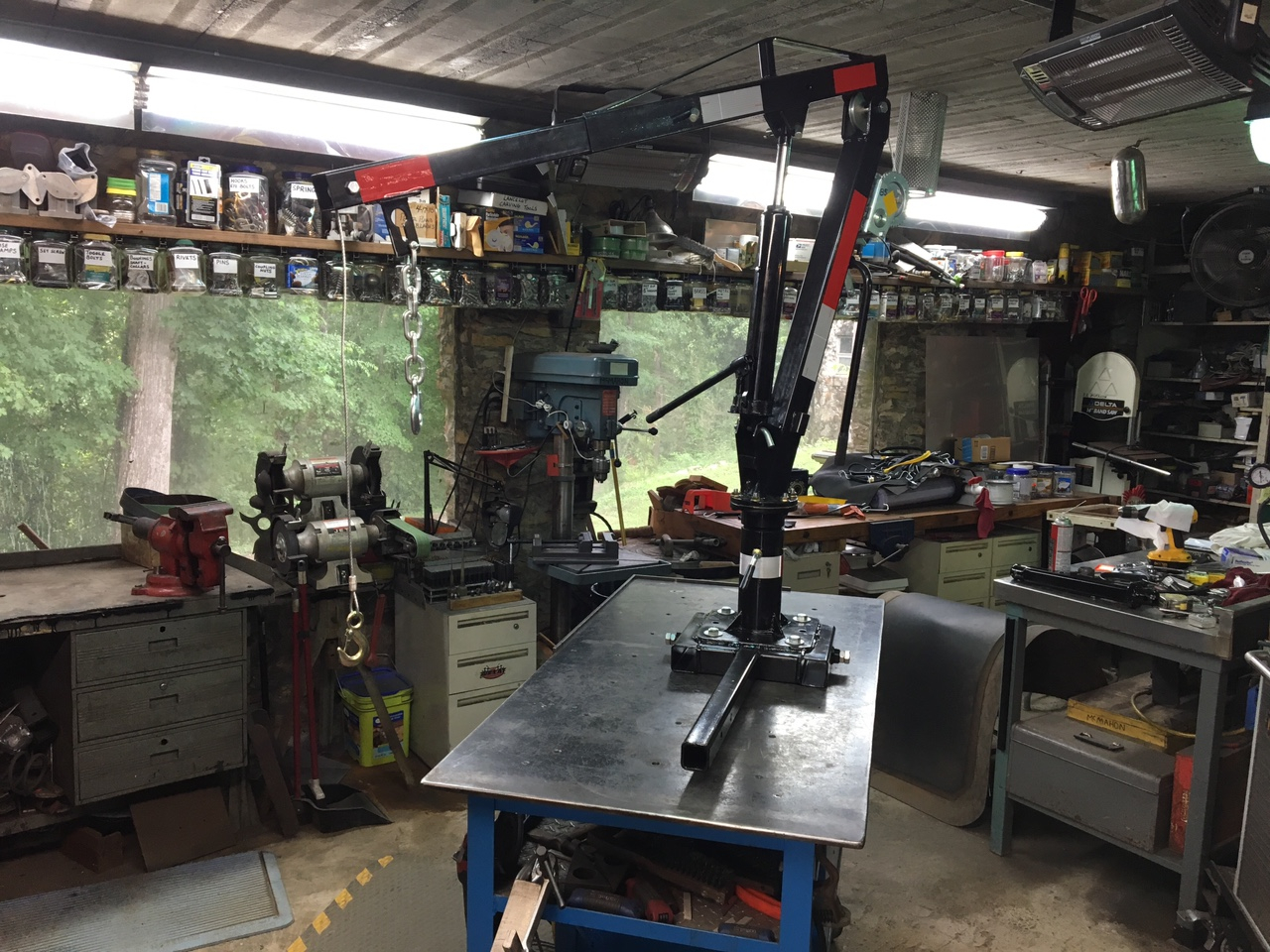

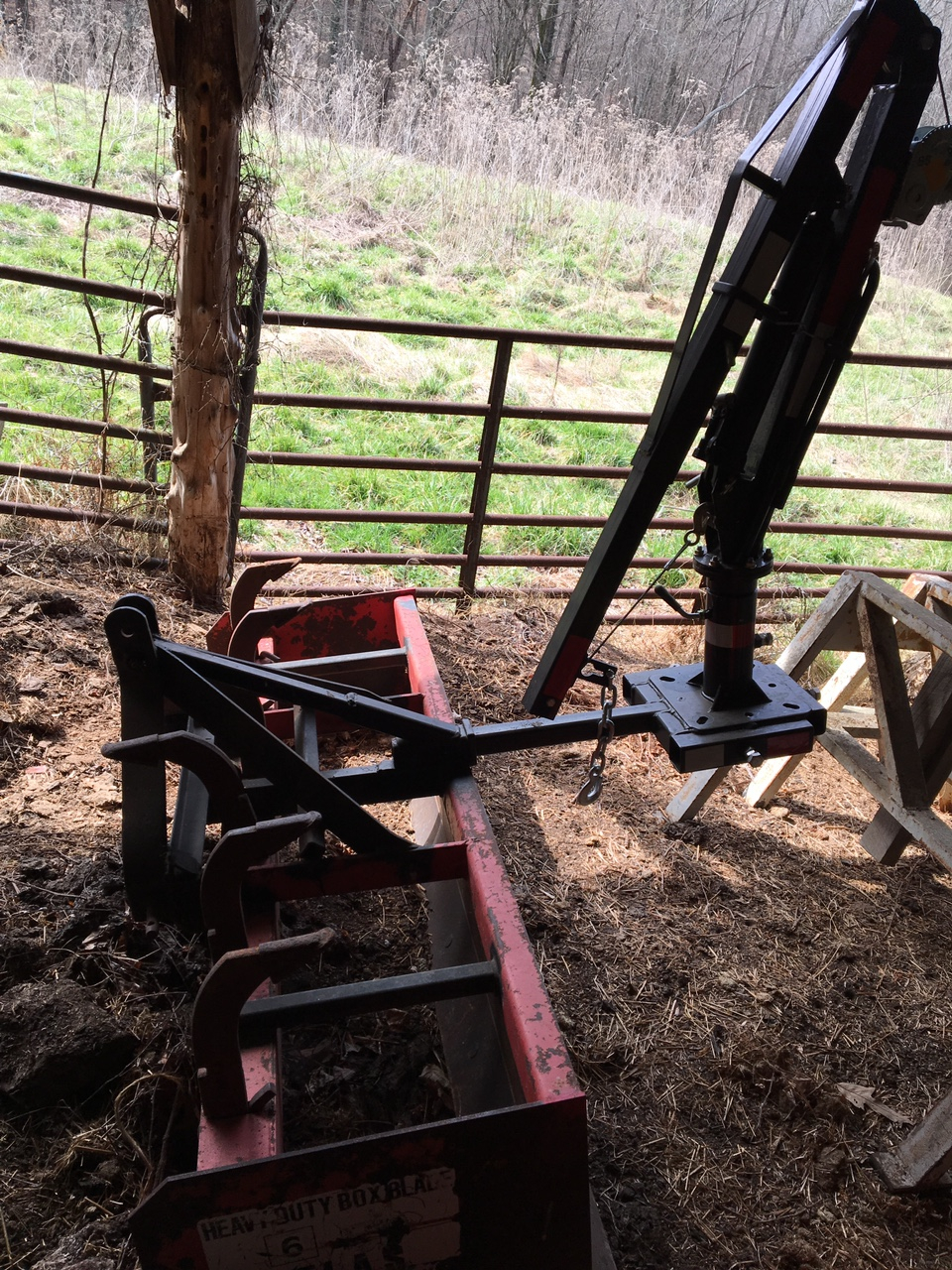

We all need lifting help.
Floor in my shop too uneven for much wheeled stuff. Do have overhead I-Beam hoist to use in just a little part. Have some surplus I-beam chain lift, chain travel hoists if you need.
Use several 2” receiver style hitches around the shop to mount various equipment to best utilize floor space. Modified a northern tool crane to utilize the hitches too. Can bolt the base down to the heavy welding bench which it on casters.
Have receiver hitches on tractor buckets and attachments.
Few little modifications makes it easy to break down to move with no piece weighing more than 38#. With cable winch, hydraulic arm, 360 rotation, adjustable outriggers goes where other cranes can’t. Used to dress a deer, loading heavy treasures in truck to bring back home, to handling/supporting long steel stock. Cost $150 on sale years ago. Have a design in my head for a shade tree mount that hadn’t needed yet.

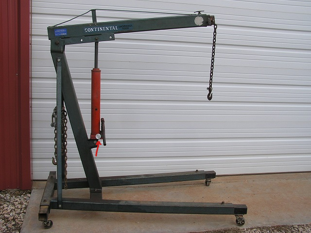

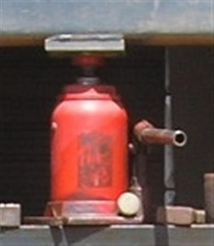

Yep, good idea. My shop crane metal knob:
My shop press plastic knob:

Do you remember the thread size for the knob-valve?
The videos I saw on it, the knob wasn't threaded. They pressed out the cross-pin in the cylinder valve stem, found a knob that would fit over the stem, or drilled it out to fit over the stem, slipped it over the spot where the cross-pin was, drilled a corresponding hole where the old cross-pin was, then pressed the pin or a new roll pin back in, holding the knob to the valve stem.

The videos I saw on it, the knob wasn't threaded. They pressed out the cross-pin in the cylinder valve stem, found a knob that would fit over tGhe stem, or drilled it out to fit over the stem, slipped it over the spot where the cross-pin was, drilled a corresponding hole where the old cross-pin was, then pressed the pin or a new roll pin back in, holding the knob to the valve stem.
Got it - thank you!
