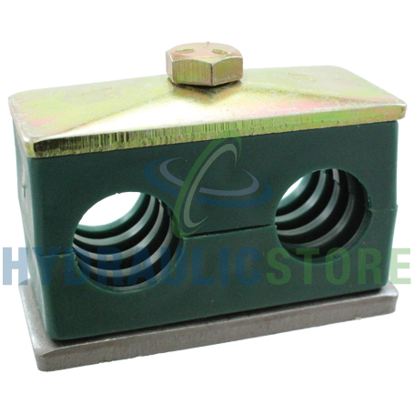

I'm surprised no one makes a bolt on hose clamp mount from what I've found.
You can use the weld on clamps, but discard the weld plate and drill/tap the loader for the bolt.
Excellent plan. I ordered those figuring I'd rig something up. Now that you confirmed my suspicion, that is MUCH easier than I originally feared.

I got 4 of the weld clamps to control the hoses. I'll be abandoning the bottom plate and drilling/tapping the loader.
Now I just need to figure out how to drill/tap the loader tower as there isn't too much clearance. I do own a right angle drill, I just hope I can keep it relatively square.

Most loader tubing isn't real thick - for that reason, if you're gonna tap for your hose clamps I would consider -
Assuming your hose clamps are 5/16" (the ones I use are), NC threads require an F drill (.2570"). NF threads require an I drill (.2720") - in thinner material, NF threads give more holding power which is why I recommend using 5/16-24 (NF) bolts.
IF you first drill using a 1/4" bit, you will be able to see how much metal thickness is there - if it's less than 1/4" thick, I would go with NF thread bolts - for example, 3/16" thickness only gives you a bit more than 3 threads in contact using 5/16" NC bolts, while 3/16" using 5/16" NF bolts gives you 4-1/2 threads in contact.
The EXACT method above lets you see how thick your loader arms are WITHOUT committing to coarse or fine threads, since the 1/4" bit is smaller than EITHER of the CORRECT tap drills (assuming 75% threads)
I'm probably a bit more **** than some, but in my experience it takes a fair amount of torque to keep non-bending sections of hose snug and straight on loader arms so I opt for all the help I can get.
Your choice, my advice is worth every penny :D ...Steve

Steve,
Your advice has been more than appreciated throughout this whole project for me. You bet your bottom dollar I'll be following along and finding some 5/16-24 bolts tomorrow and starting with a 1/4" bit.
I was wondering how well the single bolt would work to hold the hose clamps. If it proves to be a failure I can always resort to welding or drilling a second hole through the plate and the loader arm for a press fit pin to prevent rotation.
