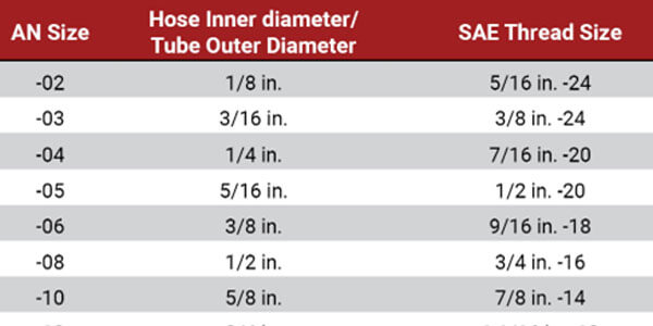

Adding this chart of JIC sizes
/ Replacement hose 3510 ML112 Loader hose? #5
That's the standard sizes, but often a certain hose size will come with a different size fitting.
Yeah, lots of confusion. If someone doesn't know for sure, I'll probably start ordering some hoses and adapters, trial and error.

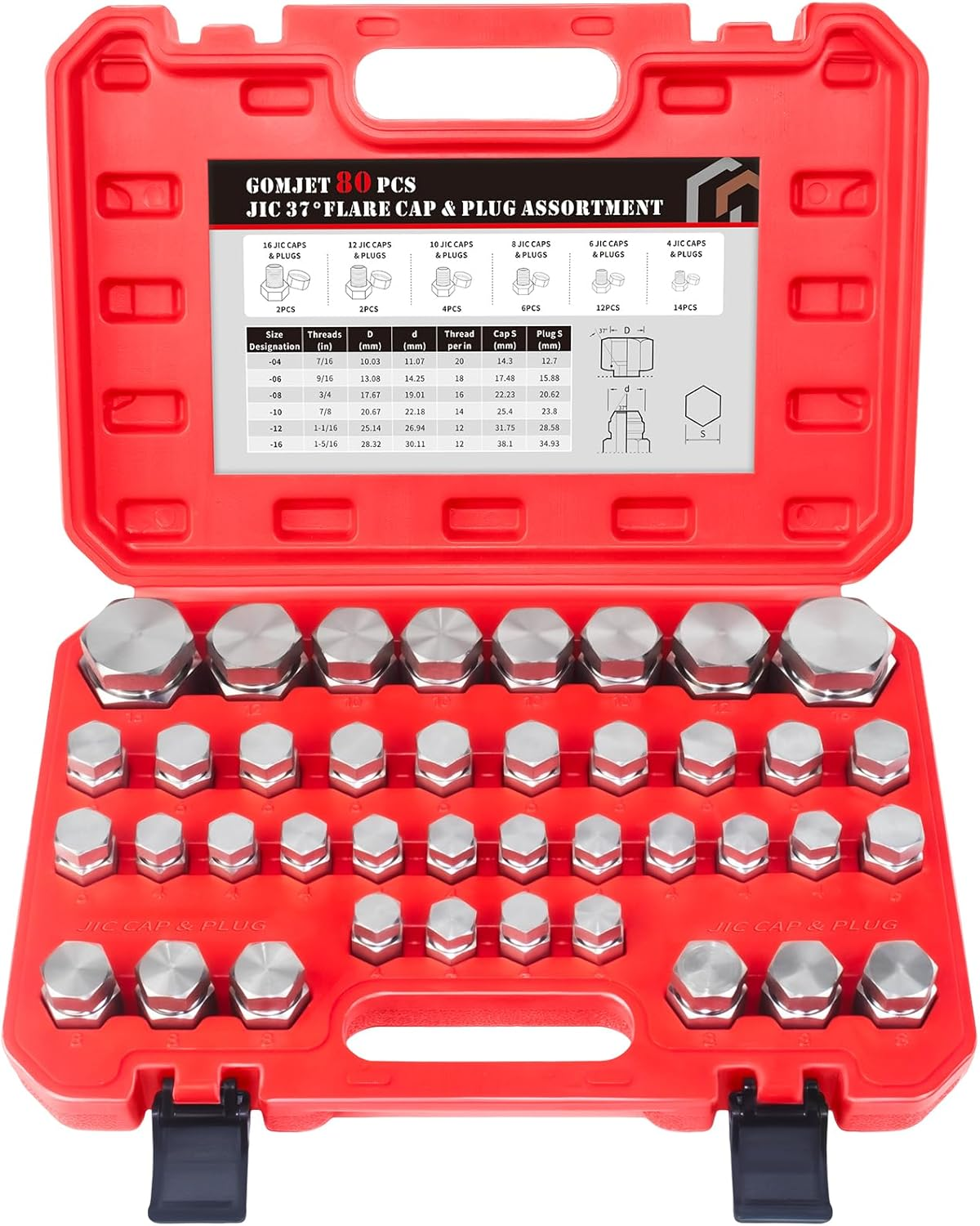

I ordered this kit to help identify JIC now and in the future.
Added benefit is ability to cap or plug lines or fittings, such as when taking hoses off to get made up or identifying, etc.
Anyone else use something like this?
https://www.amazon.com/dp/B0D2MNWBRY
