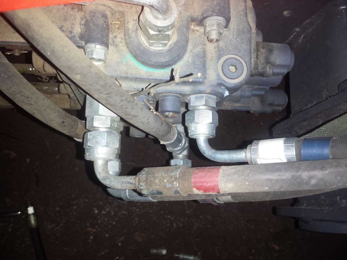

I'm getting ready to do a diverter install on my Kubota L45. I plan to break into the bucket curl.
I'm stumbling on 2 fittings.
Here is what my curl function looks like at the loader valve:
I'd like to replace those fittings with JIC elbows. Does that look like -8 ORB? I should be able to use a standard elbow on the right hose, but the left will need a long or extra long?
Here's the shopping list I have so far:

Those look to me like short and long orb-to-JIC adapters, if you use straight hose fittings all you should need is 90 deg. JIC elbows... Steve
/ Diverter Sanity Check
Oh, you think that thing on the left is just an ORB extension? Do you think I am right in that they are -8 size?

Hard to tell without a known reference visible in the pic - download this
http://www.discounthydraulichose.com/v/vspfiles/downloadables/thread_guide.pdf
Then set your loader down, shut it off, wiggle all the levers several times and loosen the hose enough to get a caliper on the male threads (and look at the inside, should be beveled) - If all you need is to tie into those two ports, it doesn't really matter what the OTHER end is as long as you have two JIC's to hook up to.
I'm assuming you're gonna tie those two ports on the valve to your diverter's inlets, return the normally open outlet pair back to the loader curl, and the two switchable outlets to your grapple (or whatever's new)... Steve

I was hoping to replace those fittings with elbow fittings so I can use standard hoses. But it just dawned on me I can just use JIC female to JIC male elbows to accomplish the same thing. DUH!
What you describe was exactly my plan.

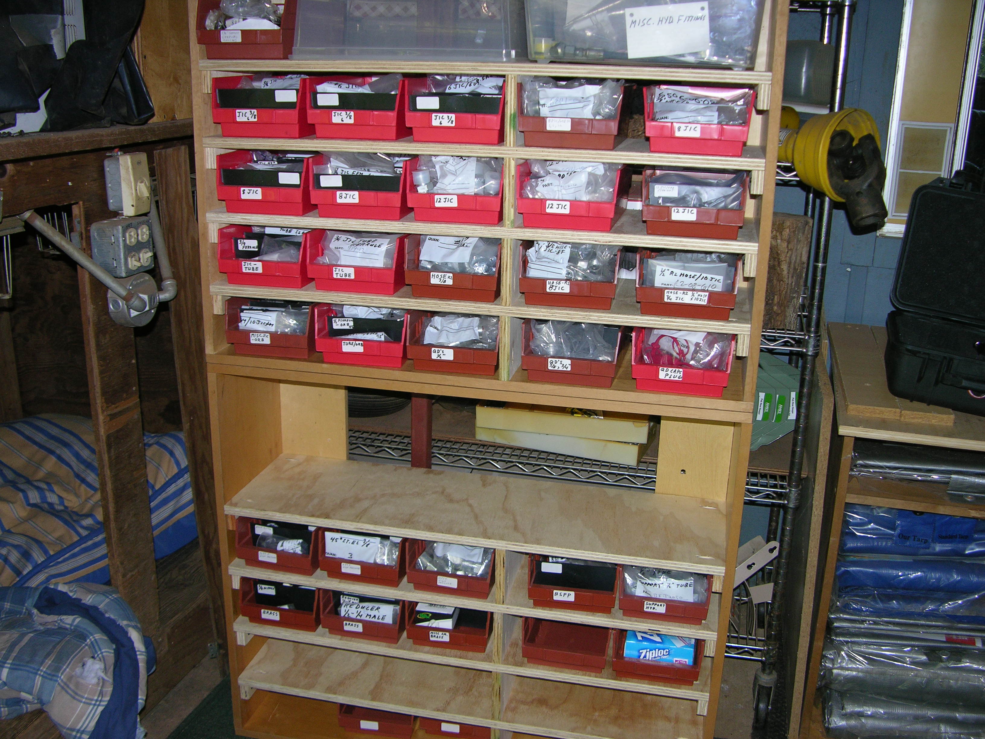

BTW, this is about half the hyd. fittings I have (3-4 sections per bin; 2 tractors, backhoe, 50' manlift, 26' scissor lift, dump truck, etc, projects slated for ALL of 'em... (did I mention that DiscountHydraulicHose.com LOVES me? :D

I would check to make certain that those fittings are actually 37 degree JIC flare and not O-ring face seal fittings (ORFS). The swivel nuts don't look like like JIC 37 degree to me.

I think I definitely need to crack open both ends of the hose and take some measurements and make 100% sure of what I'm dealing with. It looks like all of the hoses are 3/8 so I might as well stick with that, right?

I pulled the hose off both ends. You guys were dead right about the loader valve. Those are flare adapters in there. Perfect! I measured the thread OD at .74. Looks like -8 to me! The hard line is the same on the loader so it looks like I just need to finalize my hose lengths and I know exactly what to order.
Looks like I need to pay attention to the ports on the valve to make sure I get the flow right.

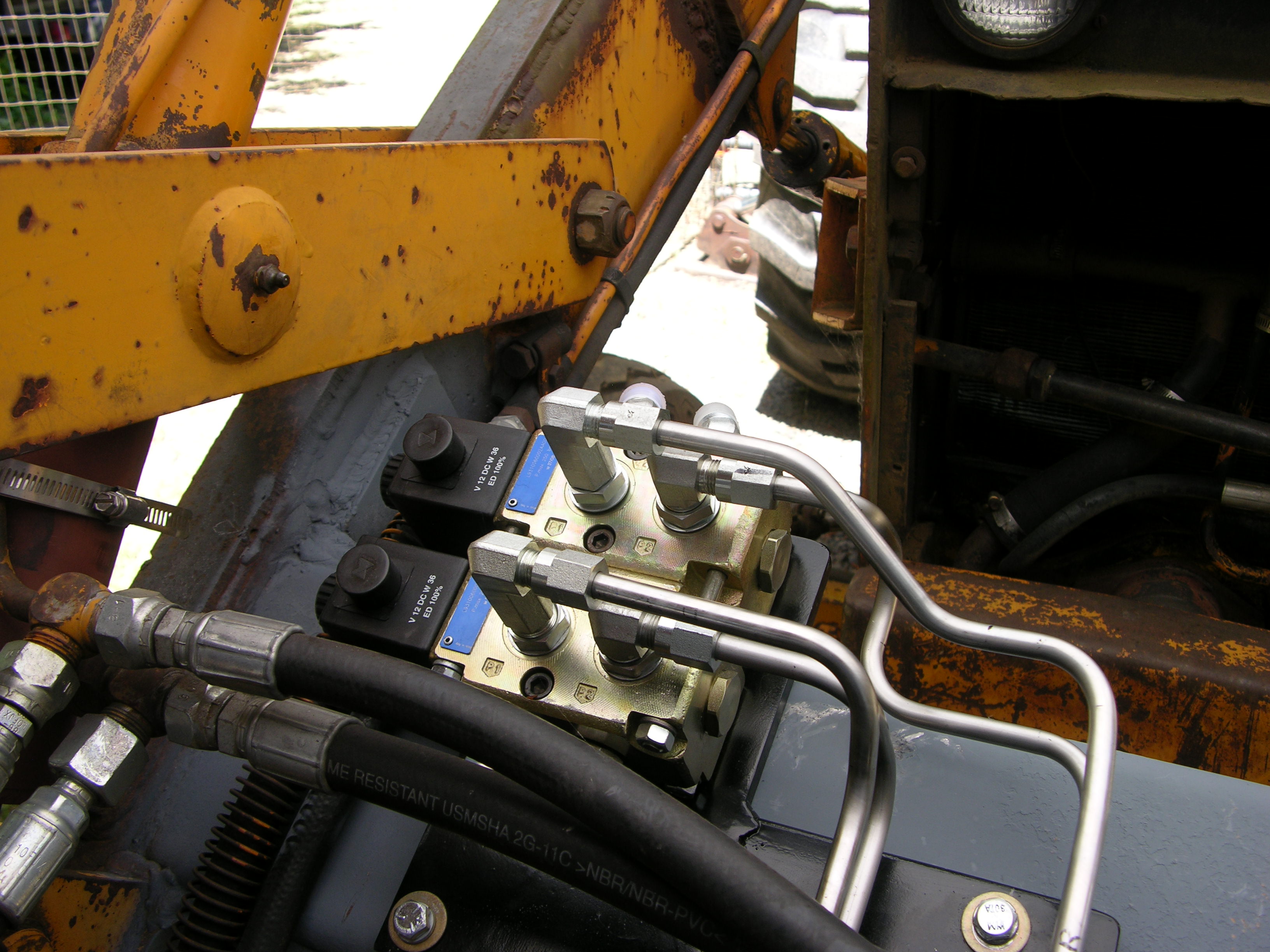

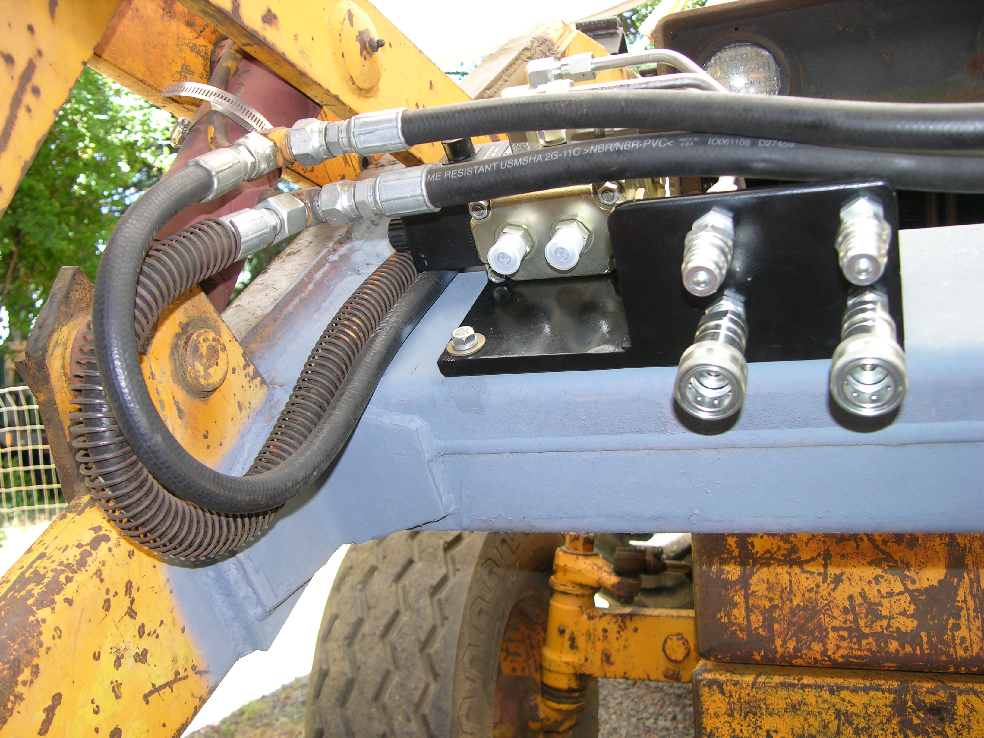

You have the same basic valve, different source - the mistake I made was paying more attention to where the solenoids sat than which ports were in (P1 P2) and which were normally open ( C1 C4) - After custom bending stainless tubing, custom valve/QD bulkhead, etc, I discovered the error which would have made hose routing really ugly. Scrapped the whole thing and will re-do it after I get all the leaking cylinders kitted (6 more to go)
You can see by the pix that I probably wasn't too pleased when I saw the mistake :confused:
