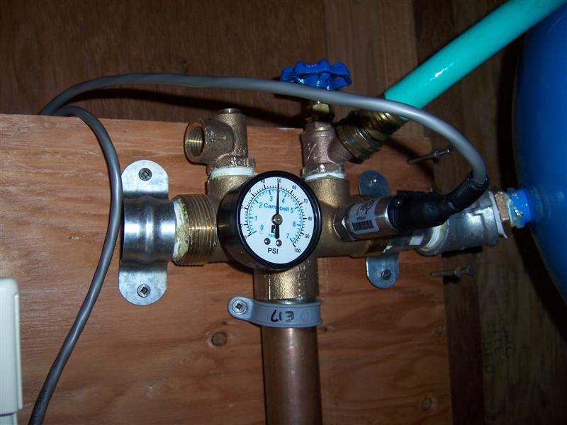

well i needed to get it done and decided to go with the ditchwitch 1330 based on availability. the cost was 140/day and i needed it. 450' of trenching with several breaks to backfeed the chain and also hand dig out rocks, it really was miserable and i swore alot but it's done and the trench is 18" in most places, some deeper. I discoverd a frenchdrain and another perferorated drain line that runs paralell to the house. A bit annoying but not a big deal as I had a length long enough to make the repair.
So I have the water line in, the power run, all the plumbing in place and all the pump/controllers for the new well. As of yesterday at 2pm I had water running from the new well through the new tank and out a garden hose. This was a major accomplishment. Today I tied the water line into the main house line splicing into the old well line (keeping as a backup for now) and all tests were good, ran 2 faucets wide open, the shower, the sprinkler and flushed the toilet without noticing any drop in pressure as each one came on. The best part of all of this is I no longer have to haul water during the dry months.
The real highlight though was finding out well is actually producing more than 25gpm which is 2 1/2 times more than the drillers rated it (they used an air rotarty rig to drill and the only way for them to test it is to blow air down the hole and determine how much water comes out -sorta kooky, but ok). So I asked my pump contractor to do a flow test with his pump and they ran it at 25gpm for several hours and when they backed off to 20gpm the pressure came up. What a blessing!
I took a ton of pictures of the whole process and will post them as a seperate thread once I get a chance. I did attach one of a shot of the trench from the wellhead, the pump house is up there in the shade, you can almost make it out. The other is of the pressure reading as I flipped the switch and started pumping. It was a beautiful thing.
