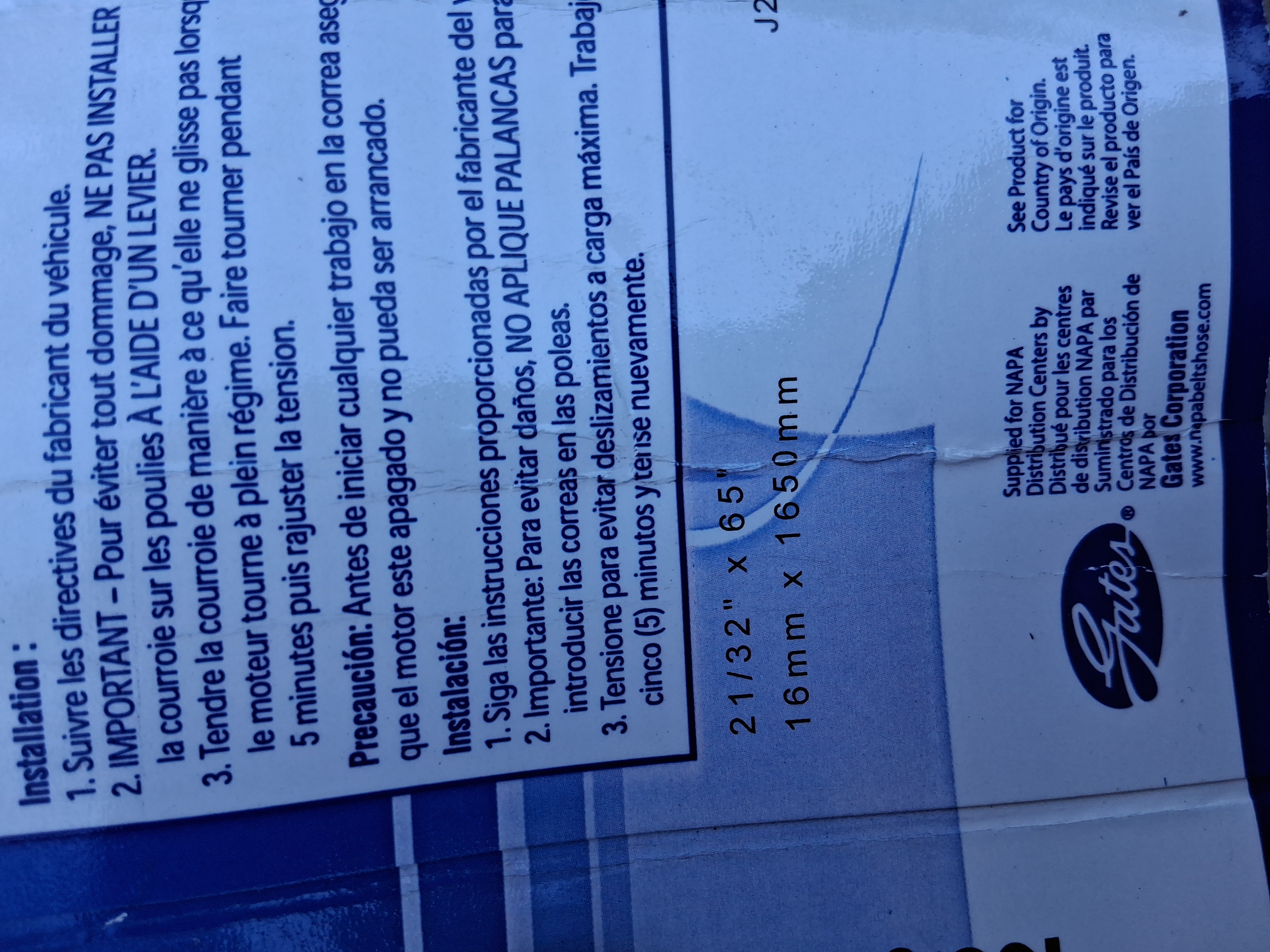

More info - The drive belts on the trencher were old as the hills, so I went to the friendly folks at my local NAPA to find some new ones. They measured the old one out at 65 1/2 inches, and we figured that it was stretched a little bit, so I got a B62 (65 inch) belt. It fit fine. See photos for NAPA belt part number, etc.

   / Ditch Witch C99 #219
Making progress. Got a working carb on it yet? Planning to run it with just one belt? Interesting experiment. Looking forward to hearing how it holds up. I do hear that Napa puts out a quality belt.
   / Ditch Witch C99 #220
Got the new carb and got it running Sunday afternoon. I'm waiting on a few new parts that should be here today to bolt it all back together and lube everything that I can lube and document what I did. NAPA only had 1 belt in stock, but I paid for 2 more and they will be in today. Apparently, Gates makes the NAPA belts, at least for my favorite NAPA store. More to come!
