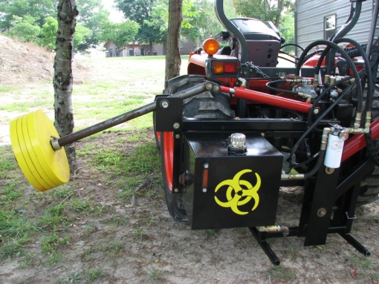

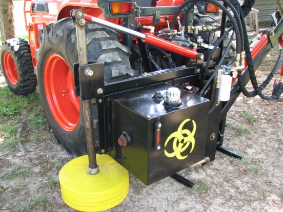

Counter weight is very important with mowers such as these. My Bomford/Turner mower is on a 90 hp tractor FWA with about 1300 pounds of counter weight on the nose, plus it is running dual rear tires. It is nothing to stretch it out backwards and pick the front end up off the ground four or five feet!! The duals help with the side motion and lean in that direction, but even with a monster sized tractor, you still know it is leaning that way.

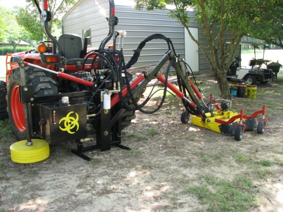

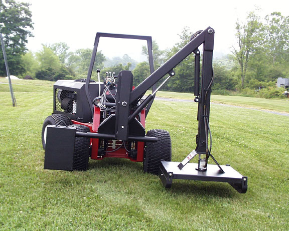

Hi Guys, I made a change to the counter weight that allows it to pivot down when not in use. I added a cylinder and valve that will raise and lower the weight as needed. I was like some of you and didn稚 like it sticking straight out without any mobility. I don稚 have any pictures of the change but when I uncover it I will post some.

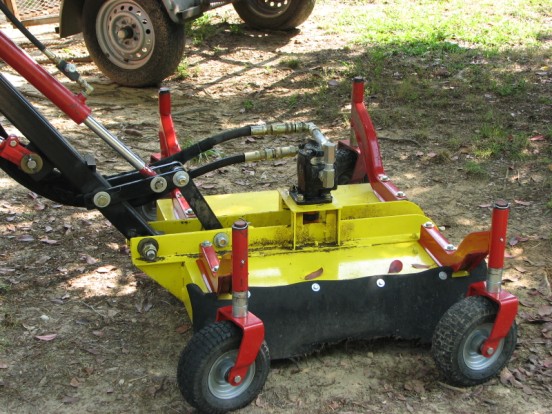

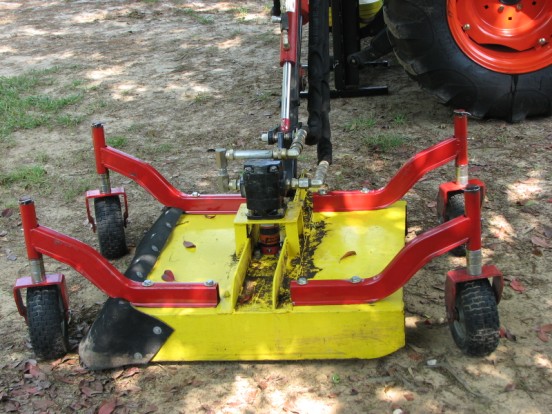

There is another change I will be making and that is adding wheels to the deck. They are swivel and much like another poster here used on his bank mower. I think it will be much easier to control a mower that rolls vs. one that is trying to follow contour with operator controlling every move.
Joe

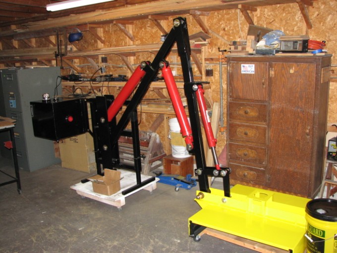

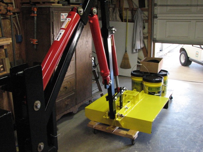

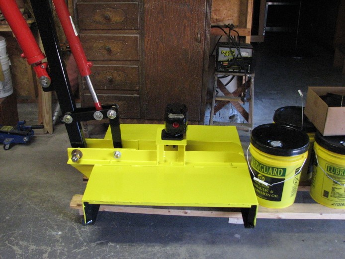

Hi, I wanted to post some updates to the ditch and bank mower, most of this is your suggestions.
One of the main problems I tried to address was a way to raise and lower counterweight.
Changed from a rigid, straight bar to a hydraulic cylinder to move weight out of way.
Added casters to the mow deck, this really makes the deck easy to control.
Thanks for all your ideas and keep the new thoughts coming.
Joee

/ Ditch & Bank Mower Build #47
Joee,
What you have created is an absolute masterpiece.
We have a similar type of machine that we bought, it is a bit old, but it does a good job. It is the flail type machine Densleigh mentioned.
I think it is an exceptionally versatile attachment, and use it for lots of things. I hope you get much use out of yours.
/ Ditch & Bank Mower Build #48
Awesome job. This is my first post to an awesome site. I live to fab and McGivor stuff like this.
What if you were to put on parallel linkages like a self leveling loader so that once you set the angle it would be maintained while moving the mower. May make it more user friendly. The counterweight cylinder could be attached the same way so it moved out as the boom went out. Just as long as a guy watches both sides as he mows :) or else ;-( LOL
Also having the mower "hang" from a chain or slide mechanism to help it float.
Looking forward to reading the many more awesome posts and hopefully contributing some useful info or pics.
/ Ditch & Bank Mower Build #49
If you slam that mower into something and bend one (or more!!) of the wheel assemblies, next time try a single roller on each end. They take up less space, take more abuse, don't require filling up with air and don't go flat. Steel rollers work better, but plastic is lighter (and burns better;btdt)
David from jax
