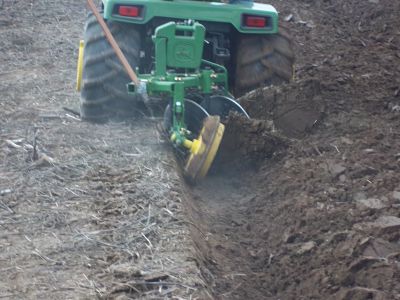

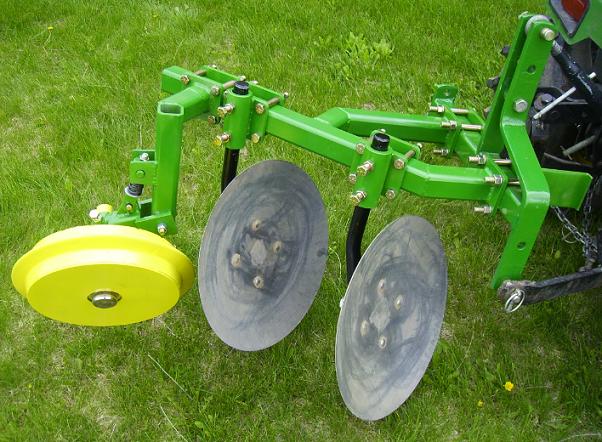

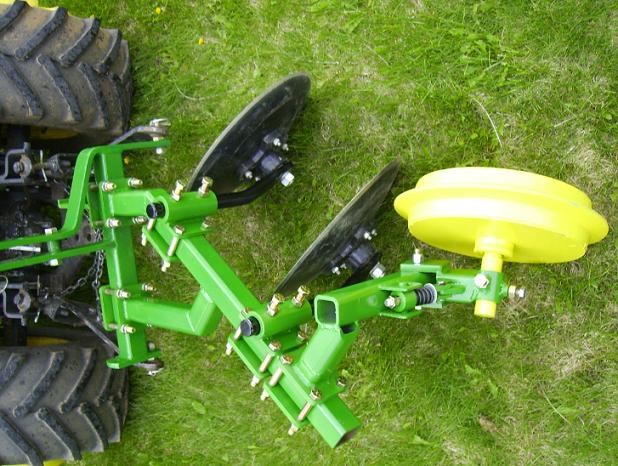

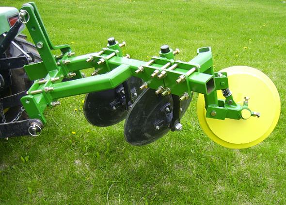

Depends how bit the disks are, I pull my home made disk plow with a 16hp garden tractor....
