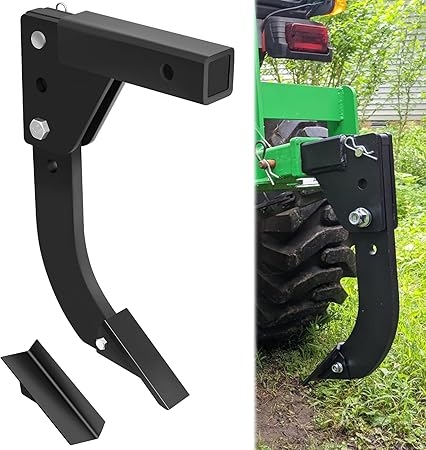

What about a subsoiler? You'd want to weld up something to offset it to one side.

I'm envisioning a disc that rotates, attached to the side of a bucket, so that when lowered and driven along, it makes a cut in the ground.
This would be to install edging, to keep a mulched area separate from the lawn, so I would want to go approximately 3-4" below grade.
Firstly, is there such a thing commercially available? I've done some searching but have no idea what it might be called. The closest I've found is a "pipe layer", but one key factor is that it needs to be at the side of the tractor. Between my son and I we could probably modify something if it was out there.
If not, any ideas/suggestions as to how one might be made? I have immediate use to install about 300LF of edging, and a lot more in the future, and don't look forward to doing this all by hand.
Our local fiber installation company uses a vertical knife attached centerline behind their tracked tractor. You would have to modify and install it side mounted but the knife is about 18 inches long.
