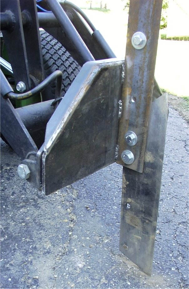

The plow coulter mentioned in post #8 could work, or even an old lawn mower blade or piece of 1/8" X 2"-3" flat stock that is heated to give it a slight twist to widen up the slit/slot to drop the edging in ... Bolted/clamped to the side of the bucket ...

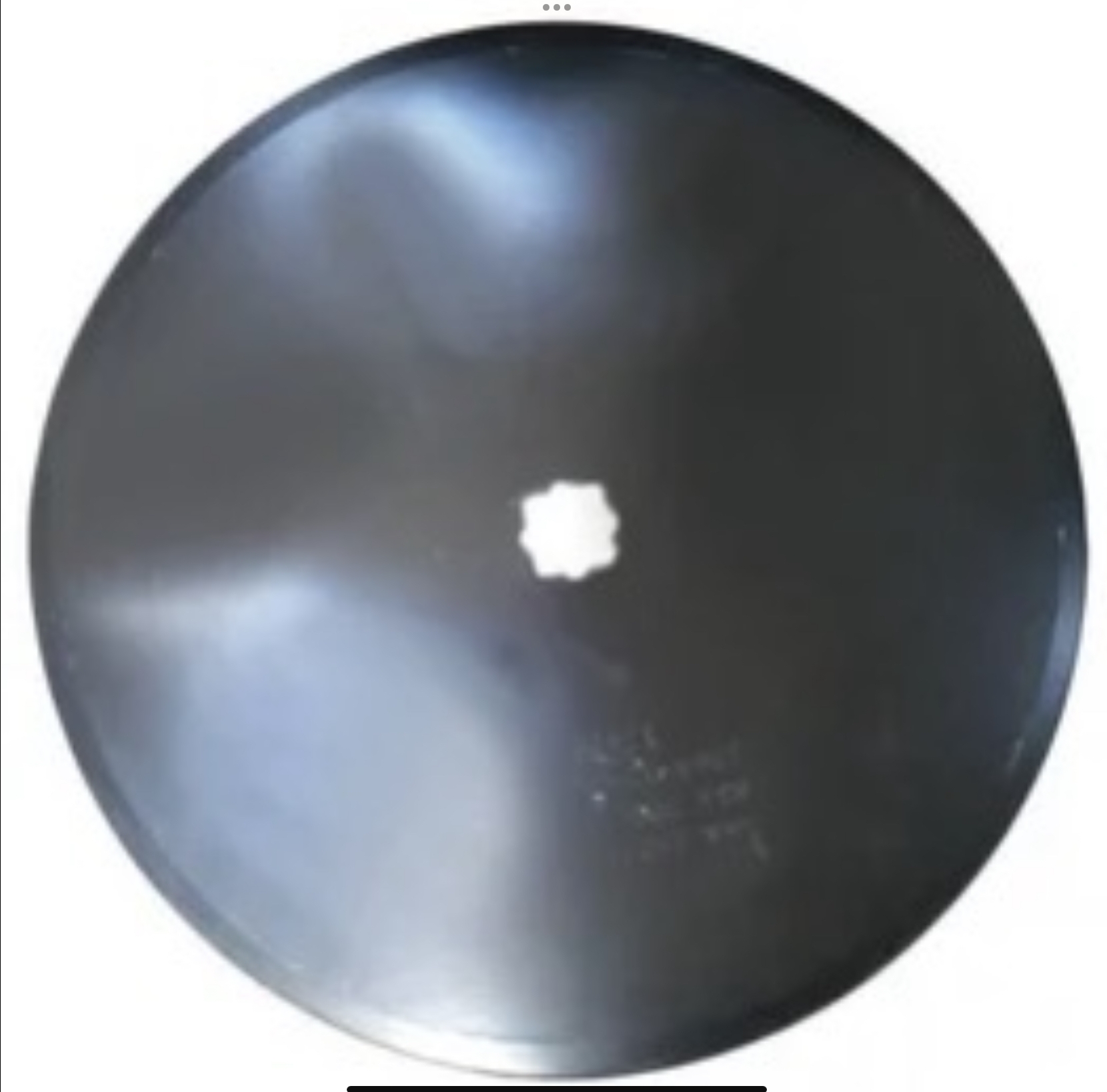

A smooth disc blade similar to this is concave. It might open a nice V to one side. It might totally remove your sod! 🙃 I do not know. But it might be worth looking at them at your local AG supply store. I'd imagine it on a rolling axle parallel to the tractor. You might be able to clamp something to your FEL bucket, or some mount on the rear that would stick off to the side. I'd guess visibility would be a main concern so you could see it as you maneuvered through the area.
The problem I see would be is sliding to the side as you turn VS following a straight line. But if it just pushes the sod to one side, you could install the edging and remove the sod on the opposite side.
You could control depth with a gauge wheel and put weights on it so if floats independently from the tractor.
If I were to do it on my machine, I'd use a gauge wheel, barbell weights on a post, and mount it to my FEL quick attach and let it float.

It's called s pizza cutter. Used them for many miles cutting edges on pavement. Most generally on the end of a grader blade as you could control the accuracy in any direction. Also used one on skid steer or loader for cutting slot in ground to bury the bottom edge of silt fencing.
A plow Coulter would do your job and I'm sure it would be a lot cheaper than the heavy duty ones we used on road jobs.

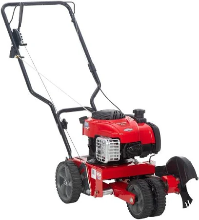

I'm in a similar boat. Inherited a house with a paved driveway completely obscured by grass. A lot comes up by hand, but the edges are undefined and impossible to cut thru with a hand edger.
So I picked up a cheap, used gas powered edger. Had to get a larger blade and haven't had a chance to use it yet. My expectations are rather low...this grass it thick!

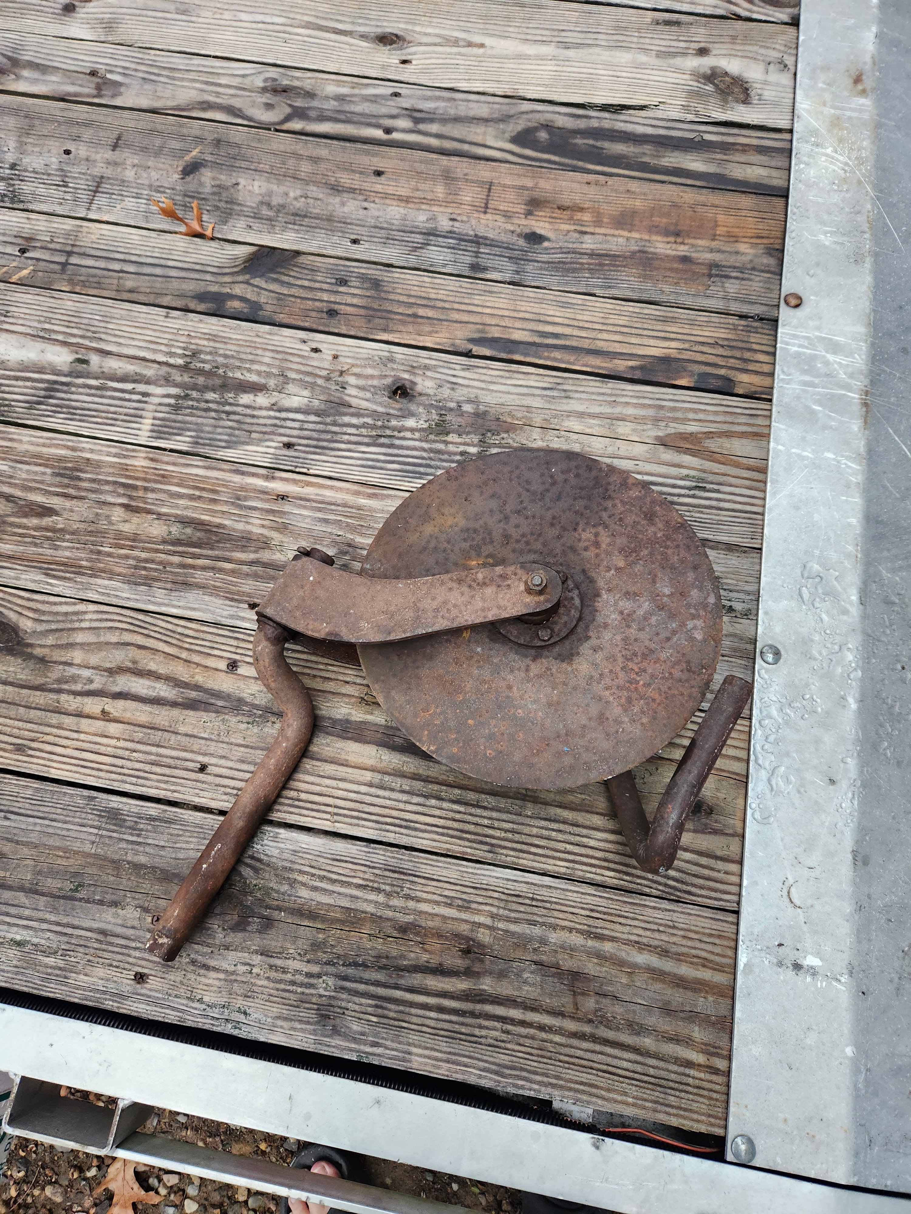

I came up with a plan to mount an antique, straight bladed coulter somewhere, somehow on my JD955, probably the bucket. But the coulter I think I have is 3.5hrs away at another property. It's beginning to look like a winter project....

I had great success with the gas powered edger and might not continue with the coulter project.....but I did grab it out of storage this weekend and, well, it might still happen.

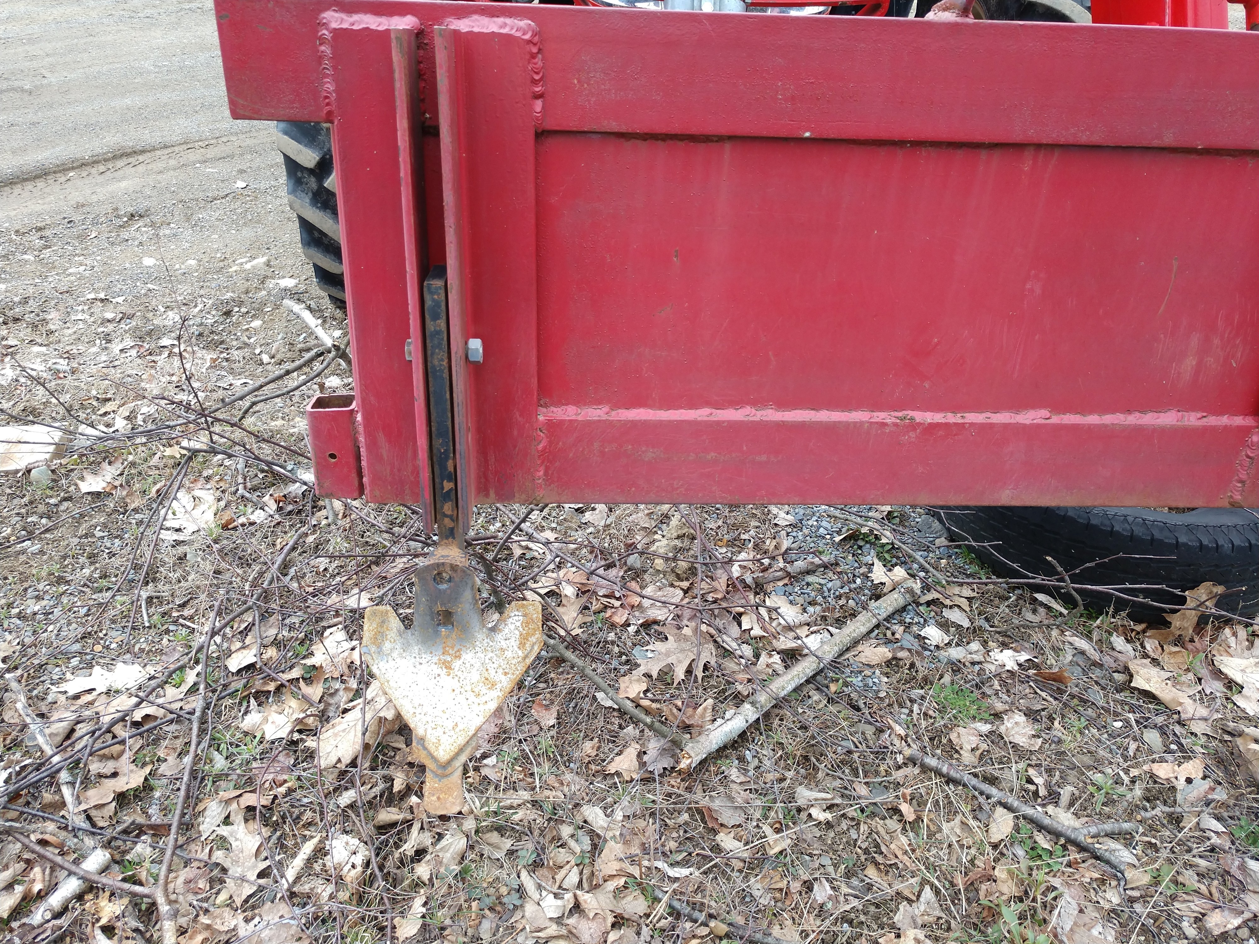

I have a shank mounted to a ssga plate for ripping trenches across my driveway as water cuts.
This has a cultivator sweep added to a ripper shank as I wanted a V shaped ditch. Without the sweep it was just a narrow slice.
