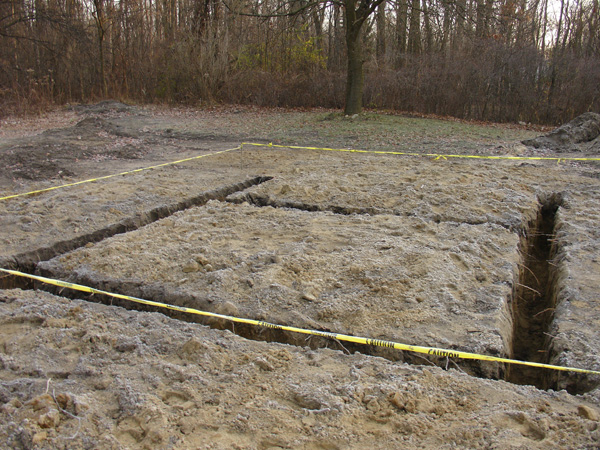

For a slab on grade the problem with digging the beams before putting up the forms is that the stakes that hold the forms tend to cave into the beam ditch when you drive them in. I have seen it done however.

In 30+ years of construction I have never seen footings intentionally dug after the forms are set.
For monolithic pour... Dig footings, set edge forms by hanging form from vertical stakes, brace and line form by "kicking" additional stakes at apx. 45 deg. angle back to bank, use shovel to clean footing prior to setting re-bar, pour concrete, remove vertical stakes from footing before concrete sets up.
Stem walls... Same as above except add another form for the inside face of the stem wall and add U-shaped "jacks" or "scabs" in between vertical stakes to keep form from spreading while concrete is poured.
It's not hard to do. It's is not easy to get it right either... Concrete waits for no one! So make double sure the forms are where they are supposed to be and at the right elevation before it gets there. Oh yeah, if you are not vibrating the concrete tap the forms with a hammer or whatever to get rid of the air pockets "honeycomb" against the form.

Like Eddie said, if your talking about the lower footing; My concrete guy backhoed out the ditch to full depth then just cleaned out the bottom with a flat shovel ( not much digging at all). He then set 2x10 or 12's to make the bottom forms. Then he built the stub wall forms right on top of the footing forms, added re-bar and did a two stage pour one right over the other.

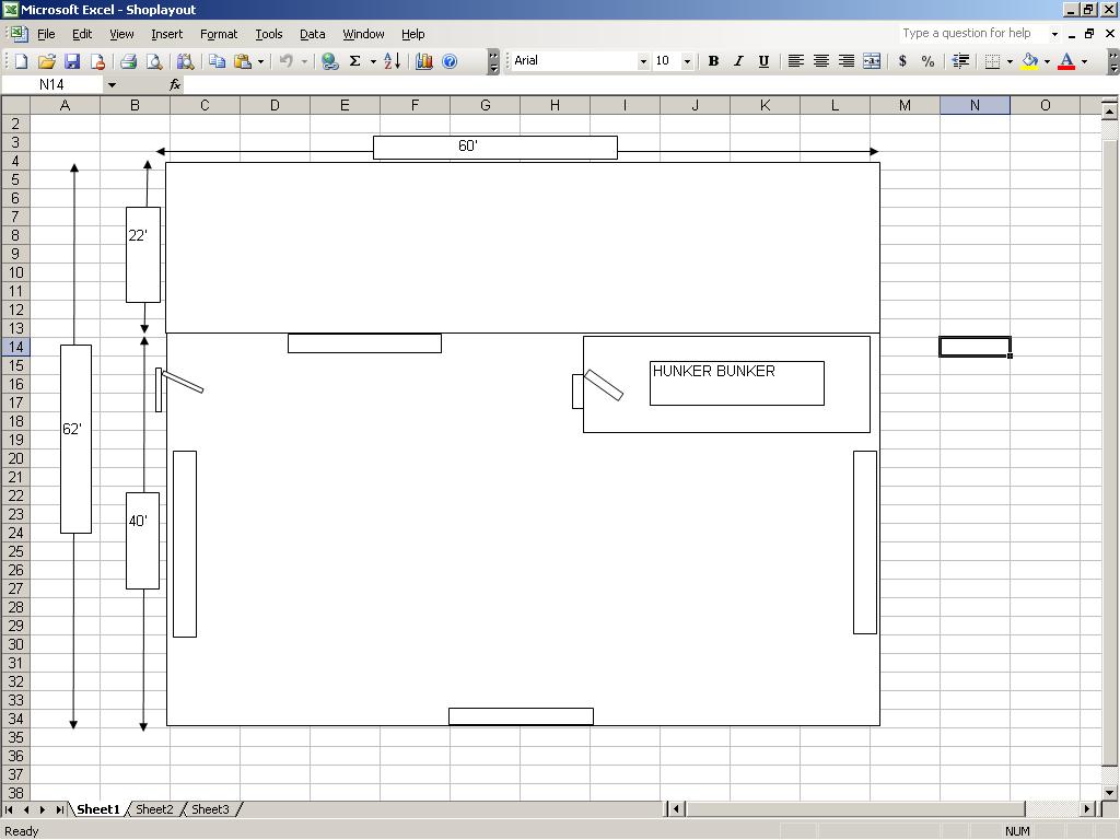

I should have stated that I am putting up a 40'W x 60'D metal building/shop with either 16 or 18 foot eves. Along one of the 60 walls will be a 24 wide lean to. The overall slab will be 64 x 60.
Here is what it will look like, or so I hope :eek:
If I dig and pour the footings/beams flush with the ground first then set forms, bring in sand rebar etc. would the slab adhere properly to the footings or would one want the slab to float on beams? A monolithic pour means footing slab all one continuous pour right? This type of prep and pour would seem to be more difficult. I do plan on cross beams as the engineer suggested/
I hope KHD did not mind of me showing his pic. it is what I had in mind;

I have a civil eng. Neighbor who is drawing up plans required for the city permit he indicated he would like to go down to virgin soil meaning beams would be ~2 deep and 18 wide (width of my B/H bucket). Purchasing a smaller 12-14 bucket may be justified to save money on concrete? A friend offered to have his engineer perform a soil density test, a backscatter test was done and compaction came back greater than 95%. The fellow who has to fill out all the documentation took an unexpected leave of absence and do not know when he is coming back. Should have know it was too good to be true to get this for free so I may have to pay someone in order get the project going again.
Thanks for help and patience. Chuck.
