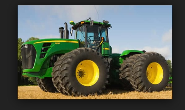

Back in the heyday of large 4WD tractors besides articulated models that pivoted in the center some manufacturers built "crab steering" where both frt & rear wheels steered similar to MFWD frt axle.
Neighbors run this Beast.

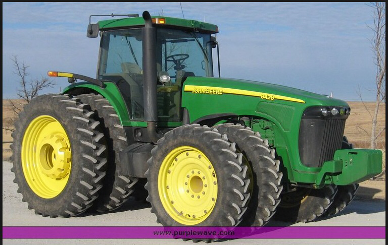

John Deere introduced the PFWA (power front wheel assist) on the 4020 and 5020 in 1966. It was a hydrostatic front wheel drive they advertised as being able to supply 20% more traction than the base 2 wheel drive models. They were a major improvement in performance but reliability left much to be desired. Since the idea worked well it evolved into the MFWD (mechanical front wheel drive). Note that the new terminology changed assist to drive partly to differentiate the improved capability of the mechanical front wheel systems. So today's system is not true 4WD like an articulated version (which are seldom 4WD anymore - mostly 8 or 12 wheel drive). Still on the MFWD tractors you mow see a lot with duals or triples all the way around on the high horsepower models. Like the farmer who was a bit upset with the police in a New England state a few years back. His tripled Case Magnum helped him roll right over and crush something like 8 city vehicles.
