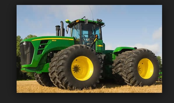

/ Difference Between 4WD and MFWD ? #16
As stated above in the AG world this is a 4WD
