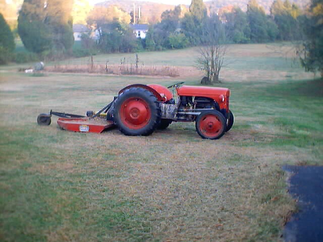

My old 48 Ferguson TE20 never needed 4wd/MFWD, if the rear wheels started to spin I just raised the plow a hair higher :D
It was a great tractor and worked very well for being 50+ yrs old.
To add to the above mentioned Ford/Ferguson partnership Ford-Ferguson Tractors during the 1940s
