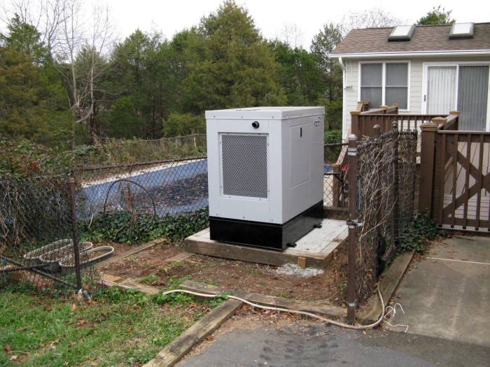

"Yup - that is all it is. The wall penetration works well with an air gap of about 3/4 all around the flexible exhaust - which is held in place radially by three screws/bolts around 5/16" dia. The exhaust sticks out the other side, bent down slightly, about six inches. The ducting for the radiator fan has an outside door that is closed when not in use and latched open for running.
