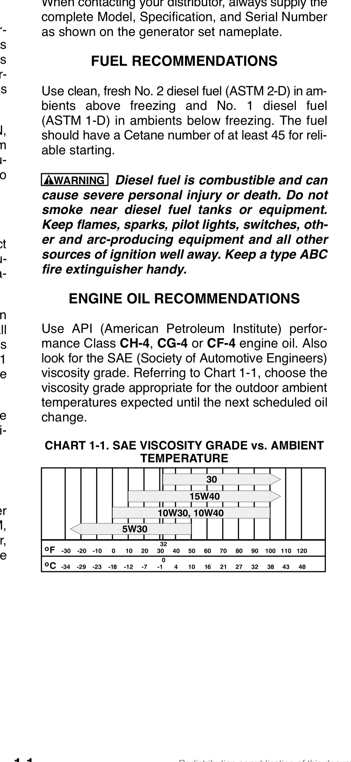

Hello,
I have an 11.5kW diesel (Onan DNAD) genset that powers a small cabin. Made 2004-ish, has 7500 hours on it. I change the oil pretty religiously at intervals less than the 250 hours the manual calls for.
I normally run 10w30 oil in winter, but have slow start ups when it gets real cold (10F to below zero). This is with using blended diesel (50-50).
The manual calls for 5w30 oil below zero, so planning to switch to that - but having a hard time finding something.
I’ve attached the relevant section from the manual. I find 5w30 Rotella T6 that may work, but Cummins says not to use fully synthetic oil. Anyone able to point me in the right direction? Is synthetic actually an issue for this genset? I’m fairly clueless as to API classes, backward compatibility, etc.
Any help is appreciated!

You don't mention any summer ambient temps, but IF you want to stay within Cummins' viscosity recommendations, they are not recommending 5w30 above 50 degrees f.
I personally would use a 5w40, or 0w40 synthetic. If you're concerned about the "no synthetic" thing, I would investigate the source and timeframe of that information.

7,500 hours on a small engine is pretty impressive. Your oil choice has worked for 20 years. Why change now? Did it used to start easy below freezing? If so, what’s changed?
My guess is , the manual states , they “don’t recommend synthetic.” That’s a different meaning than “don’t use synthetic “.
They also spec CH, which was current at the time. You’ll be buying CK with a back spec to CH.

Not so much a knock on synthetics as back in 2004 synthetics were just becoming known and most engine manufacturers didn't trust them and recommended not using synthetics. Then as they started becoming more well known they started saying you can use synthetics but don't use them for the first 50-100 hours because they are so slick they will prevent proper ring seating. Now most engine manufacturers now offer full synthetic in their own brand, and some don't even offer a Dino version.
The "no fully synthetic" actually came from a Cummins service rep, which surprised me since the manual only specified viscosity and API rating. But as you said maybe synthetics weren't much of a consideration at the time it was manufactured.

On the rating story, C_ diesel-oil is fairly straight-forward (vs. the newer classes), and are backwards-compatible.
Oil Categories
On air-cooled applications, there can be a case for Conventional, but I'm guessing that your Onan is water-cooled (?).
Wide-range synth (like T6) are OK by me, but for specialty options, I often end up checking Amsoil.... may be a dealer near you, or they do ship.
Sounds like your biggest problem is staying-Running @ ColdNight.... I'd be tempted to look at something like a fuel-bowl warmer, and see if that makes a difference (infra-red heat lamp, if nothing else, if you can safely position and secure one.... or even just a regular incandescent 100w PAR30 bulb - making up a small cage around it with rodent-grid wire (Home Depot, etc) is one way to prevent direct (fire) contact with the bulb surface).

I'd simply switch the oil to a quality synthetic 5W-40 for year round use.

Outside of break-in issues, the main issue with the early synthetics was seal and gasket leaks. The materials used at the time would not contain synthetic oil and some soft parts were damaged by some of the synthetic oils. You should have no issue using any of the mainstream synthetic blends available today but that unit won't really benefit from the top of the line synthetics vs a blend for half the money, just stay within the viscosity range specified. That unit has a Lister-Petter engine and you will find a lot more info on the Listerengine forum since that's their 'thing'. I would go with the Lister Petter specs rather than the Cummins owners manual as Cummins documentation will lean toward what Cummins has available as long as it will work, but not necessarily the best choice.
