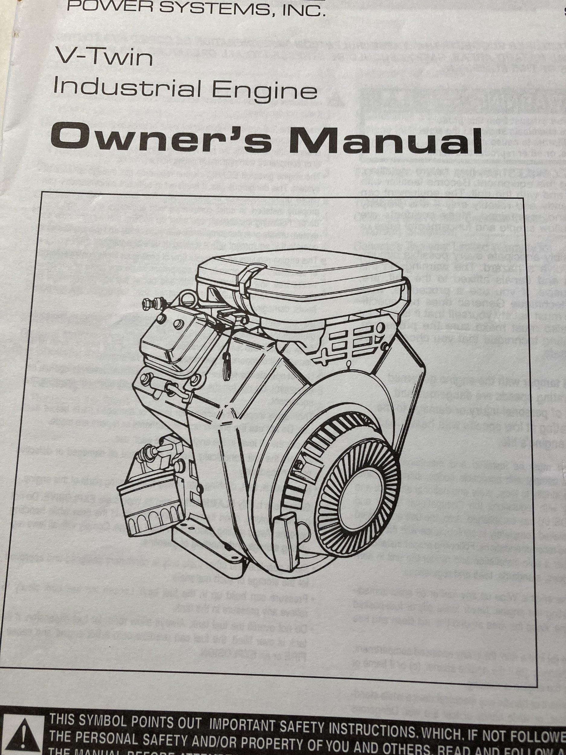

What is the correct oil to use in my 25 year old 19hp, twin cyl, air cooled Generac generator. This is from the old days with higher ZDDP in the oil and I don't want to screw up my house generator with modern oil. The generator has test run more than actual use and only has maybe 15 hours of non-test use. So the rings aren't even seated yet.
Here's my engine, front ID tab and owner's manual oil requirement
View attachment 857278View attachment 857279 View attachment 857280
