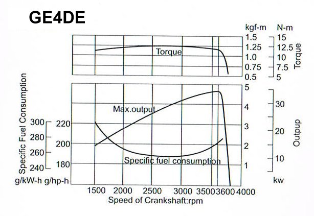

Here is a power curve typical of a CUT or SCUT. There is very little torque backup. Also note the top end of the curve. There is no power output at high idle. Power increases to peak as the governor increases fuel flow to meet the power demand. This is why you will see the tachometer quickly drop when you move, engage the pto, etc. For a mechanically controlled engine this speed drop from high idle/zero output to max rated power is 7%. Tighter governing is available for special applications such as generators where engine speed control is needed to maintain 60 Hz (North America, 50 Hz most of the world). The overrun area can be decreased on FADEC engines (Full Authority Digital Engine Control) found on larger engines.
When you set your engine speed control to maintain a lower RPM, you shifted this curve to the left, at least the RH portion. In this curve, full rated power is 33 kW at 3600 rpm. Shift the power point from 3600 to 3000 and the max power is 31 kW but due to 7% governing, the no load speed will be 3210. Assuming you are operating at this point and you need more power, changing the engine speed control will not give you a boost because there is no torque reserve. Note how the torque actually decreases from 3600 rpm to 3000 rpm.
