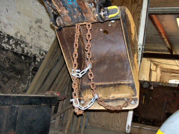

I like the chains idea, maybe 3/8 welded front and back with enough slack to go all the way to the back surface.

I also like the chain idea may give it a try, I think I have an old set of garden tractor chains lying around somewhere.

I found that chains in the bucket work plus I spray the bucket with diesel before I get start wet it down.

After the advice I received and some study of the patent applications I fitted a chain to my bucket. After testing in heavy clay I found that it was very effective in emtying the bucket :) allthough not 100% effective!

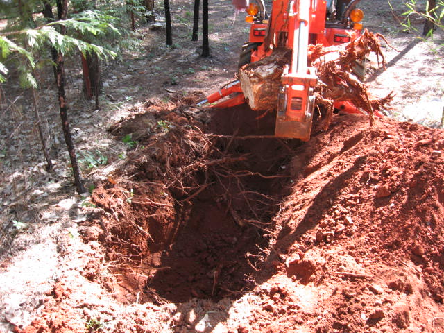

The main purpose for building the bucket was needing a narrow bucket for trenching. I think I built it 7in wide. It is most effective when I'm digging a trench, ie. the side walls hold the dirt in the bucket until you clear the surface. I've put in hundreds of feet of trenches with it and I'm quite pleased.
If I needed to do more open excavation in clay I'd still consider building a wider banana style bucket; it was neither a difficult nor expensive build.

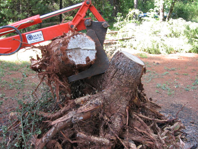

I have also found in many cases I prefer the banana bucket over the root tooth I built for digging stumps especially medium to large stumps (12" - 30" dia). I can remove much less dirt from around the stump than with my 12" bucket and I CAN remove dirt whereas I cannot with the tooth. The no-tooth beveled edge of the banana bucket also cuts through roots.
For the build I just used mild steel from the scrap pile, even the cutting edge, and I have had no problems with it. The cutting edge now needs sharpening but the rest is as good as new although I've tortured it in the occasional rock nest and powered up to the max pulling stumps.
