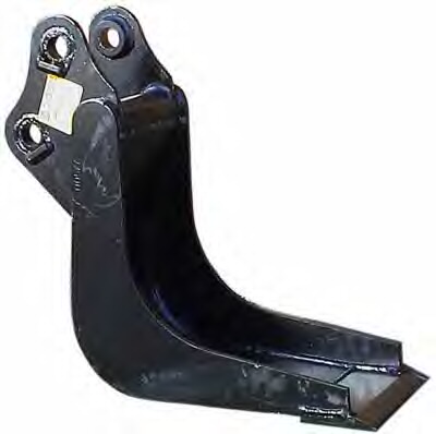

RedDirt, I like your banana bucket. Nice job!
I am curious, did you consider adding a couple of teeth to the edge? I know it can sometimes be more difficult to get a flat bottom of the trench. I often put a thin layer of crushed limestone around the pipe or conduit, before I back fill, more to protect what I am installing.
/ Device for emptying backhoe bucket
#42
RedDirt your digging is impressing!
Any tips on how to get the right leveling of the trench bottom so that the water will flow easily?
/ Device for emptying backhoe bucket #43
Most of the time I get along fine without teeth and I can drag a nice flat bottom trench with the toothless bucket. But in late summer our clay is quite hard and I did think about adding some teeth. I wanted to add some bolt-ons but couldn't find any locally and with the project underway could not wait for mail order. I built my own, two teeth, cut from a single "C" channel, but they did not work well. Since then I have just been trenching when the ground is softer. For stump removal and trenching in hard ground timing is half the battle!
Putting in a layer of bedding before pipe is a common practice especially where rocks and stones are numerous. Around here we use either sand or pea gravel. Being as our dirt is fine clay with few rocks I am able to fair the trench bottom with loose material and my trench rake. The "fill" with the rake rarely exceeds an inch or two so I'm not too concerned with compaction below the pipe at the low spots. After I rake I water the bottom well and foot stomp for compaction or use a hand compactor (a square plate on a pole) if the trenches are deep.
