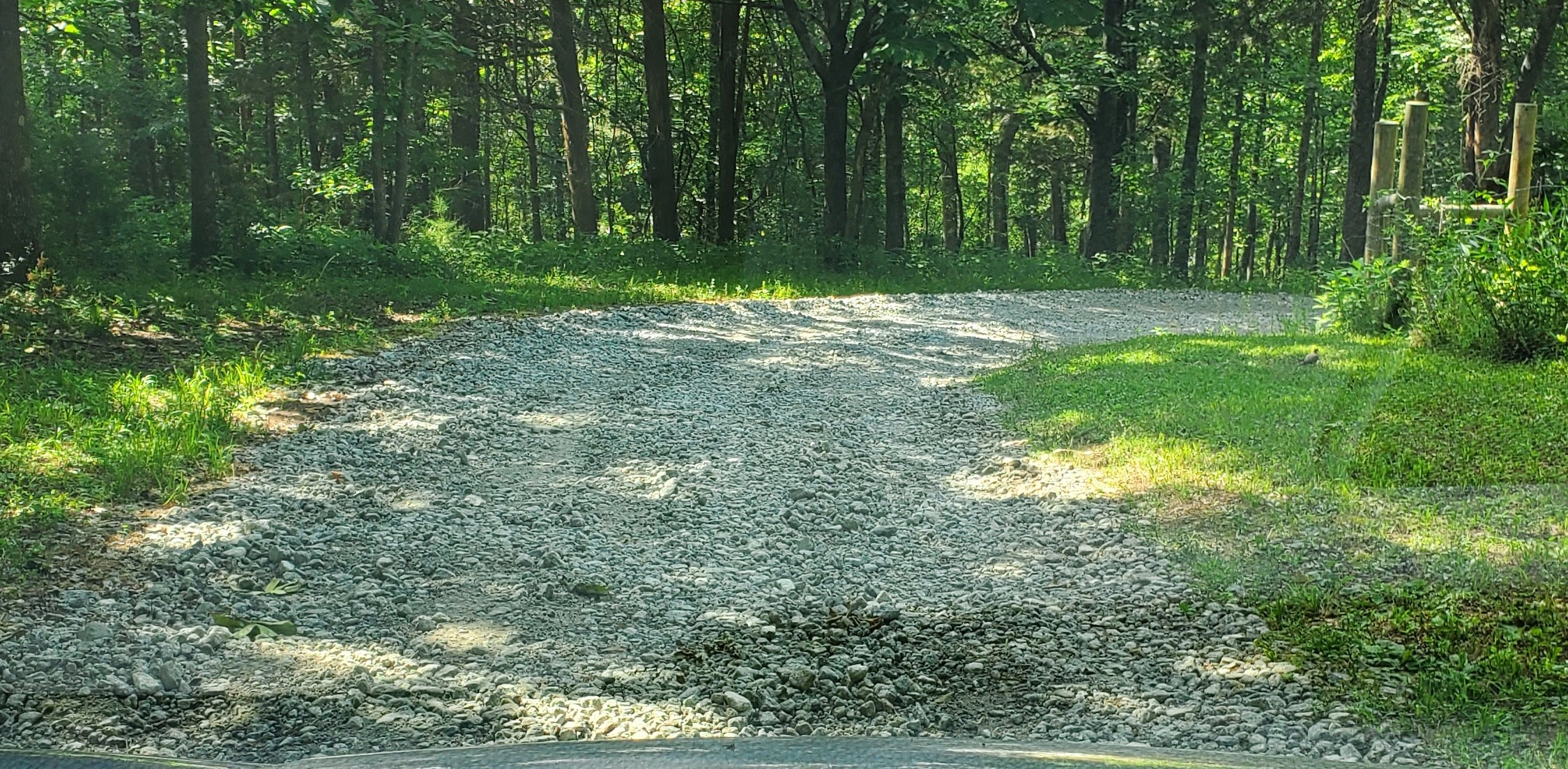

Hello All,
I posted a similar thread about 1.5 years ago regarding our driveway and after much thought, we decided to get a professional to fix it and get it done right. Well, after having a "professional" add gravel and smooth the driveway about 10 months ago, we are back to the same driveway with ruts....but we now have more gravel.
Info on our wonderful driveway. We currently have a .25 mile driveway (future driveway will be around .25 miles also) with surge stone and gravel. When the UPS/Fed Ex/Amazon driver comes down the driveway, they rut it up really bad. I have a small sporty'ish sedan and it's dinging up my skid plate and who knows what else.
My husband has given me the go ahead to purchase an implement to fix the driveway! Woohoo! I'm leaning towards the box blade mainly for the future house we hope to build in the next 2 years if lumber prices ever come down. The box blade would be used to maintain about 1/2 mile of existing trails, smooth out the land around the future house and finish building the rest of the .25 mile driveway.
We have an MX5800 (no hydraulics) and I think a 6-7', >700lb box blade would work best, maybe an EA Severe Extreme (78' or 84') or a Woods (76-84'). My husband thinks a land plane would be better. Any suggestions? I need to purchase it quickly before he changes his mind. :)
Thank you!

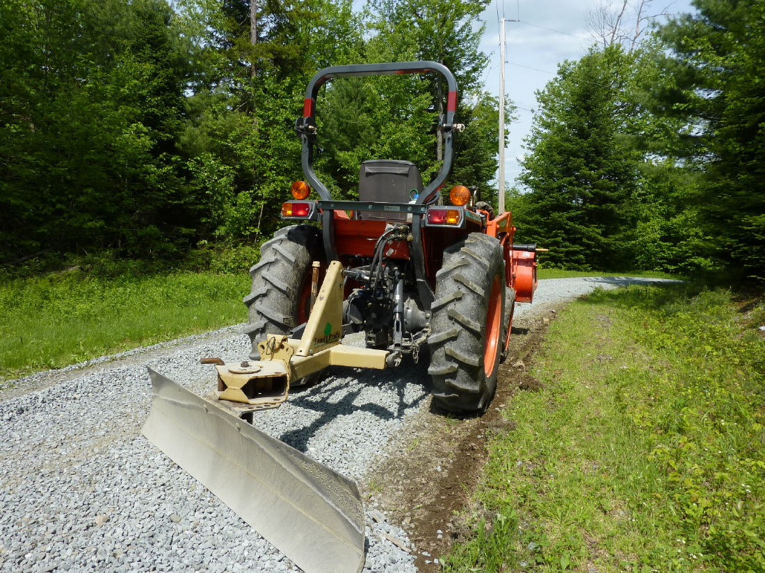

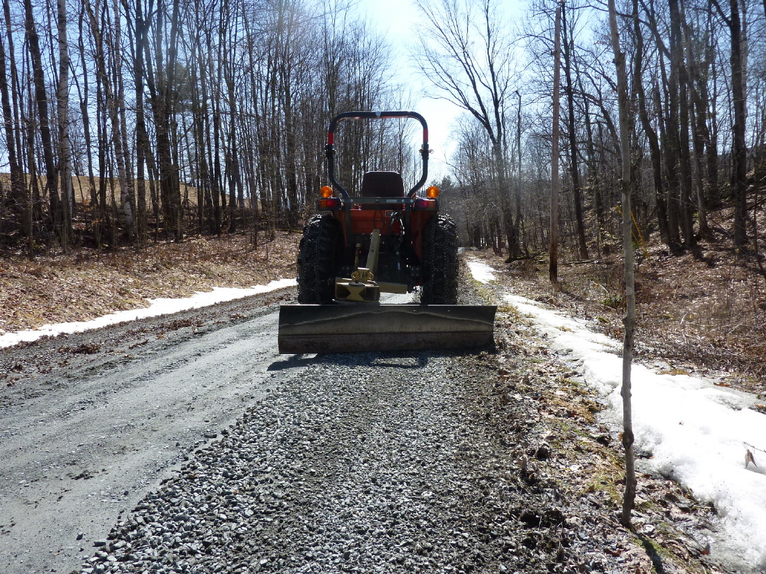

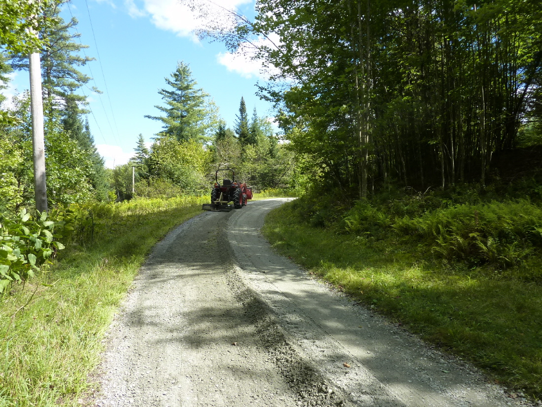

Here are a couple pics of what I was talking about. In this one I am doing a spring time chore after snow plow season. Pulling the plowed off material back into the road with the back blade turned backwards.
And another spreading fresh stone
And crownig
I should add that I have a rear blade, box blade, and land plane. Also a lot of road to maintain. They all have their place.

Hate to say it but your "gravel" is way too big for a box blade or a landplane to do much good. It's great for a base once it's locked into place but you don't have any "fines" (smaller rocks) to actually to hold the rock in place.
If you have a FEL, I would load it up as much weight as it can handle and back drag it (in float or even put down pressure on it) to flatten what you can. Also, running it over with your tires (with your heaviest implement out back) to try and pack what you got BEFORE buying crushed gravel like Gordon's above photo...

Don’t think the surface material shown will pack or hold its shape. You require a crushed well graded gravel.
A rear blade with gauge wheels would work best for bringing in the sides and shaping the road. Scarifying well first would really help. The gauge wheels will really help with a back blade.

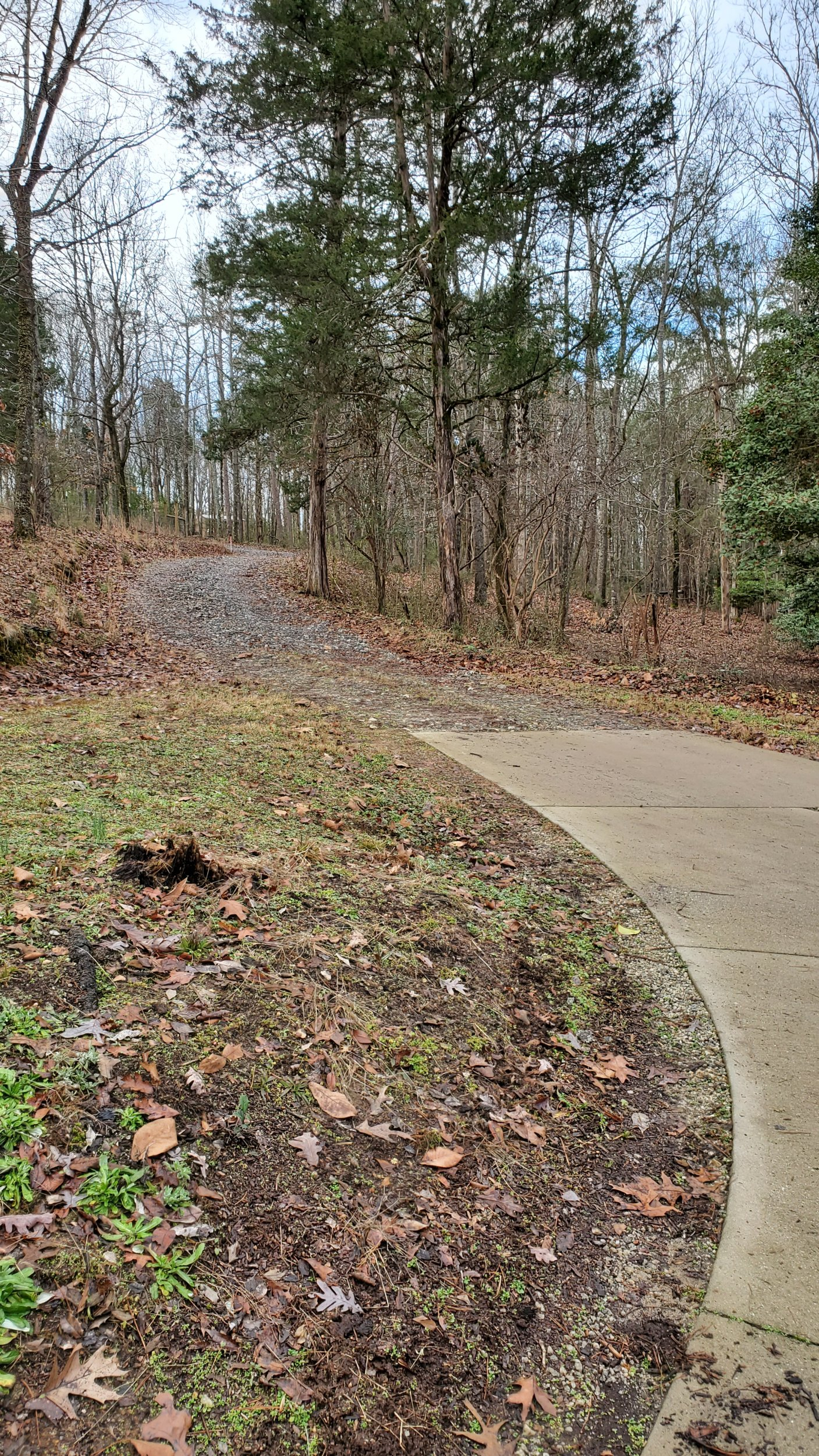

The key to any driveway success is drainage. This passes through what would be a swamp. Only a landscape rake touches it.

In taking a close look at your first picture, it appears as though your driveway is actually doubling as a drainage swale for all water run-off from both sides. Tough to tell if the dark areas at the bottom of your picture are shade, or dampness from water running across it.
You can rake, comb, or groom the driveway all you want, but until you solve your water shed issue, you will continue to have this problem. The driveway must be above the water shed areas. Thus you need to install drainage swales/ditches along each side, or at least where the water empties into the driveway. An installation of a drain culvert under the driveway could work wonders on the worst areas.
From the picture it appears you have an "inverted crown" in your driveway. No doubt from the water running down it. You need to reverse that flow, and redirect it to the sides of the driveway, and into the newly installed drainage ditches. Without actually seeing it in person it's hard to tell exactly what you need and where you need it to actually fix the problem (not treat to symptoms). I would suggest getting an excavator contractor out there to eye-ball it, and give you some recommendations.
Don't waste your money (like I did) trying to groom the driveway out of the problem. You have to address the drainage issues first. Otherwise you're just dumping money into a never ending pit. Depending on the severity of the drainage issues, you might want to rent a mini-excavator back hoe, and dig the drainage trenches, rather than trying to have a tractor implement do that job. Better yet, let the excavator contractor do it. They will do more work in far less time, and you'll get a better job from the pros. (Maybe a neighbor with a large back-hoe could do the work?) Might only cost you a case of beer, or dinner maybe.
The land plane is a good implement to groom it, but it won't fix it. I use a landscape/York rake to groom my ½ mile drive. Either implement will work, just personal choice.
