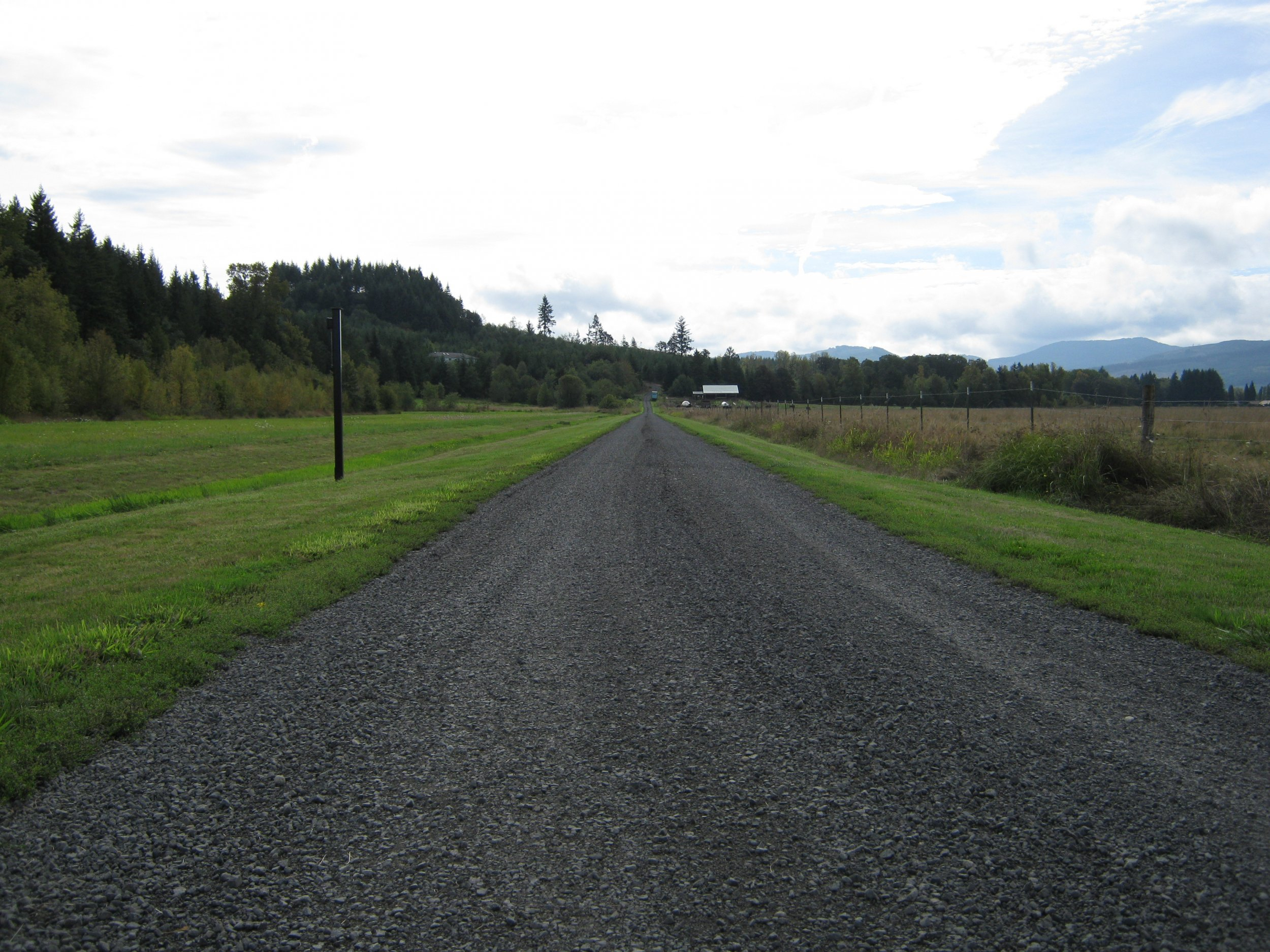

Hello All,
I posted a similar thread about 1.5 years ago regarding our driveway and after much thought, we decided to get a professional to fix it and get it done right. Well, after having a "professional" add gravel and smooth the driveway about 10 months ago, we are back to the same driveway with ruts....but we now have more gravel.
Info on our wonderful driveway. We currently have a .25 mile driveway (future driveway will be around .25 miles also) with surge stone and gravel. When the UPS/Fed Ex/Amazon driver comes down the driveway, they rut it up really bad. I have a small sporty'ish sedan and it's dinging up my skid plate and who knows what else.
My husband has given me the go ahead to purchase an implement to fix the driveway! Woohoo! I'm leaning towards the box blade mainly for the future house we hope to build in the next 2 years if lumber prices ever come down. The box blade would be used to maintain about 1/2 mile of existing trails, smooth out the land around the future house and finish building the rest of the .25 mile driveway.
We have an MX5800 (no hydraulics) and I think a 6-7', >700lb box blade would work best, maybe an EA Severe Extreme (78' or 84') or a Woods (76-84'). My husband thinks a land plane would be better. Any suggestions? I need to purchase it quickly before he changes his mind. :)

1) Fix the drainage problem. The road needs to be above the water and shed rainfall to the side(s).
2) Use a well graded, crushed gravel. From the pic it appears the material used is not crushed and therefore has no sharp edges to help it bind and there are no finer gravels to fill the voids. It's like driving over marbles, they will just roll out of the way, since there is nothing binding the materials together.
3) Once the driveway has proper drainage, a crown and proper gravel, compact the surface. The compaction serves 2 purposes, 1) to seal the surface and help it shed rainwater and 2) to bind the materials and make the mixture as dense as possible.

Your road is the low point of the surrounding land. Need to get the road higher than the surrounding land. Add in some ditches to keep the water off. Then crown it.
It took considerable effort to build, but I have never seen a pot hole or standing water on my road. It's never muddy and is solid as a rock.
Build up the your road. Grading it without raising it will only keep you busy every year.

I concur with the correct assessments of improper grading (no ditches, no crown, etc) and type of stone used so far (large, round, no fines). It will obviously keep leading to this problem.
However, I also don't see any obvious erosion in the pics, or muddy spots. Might be a pretty deep layer of this large rock. You have a good start here.
But the OP has an MX5800! Just get a nice HEAVY land plane, and start pulling that driveway back and forth. You'll get it smoothed out in no time. If it were me and money wasn't a problem, I would definitely get that nice base rock covered up with 3 to 4 more inches of finer gravel. If you have sandy soil and dont want to buy any new gravel, you could even mix in a light amount of sand with those large driveway stones, and keep working it with the land plane. Drive up and down a bunch of times to pre-compact it before you get your next UPS guy doing 20 mph on it, lol.

I think the OP needs to identify what's happening before trying to fix the problem. Is the gravel moving to the sides which is creating ruts? If so round rocks are like marbles. They roll and move and without something to hold them in place, often called fines, like small pieces of broken rock you're always going to have a problem. Or is the gravel sinking into the ground. As in is the ground under the gravel turning into mud and swallowing up the gravel.
As for water, what happens when you get rain? Does water run down the driveway or if the ground is flat pool up? Running water will wash away the fines I talked about so it's best to find a way to stop it. Puddles (standing water), when a tire goes through it and splashes it'll throw smaller pieces of your driveway off to the side. Puddles just get bigger and deeper and require a lot of work to properly repair (just filling them in rarely works).
My best advice is to get your rain jacket on the next time is rains and watch to see what the water is doing.
