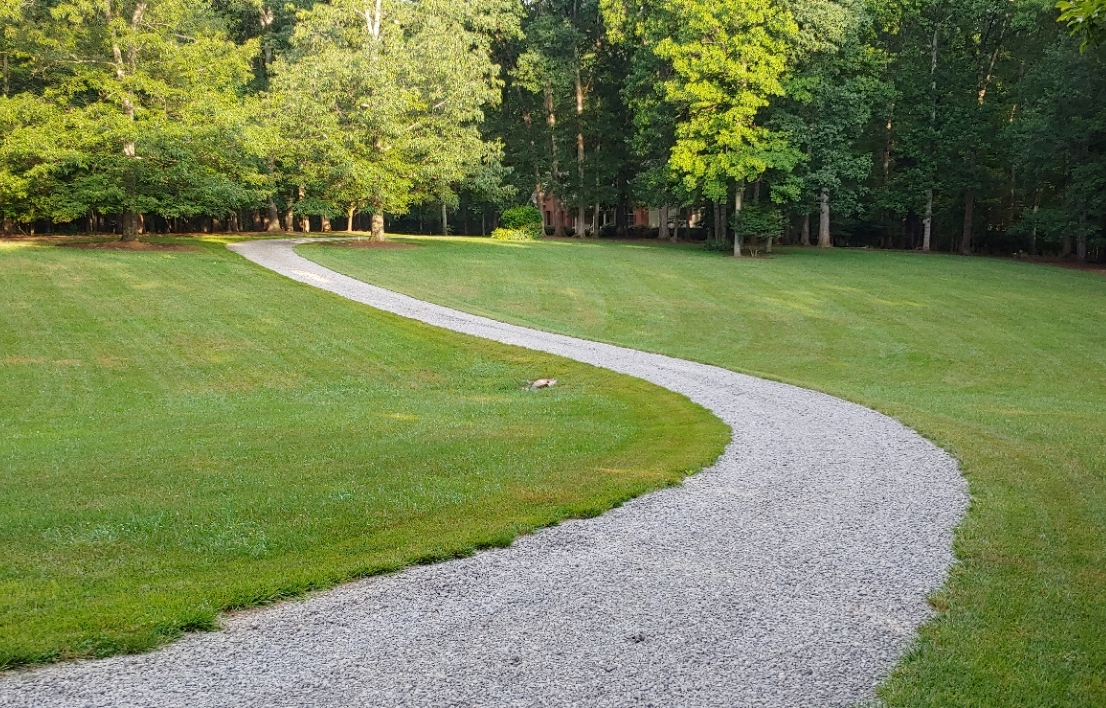

Hello All,
I posted a similar thread about 1.5 years ago regarding our driveway and after much thought, we decided to get a professional to fix it and get it done right. Well, after having a "professional" add gravel and smooth the driveway about 10 months ago, we are back to the same driveway with ruts....but we now have more gravel.
Info on our wonderful driveway. We currently have a .25 mile driveway (future driveway will be around .25 miles also) with surge stone and gravel. When the UPS/Fed Ex/Amazon driver comes down the driveway, they rut it up really bad. I have a small sporty'ish sedan and it's dinging up my skid plate and who knows what else.
My husband has given me the go ahead to purchase an implement to fix the driveway! Woohoo! I'm leaning towards the box blade mainly for the future house we hope to build in the next 2 years if lumber prices ever come down. The box blade would be used to maintain about 1/2 mile of existing trails, smooth out the land around the future house and finish building the rest of the .25 mile driveway.
We have an MX5800 (no hydraulics) and I think a 6-7', >700lb box blade would work best, maybe an EA Severe Extreme (78' or 84') or a Woods (76-84'). My husband thinks a land plane would be better. Any suggestions? I need to purchase it quickly before he changes his mind. :)
Thank you!
