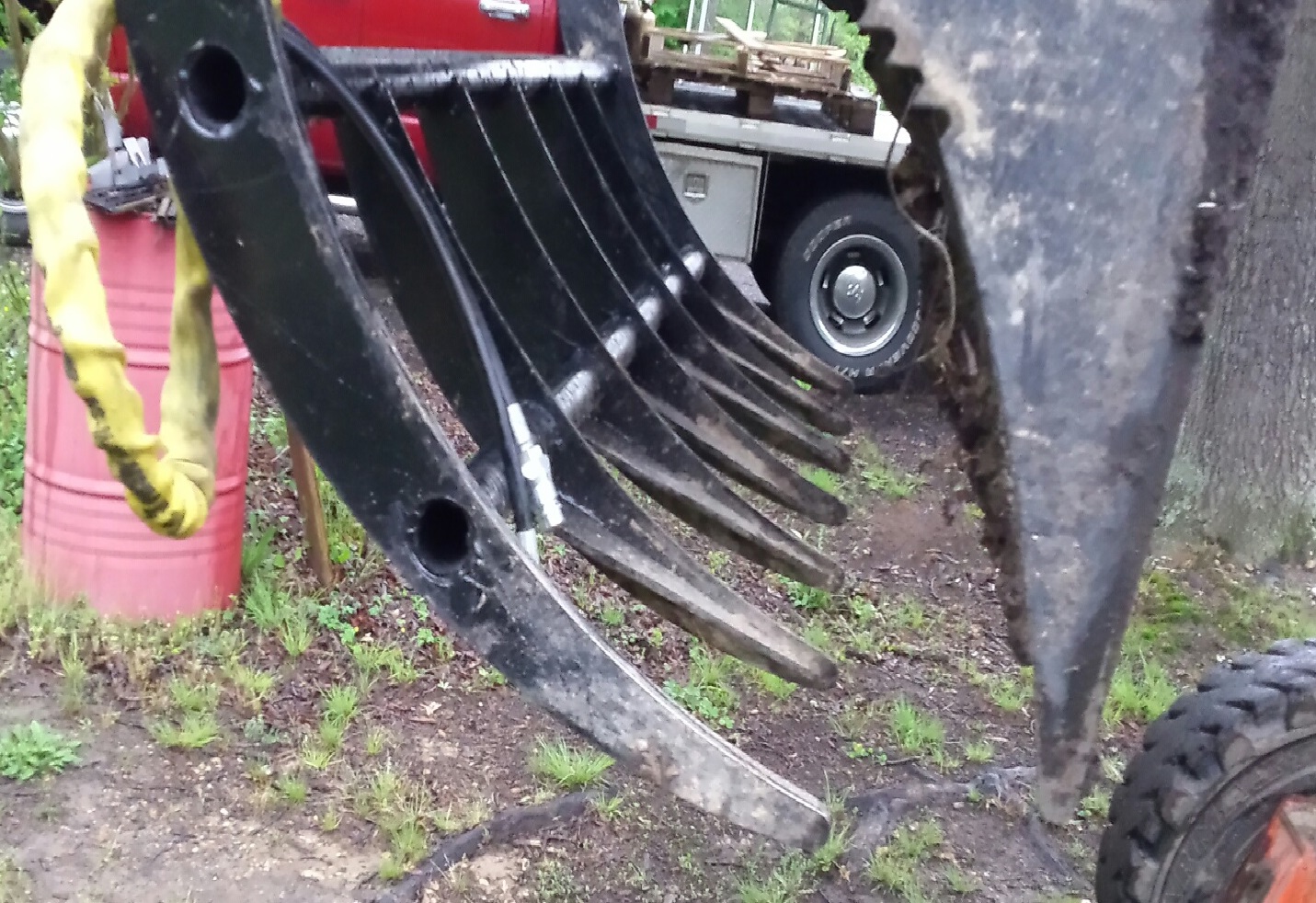

Almost like they used the wrong cylinder with not enough stroke. (except for the play) He doesn't still have air in the line's & cyl does he?
no air pockets, ran it on his and mine. originally thought it was a cylinder/stroke issue but have since ruled that out. took it apart and the pivot points are almost 1" with 3/4" bolts. the cylinders have 1" pins and the holes are almost 1 1/4". Have not heard back from wgaequipment or wildkat after numerous attempts. I have a fix in the works but was hoping they would step up.
/ Denton, NC #25
It sounds like some brass bushings might be a good fix. Too bad you have to do instead of the vendor.
/ Denton, NC #26
Now that's just plain sloppy! A new guy in "asembley" & no q/c? A couple of emailed pics of that to them should fix things. (hopefully)

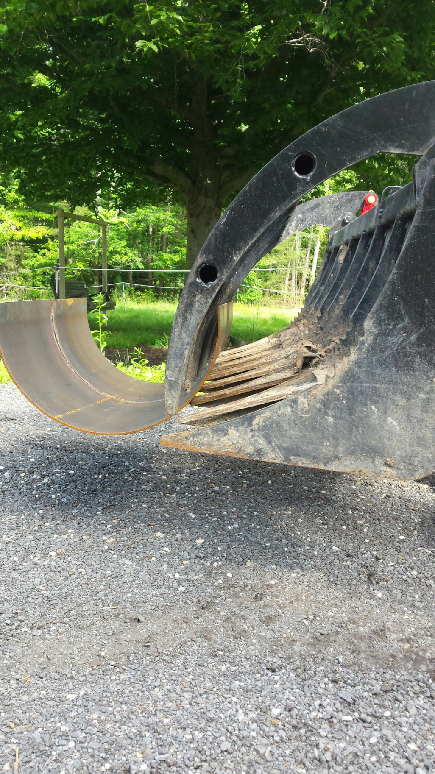

/ Denton, NC #27
spent part of today boring holes and pressing in sleeve bearings. The rake can now pick up and hold 1/4" stock. will have to add a picture later, dont see that option from mobile and my regular internet is down.
/ Denton, NC #28

/ Denton, NC #29
Well that is not the case here. Hopefully, you get to rely on gravity for your needs (or eat more wheaties :) ). Notice in the picture that the hoses are disconnected. The cylinders were fully extended. There is 5+ inches of play at the tips. Pivot points need some attention :thumbdown:. For reference, the tire in the background is 16".
Otherwise, the grapple rake is rather well built for the price. I tried it on my 86 hp skidsteer. dropped the teeth 4-5" into the dirt and pushed. Nothing broke, so......:thumbsup:
That is a clamshell grapple so gravity is your enemy not friend. Looks to me like they must have used the wrong cylinder size so the upper jaw just doesn't move far enough.
