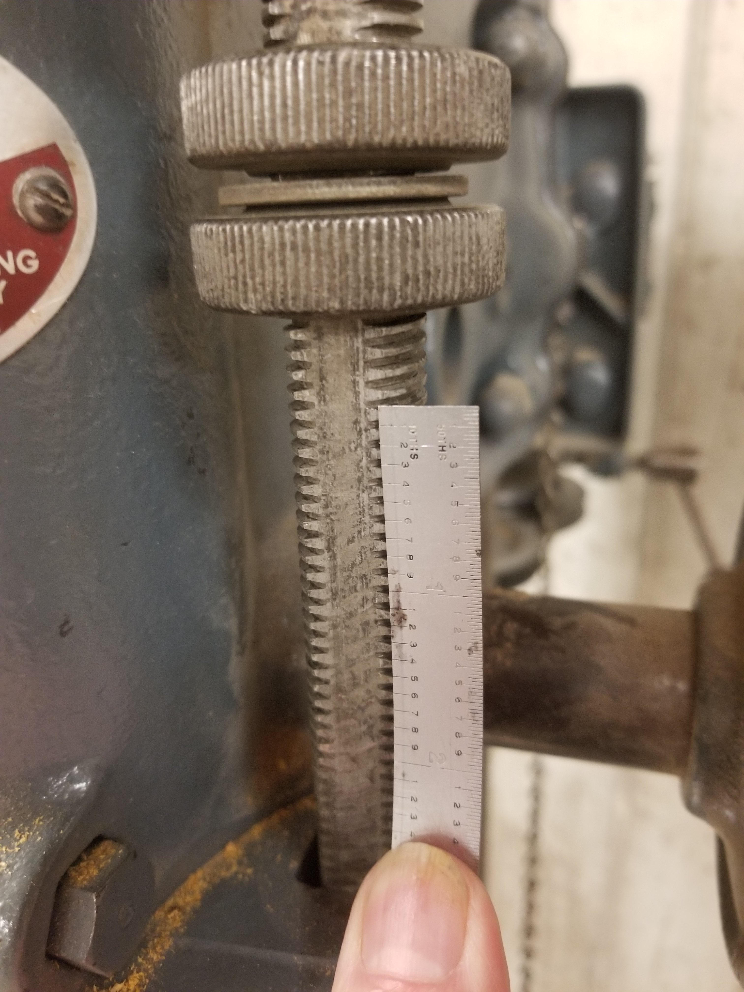

I’ve been searching for a 3/4”-10 acme nut for the stop on my drill press. The od is 0.745 and threads per inch are 10 as close as I can measure.
Help appreciated
Photo attached.

3/4-10 is probably not acme threads. Probably just standard threads.
Have you tried just a cheap hardware 3/4-10 nut to see?

Delta did make, or had made, a wide range of drill presses, and some had some unusual threads, so I would be careful. I know that I have a very similar nut, and it is not ACME threads. The 3/4" ACME size would 3/4-6. On my drill press, the nut is actually two knurled jam nuts with a rubber washer/o-ring between them, as shown in @90cummins' photo.
@90cummins Do you have a model number and an age for your press? I would put the 3/4-10 in the trust but verify category by buying a 3/4-10 nut and see if it fits, as @LD1 wrote above. From a distance, those threads do not appear to be ACME, but I would not put much weight in that.

Yep, I saw the post, and the expensive nut. Doesnt call out what thread it is. And just because the thread looks "flattened" doesnt always mean its an acme thread. If he has the model of the drillpress I am sure it can be sourced

Ha... it looks like an acme to me!
I'm on Vintage Machinery alot too. Way more people looking for cheap parts than offering them. So many tire kickers.
If you think $35 is too much, try making one. I have a metal lathe. Cost out an acme tap, straight knurling tool, getting parts plated... he isn't getting rich.

OP said 3/4-10 acme
I checked my Delta drill: 3/4-10 acme.

FWIW: @90cummins if you can knurl it, ACME 3/4-10 round internally threaded is available from the usual folks.
McMaster, Roton, etc. Bronze and steel.

If that is your photo in the OP, then it sure doesn't look like Acme. 3/4-10 is the stand UNC coarse thread in that size. I'd at least try a cheap stock nut from the farm store first to verify...

I found a 3/4-10 bolt & nut in my catch all pile and put it up to the acme the thread and it is a perfect match at 10 threads per inch and NO the nut does not turn on the acme rod.
