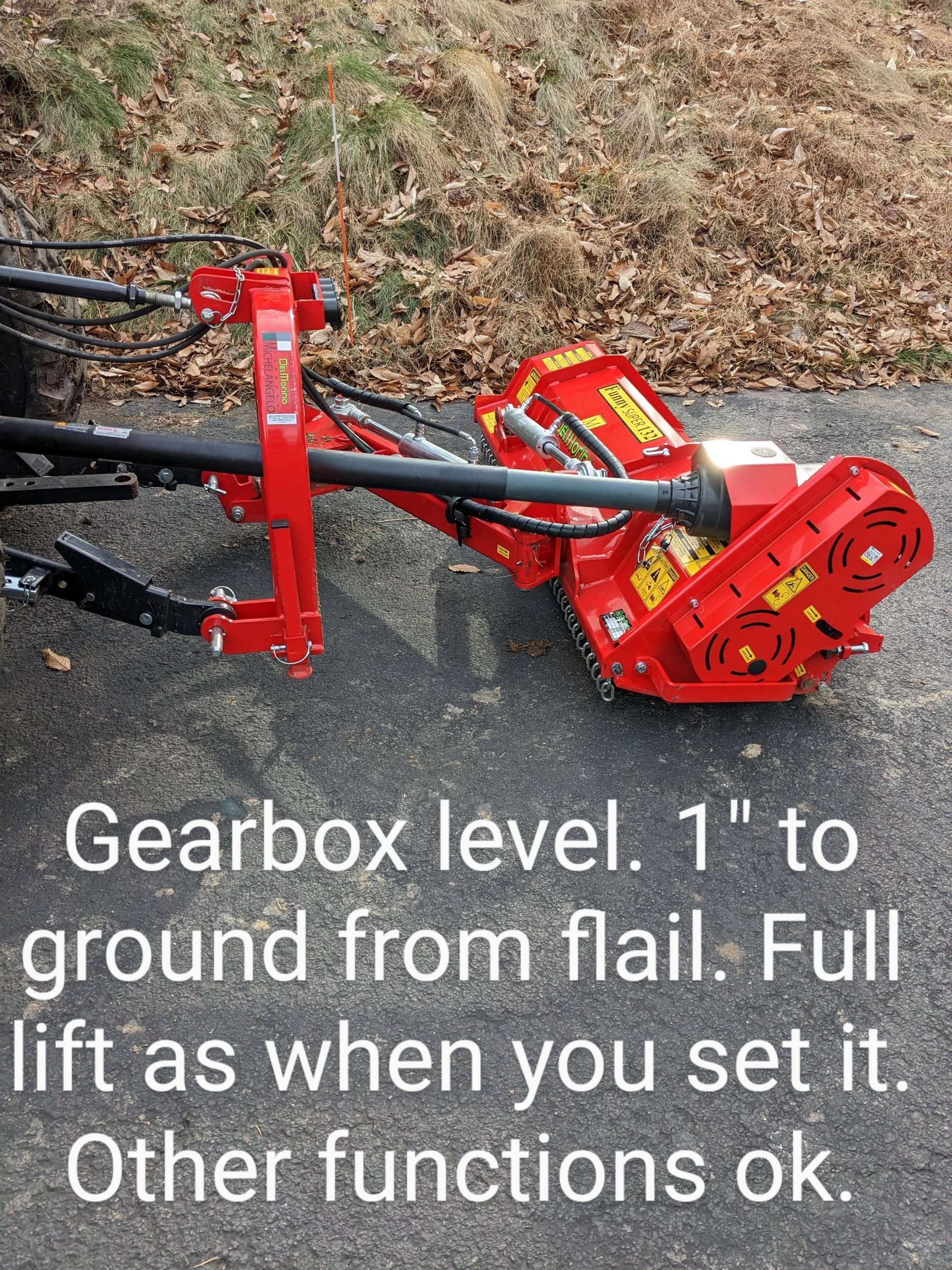

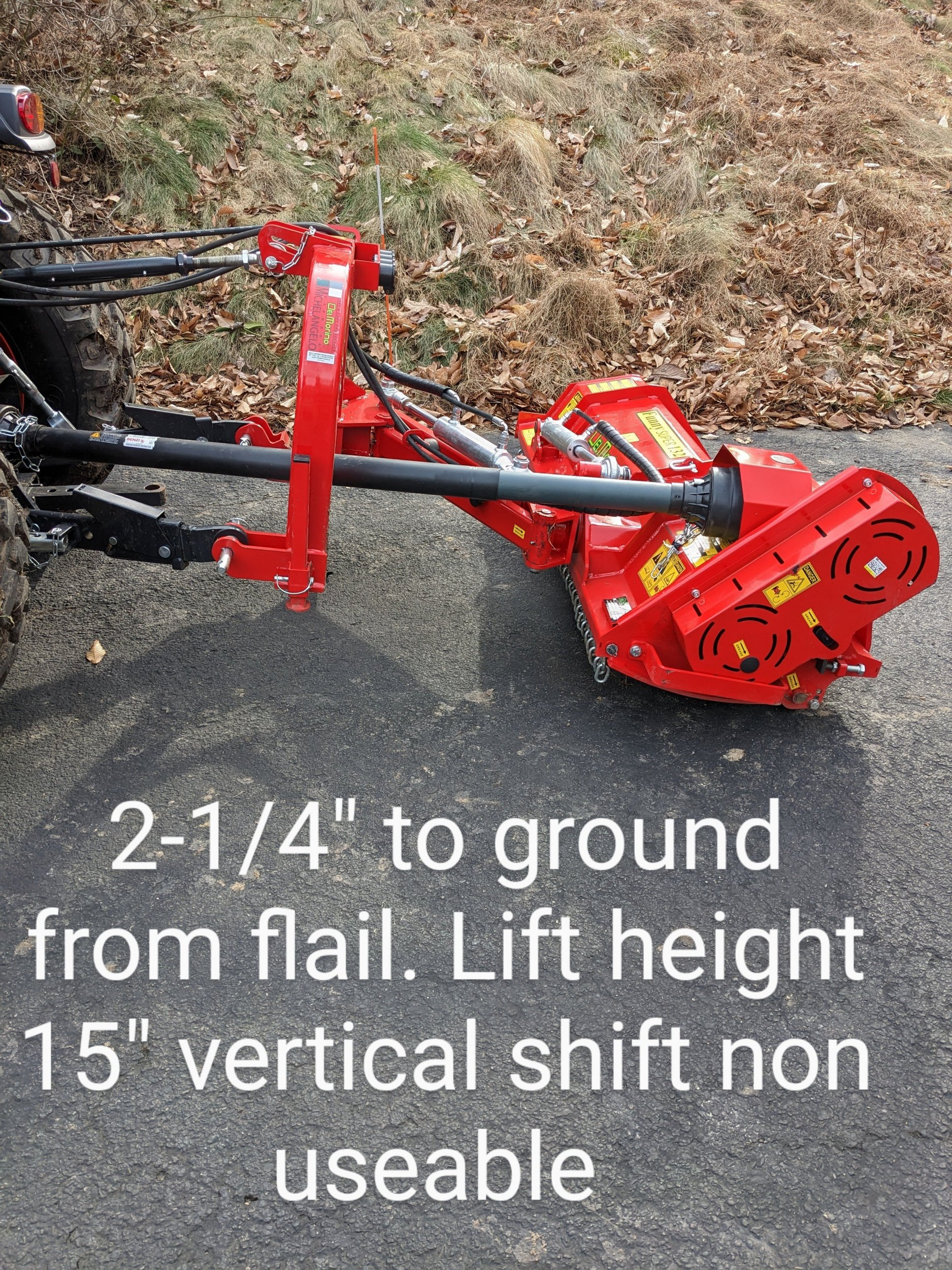

Can someone assist me in getting my Del Morino adjusted for cutting height.
Per the specs it is adjustable from 1" to 3".
I want to be around 2" to 2-1/2" if possible.
I have the back roller at the lowest point, with the gearbox leveled with the top link the flails are 1” off the ground. I’m doing this on a level paved area.
If I adjust the top link out to gain height, I’ve gone up to a 2” clearance, I lose lift height and functionality of the rotation. It doesn’t work.
The owner’s manual has nothing but raise or lower the roller.
Any thoughts out there.
When adjusted as below, no lift or at least not high enough for the vertical lift function to clear the ground.
TIA

About your beautiful Italian made orchard and Vineyard Shredder;
you need to have your dealer increase the relief pressure on the
three point hitch hoist circuit of your mule if it is unable to lift the mower.
If the rear roller is at its lowest mounting point that is the highest
cutting height and you will have difficulty obtaining a good cut as
there is less of a pressure gradient to create the suction needed for
the knives/hammers to cut and lift the material.
You have 3 height settings on your flail shredder indicated by the
3 holes in the side weldments of your flail shredder.
The bolt in front of the rear roller holds the rear roller in place and
If my memory is right you just loosen it a little to allow the rear roller
to be raised and lowered to adjust the cutting height of your flail shredder
You remove both bolts on the adjustment holes and reset the bolt,
nut and washer in the desired hole and tighten them back up.

You missed my point or maybe I misunderstood you. I believe you said it doesn't lift high enough to work properly when you get the height set where you want it. If that's the case, I was saying you may need to adjust the lift arms so it will lift "higher".
/ Del Morino Funny Super Adjustment

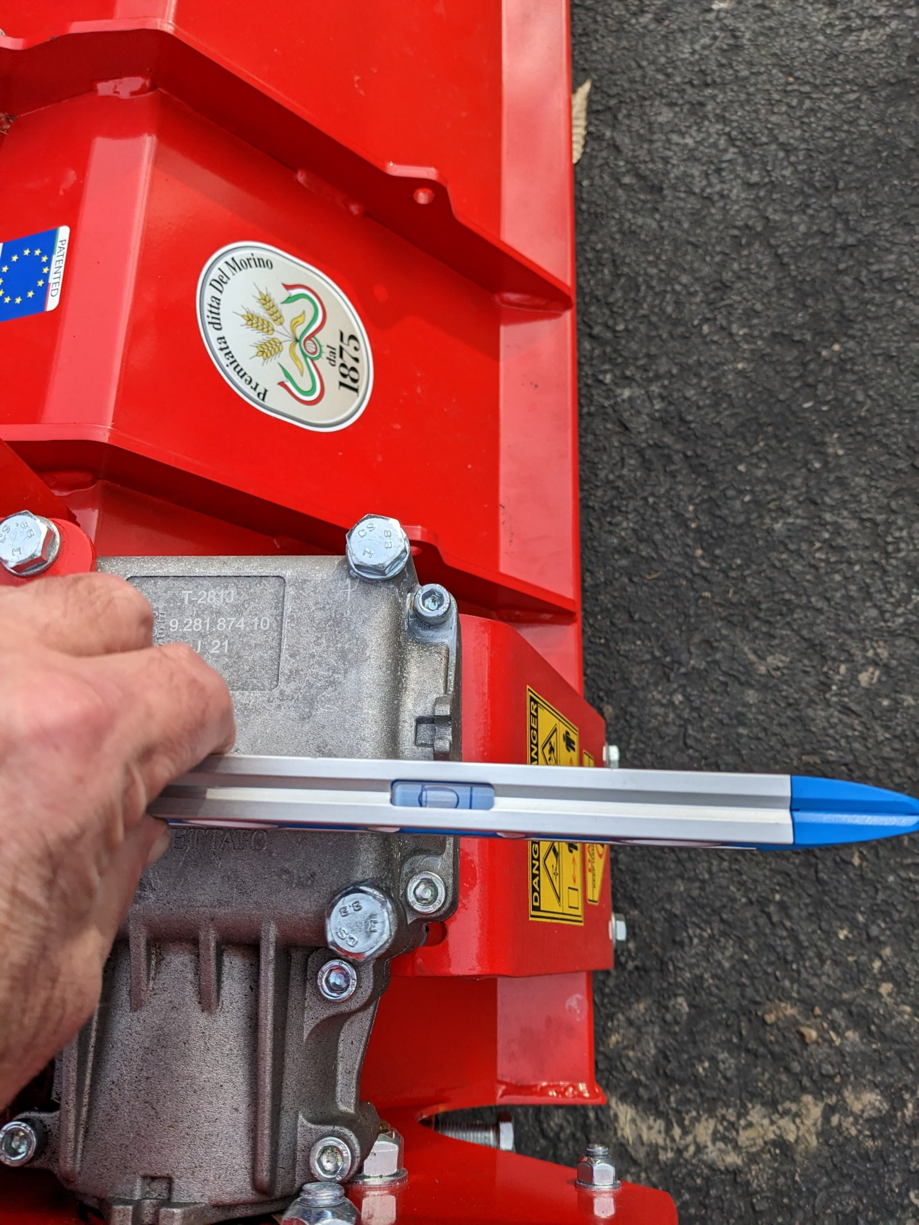

I may be doing things wrong on my end as well. If I have the unit on the ground and adjust the top link to raise the front end so the blades are slightly higher. They're then is not enough travel to lift the unit off the ground high enough. The lower arms are not the issue but when extending the top link it won't go up as high. I only have one hole to place the top link on the tractor not multiple or some units have.

As usual they do not understand these mowers and how they work.
You need to decide what height of the three positions you want and need to mow at.
The highest bolt hole setting of the three will give you the best closest cut.
The middle hole will make the cut one inch lower and the bottom bolt hole
the highest cut height.
If your lower links are fully retracted which they appear to be they need to be extended one or two holes
at a time along with your top link to find the right place for it to work and maintain a level flail mower to lift
the shredder to allow the rotation cylinder to rotate the mower to vertical or allow it to drop below the
horizontal plane to mow a downward sloped bank.
These boom mounted shredders are designed to work with the three point hitch fully elevated with the boom fully extended
to the right to mow hedges, vineyards berry cane hedges and mow weed trees back along a lane or road.

I think I'm better understanding your comment on the lift arms after thinking it thru.

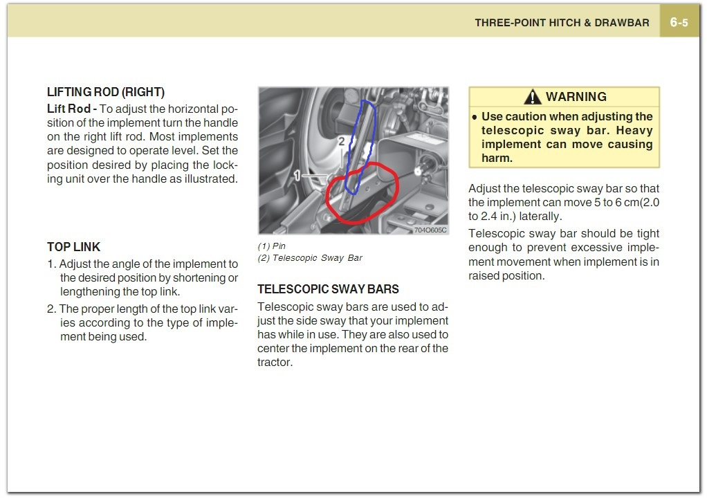

So extend the 3PH arms if they are designed to do that. I thought those telescopic arms were just for hooking up an implement. That's how mine were on my 5310 and on this 5090 I have. But I can't run them extended.

I have an older Kioti and the extendable 3PH arms are only for hooking up, they don't lock extended. When people say adjust 3PH arms they are likely referring to to adjustments where the lift links attach to the arms. The owner's manual doesn't appear to explain this, but I've attached a picture of what to look for. You can adjust the connection between the vertical link, circled in blue, and the 3PH arm circled in red. Depending on which holes you use it adjusts how high the arm raises. In the picture I attached there are holes in the vertical arm and the 3PH arm. If you post a picture of the back of your tractor we can help show you which holes to use. I have a more basic del Morino and agree the rear roller doesn't allow a high enough cut on its own, I have to extend my top link a lot, but it works fine that way.

I'm not sure I have the same options. There are only two hole positions and the lift arms are currently in the one closest to the tractor.
I'm not sure of the clearance with the telescopic activation handle if in the front position hole.
