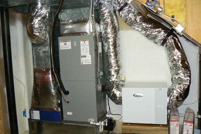

If you want to take care of humdity (mositure) issues in the home, you can't beat a whole house dehumidifer.
For curiosty sake, I installed one (whole house dehumidifier) when I replaced my first floor system. What I was curious about was the effect this unit would have on the RH levels on three floors in the home, when each floor had it's own seperate HVAC system, and also how it would compare with a new variable speed system as far as taking moisture out of the enviroment.
I'm sold on them now.
So far this year, my first floor temperature hasn't gone below 78 degrees in cooling, even though we've already had some pretty warm days in June now in NC. Third floor during the day doesn't go below 80 degrees, and you'd be surprised how "cool" that feels when it's around 45RH upstairs. I usually run the dehumidifier in June, July and August, and in the other months, the HVAC system can handle the humidity on it's own.
I was pleasantly surprised on the positive effect this unit had on the two other floors where the ductwork from the first floor system was not connected.
Enlcosed are the readings during June of last year when I had the system running (I ran it June, off July, ran it back on in August) to see what the difference would be per RH, Temp, and dew point for each month. Minimum of nine readings taken per day (morning, afternoon, evening), at least one reading per floor for each recording of data (yes, I'm a weanie for taking the time:D) Also inlcuding a pic of the HVAC job when it was finished.
Funny, after the first month in June last year when I stopped running the dehumidifier, about halfway into July my wife asked me if I intended on running the dehumidifier in August. I asked her why. She told me she liked it better with it running.
The unit in the picture is capable of doing 90 pints a day. Draws over 10 amps. You don't sell them on cost savings, but on comfort (72 degrees is not always comfortable). In comparison to July with the dehumidifier not running, and relying only on the variable speed system for humidity removal, the dehumidifier makes a huge difference as far as the comfort level. Average an extra $15 per month to run the dehumidifier in the summer months and feel it's worth is for the comfort level.
They can also be run as a "stand alone" unit with no ductwork. Some guys I know use them in crawl spaces for mold issues.
