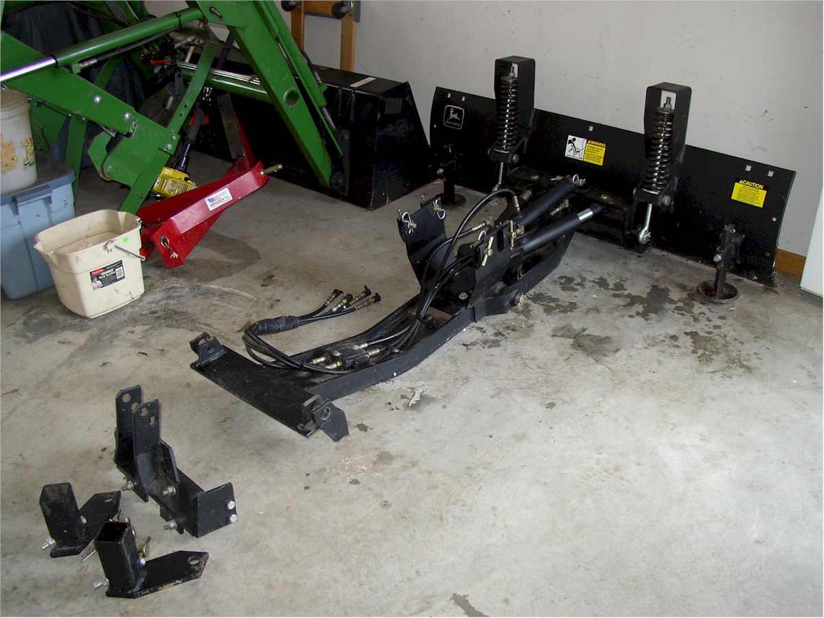

This is the mount:
Same part number as the one above.

It blows my mind that the folks at Deere didn't have even marginal foresight in making the attachment points for the plow and loader the same, given they're designed to fit the same tractor. Using the same subframe for both would not exactly take a lot of thought on their part.
That said, it looks like that particular blade frame has been set up with mostly quick pins, not bolts and nuts. Maybe not a huge deal to change over?

The blade does attach with several pins and getting those thick pins to align with the holes can be a very frustrating experience, but that is not the real problem. After removing the loader you must remove that long loader mount bar that goes through the tractor frame from side to side. That requires first removing the loader mount on one side of it. Then the wing pieces on the front sides of the tractor that the loader attaches to must be removed. Then different brackets are installed onto the loader bar mount holes on the frame, and a cylinder lift bracket is installed on the front of the tractor. Only after all that can you begin the process of trying to align those mounting pins.

I also have an 855 (1987) with a #52 loader, and I have the JD front snow blower also. The mounting hardware in the picture in post #22 is what you need for the blower and front blade type mount.
I mount the bracket for the blower and pto shaft on the tractor and mostly use the FEL and a 5' rear blade. Like you said, I can pop the FEL off and on in 10min flat. That way I can use the blower easily when I need to.

It looks like the small yellow 54 inch blade or the blower could be attached without removing the loader brackets. From what I see, those simply hang from the front end of the tractor with a bracket that replaces the one used to hang the mid mount mower. Compare the bracket in post 22 by techwrtr2 with your mower mount bracket.

I believe JD755 has it right. The smaller snow blade and the 59 snow blower use the same front mount which can be installed without removing the loader mounting brackets. The beastly 380 blade has front mounts that use the same holes as the loader mounts. The 380 rear mounts use the same cross tube through the frame that the rear loader mounts use, so that would have to come off as well.
