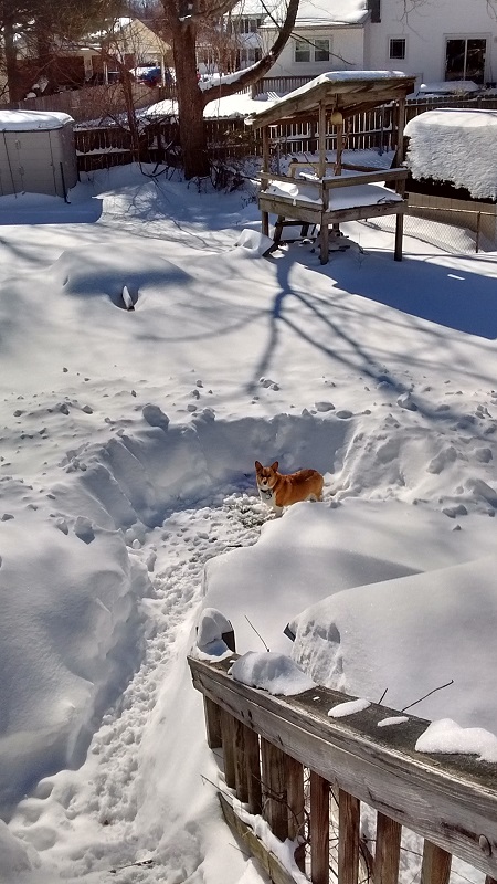

Down here where we got the deep snow in this storm I can often go the entire winter without having to shovel. :)
Even though now some shoveling is required :)
454847d1453729439-deep-snow-techniques-ellie-snow-jpg
Is that a Corgi?? You're a good pet owner though, cleared out a nice little area for it to poop in!!!!
