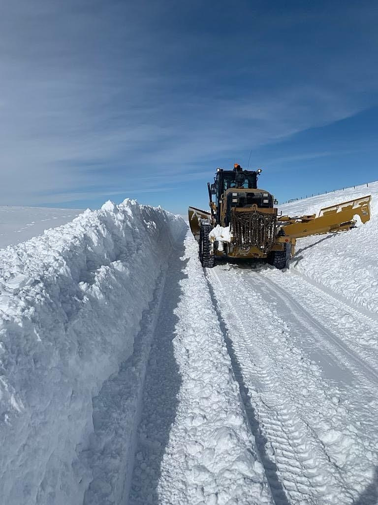

I have neighbors with snow plows on their trucks that clean up the road on their way out in the morning or in later in the day. Also happens they are partners in a logging operation in the area, and when the road starts to close in they bring in a grader, put the wing up high and move the banks back. My equipment could do it, but it would be a multi-pass project (undercut pass, and a clean up pass). No fun.......
