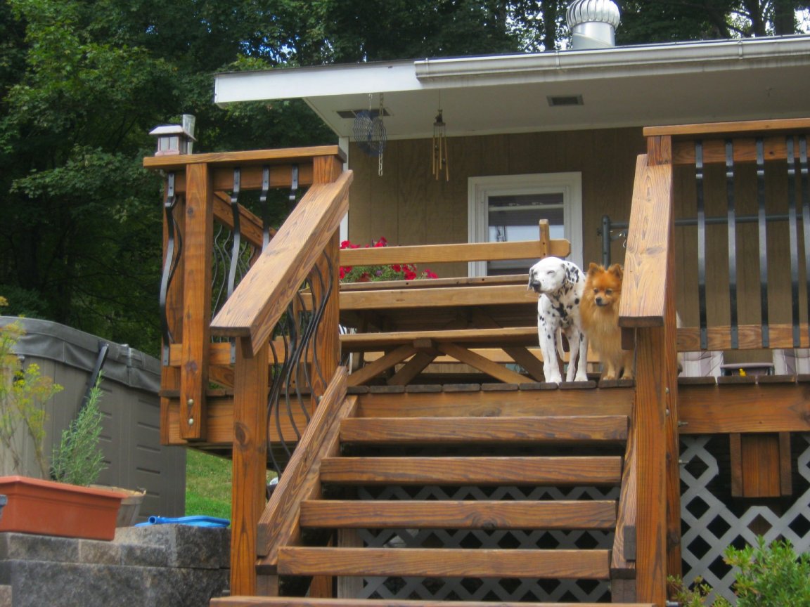

I hate using anything thats oil based so we used this Cabots Aquadeck on our new deck and handrails about 8 months ago. I think it was about $50 a gallon and we've used about 2 gallons. Our deck was completely raw so the first coat soaked in pretty well and used up more sealer than the following coat. We applied 2 coats but it probably needs another couple. As for how good it is.. so far so good, but its only early days. The 'natural' colour has a slight yellow orange tint that looks quite nice. Its water based so its easy to apply with a pad type mop applicator.
I'm not sure how successful it would be if you tried to apply it to a deck thats already been oil sealed.

Bird, I looked into those products when I first built the deck it seems to me that one or the other (probably DEK) is for a new, previously uncoated deck. And, if remember correctly, there was a specific procedure you had to follow, like apply a second coat 6 months after the first.
Then again, my memory is less than reliable. I do remember thinking I could not afford the stuff though, like you said it is not cheap!
Almost all the can is covered with very fine print. You might be able to apply a gallon of so in less time than you could read all the instructions.:D Actually, the DEK says it's for a top coat and should be used after, or over, their Cetol Base. But the SRD says it's a "penetrating" product. As for a "specific procedure you had to follow" . . . well, a specific procedure they tell you to follow, but I guess I'd be a little surprised if anyone ever actually went to that much trouble.:rolleyes:
At any rate, my deck had obviously been treated with Cetol in the past, so I only cleaned it with a broom and air-compressor and applied another coat of DEK 3 years ago. And I did about the same thing this time. And apparently the DEK is the preferred product to go on over previous treatments. Oh well; not the first time I just used what was available.
