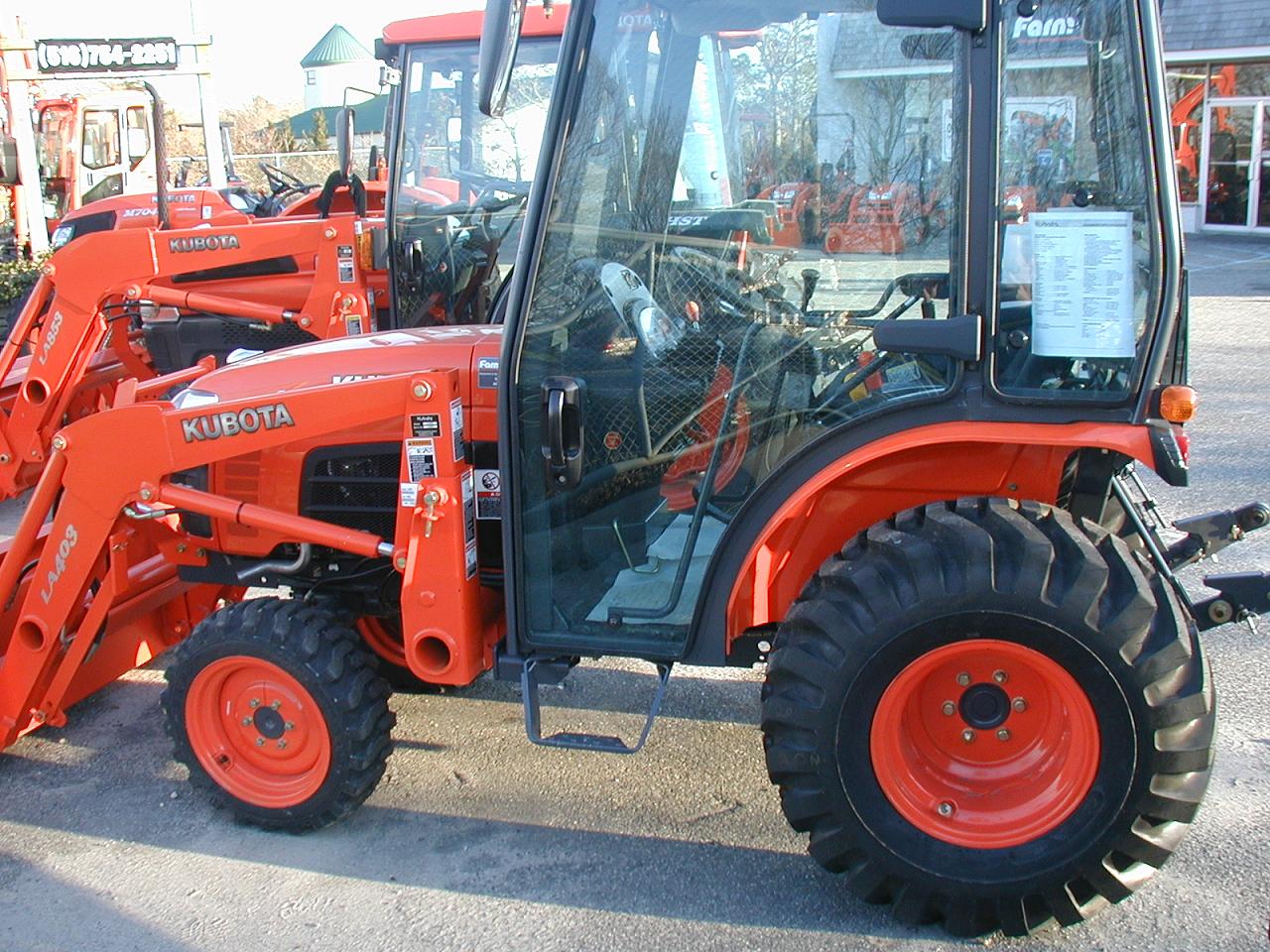

see how the prices compare to this site - Look at all the trouble I caused by suggesting a 2630/3030 from the get go. Its better to know beforehand than not regarding the other models. based on the nice plans Kubota offers, I would find a way to make it the B3030 - have you seen the cab yet for the 3030? Nice!!
