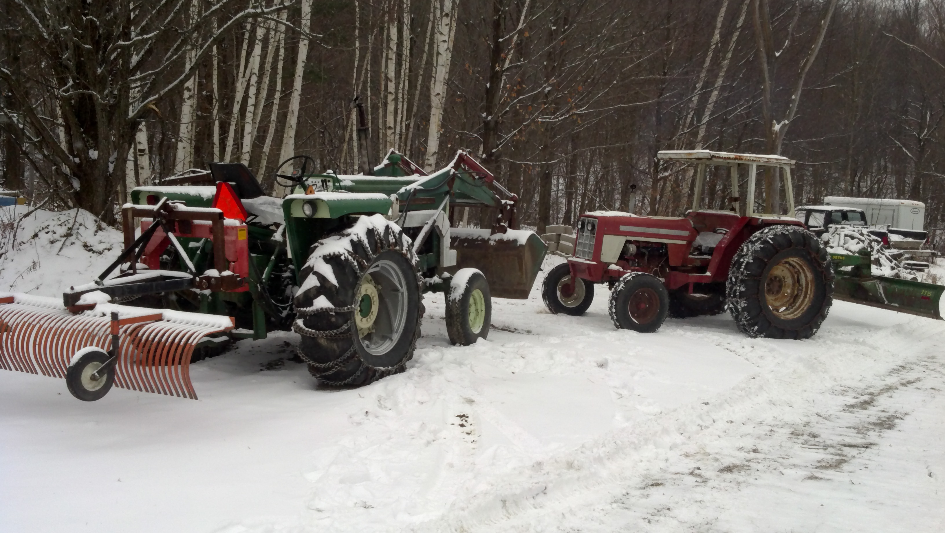

From your posts I see that you are in Mass, you have received quite a bit of advice. So I'll go a tad bit different, if you have mostly flat ground two wheel drive with chains will do a very good job,
Do NOT get the heavy double ring chains that we used for years farming, i have used them as well as twist link, and bar reinforced none of them will hold a candle to the European studded.
100_4165.JPG 100_4304.JPG 012.jpg IMG_20151228_135639105.jpgIMG_20151228_135639105.jpg
I used two wheel drives for many years on an extremely steep and long driveway, you can get a canvas wind/weather breaker type cab for the winter. If at all possible buy cast iron wheel weights instead of filling tires, the initial cost will be more but the maintenance is much easier and a lot cheaper, around here to have a liquid filled tire worked on is at least $300. Also a narrow frontend tractor when used with rear implements or a mounted snow blade is NOT tippy unless used completely stupidly, I would not recommend one for a loader tractor although they worked for many years. That said my new one is cabbed, heated, AC, and 4wd.
A IH 560, 656, ALLis Chalmers, Case, White or Oliver in the 50 HP and up will do the job, and for an almost reasonable cost, any farm shop can work on them if need be.
