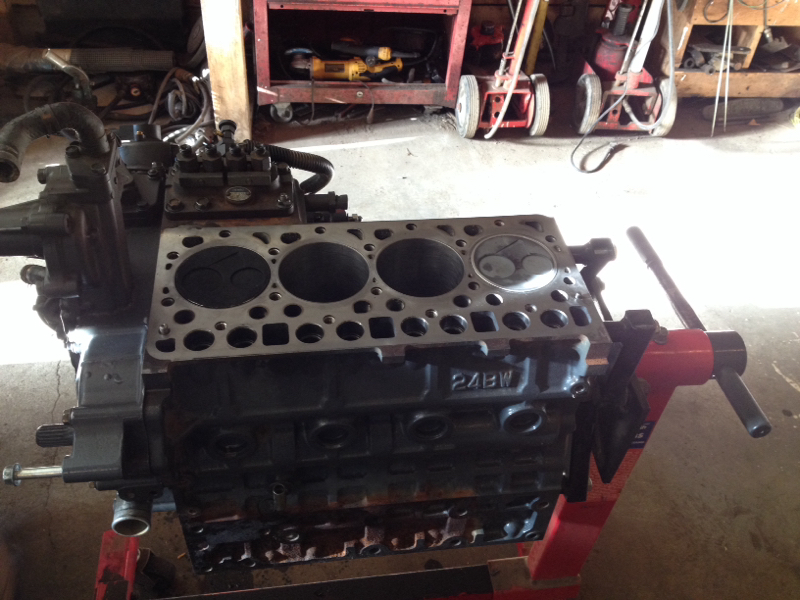

We were around 1hr short of having the engine assembled today. Will continue on Tuesday evening.
The Fred: this is the picture you asked for..

We had lots of fun putting the pieces back together. Wasn't too bad.

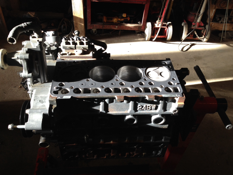

We actually finished mounting the head before calling it a day. Just need to install the push rods, rocker arms, valve cover and oil pump/oil pan.
Aiming to get it back in the frame by the end of the week and the two halved back together next weekend.

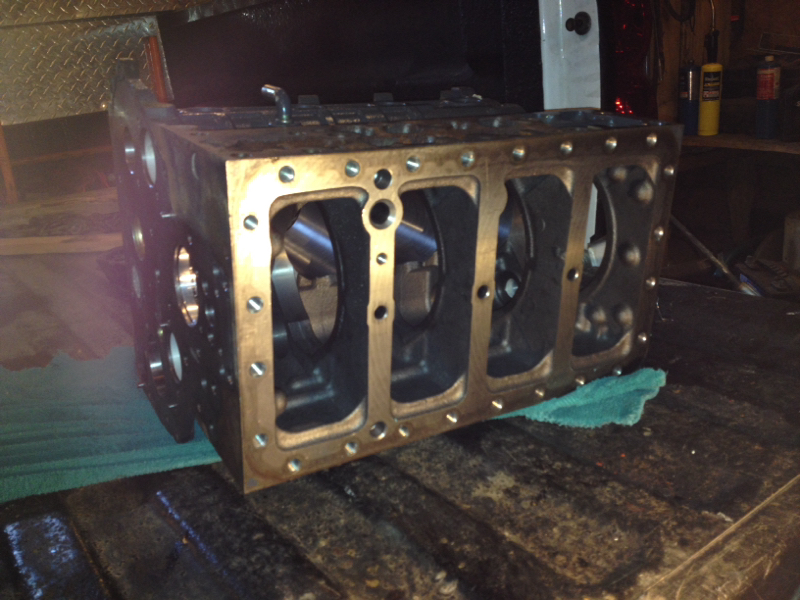

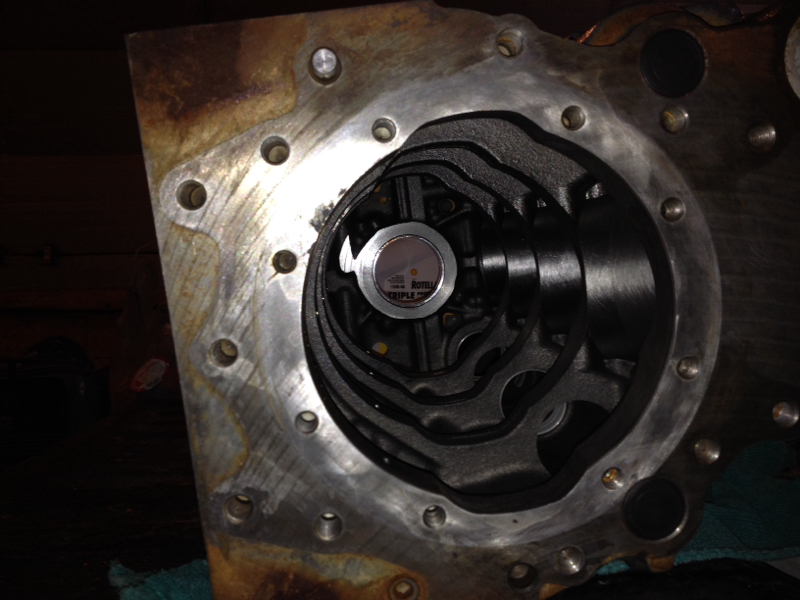

This picture is shown before we re-installed the crank. We are looking at it from the rear of the block on the flywheel end. As you can see, the only main bearing that stays with the machine is at the front of the engine. That is the one I had to replace and it is not a two piece bearing. It pressed out and back in.
The other 4 bearings all bolt into a "yoke" and then the yoke is bolted to the block with one bolt from the bottom of the engine in between each cylinder.
