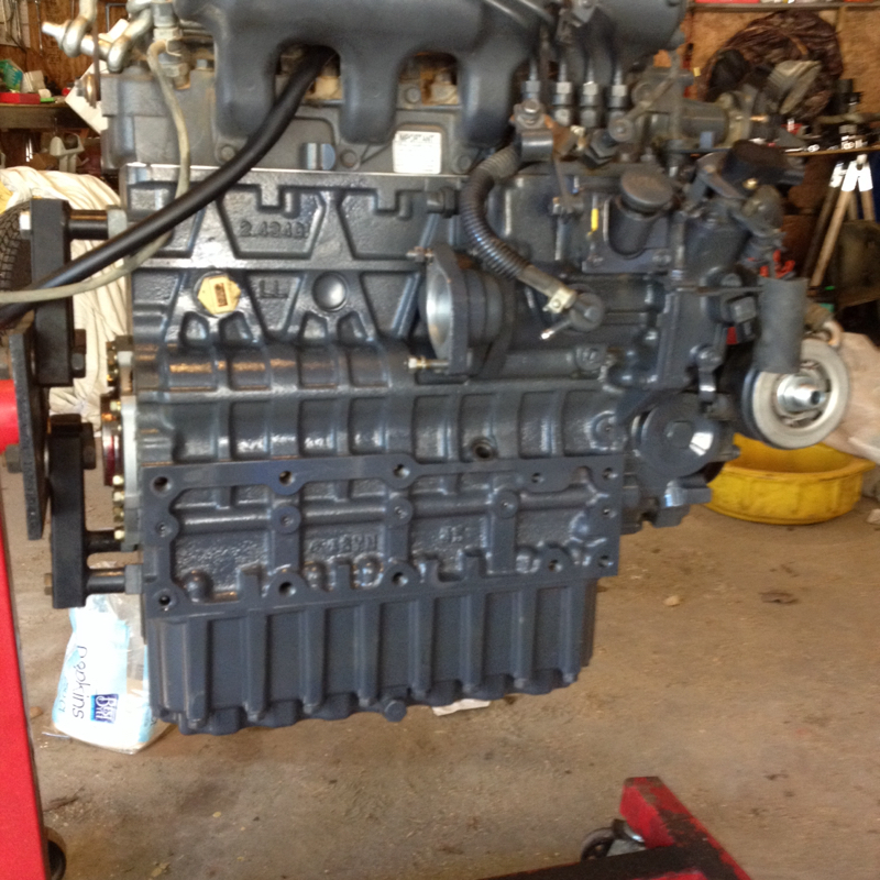

Been busy lately. Not much time to put into the repair. If you notice from some of my earlier pictures, there was some heavy rust on the outside of the block where it was sandwiched in the frame. All I can figure is that the previous owner must have used it on a road that was salted and this was a place where the snow/salt mixture flung off the front tires. On Wednesday night, I scraped all of the rust off this area and anywhere Else I could find any rust on the engine.
Let me tell you, I had to use my dremel tool to get into some of the castings. It was not fun. The $15.00 cans of spray pain I bought from Kubota could not have matched any better though. It seemed like I couldn't make overspray show up if I tried to. I only painted the areas that needed it. I used it to touch up all of the bolts also. You cannot tell it was ever opened up.

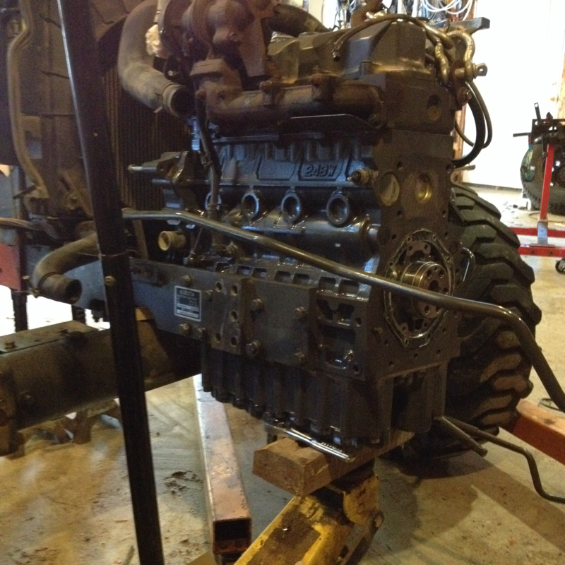

We set her back in the frame Friday night. Wasn't too hard once we got a bolt started on both sides. I will eventually hit all of the frame bolts with paint as well.

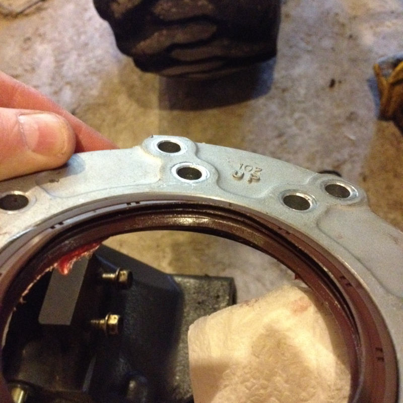

We also bolted up the clutch housing on Friday. Once that was in place, i was sitting directly in front of the end of crank contemplating installing the clutch when I noticed something wasn't quite right with the rear main seal. It looked like one of the inner "ribs" was folded back in a small section on top of the seal. I pulled it back off tonight. I'm not happy with the way it looks. I think it would probably be fine (I even fitted it back in place and the problem went away). I just can't take the chance of an oil leak. New seal and gasket will be ordered. When the new seal arrives, I think I will have it pressed in for a better fit. We used a large 3/4" socket and tapped it in before.
Good call, as I think that would of been a leaker.

Parts have been ordered. Another $50.00 including shipping. Looks like she'll still be down next weekend since the rear main seal said 5-7 days to ship.
